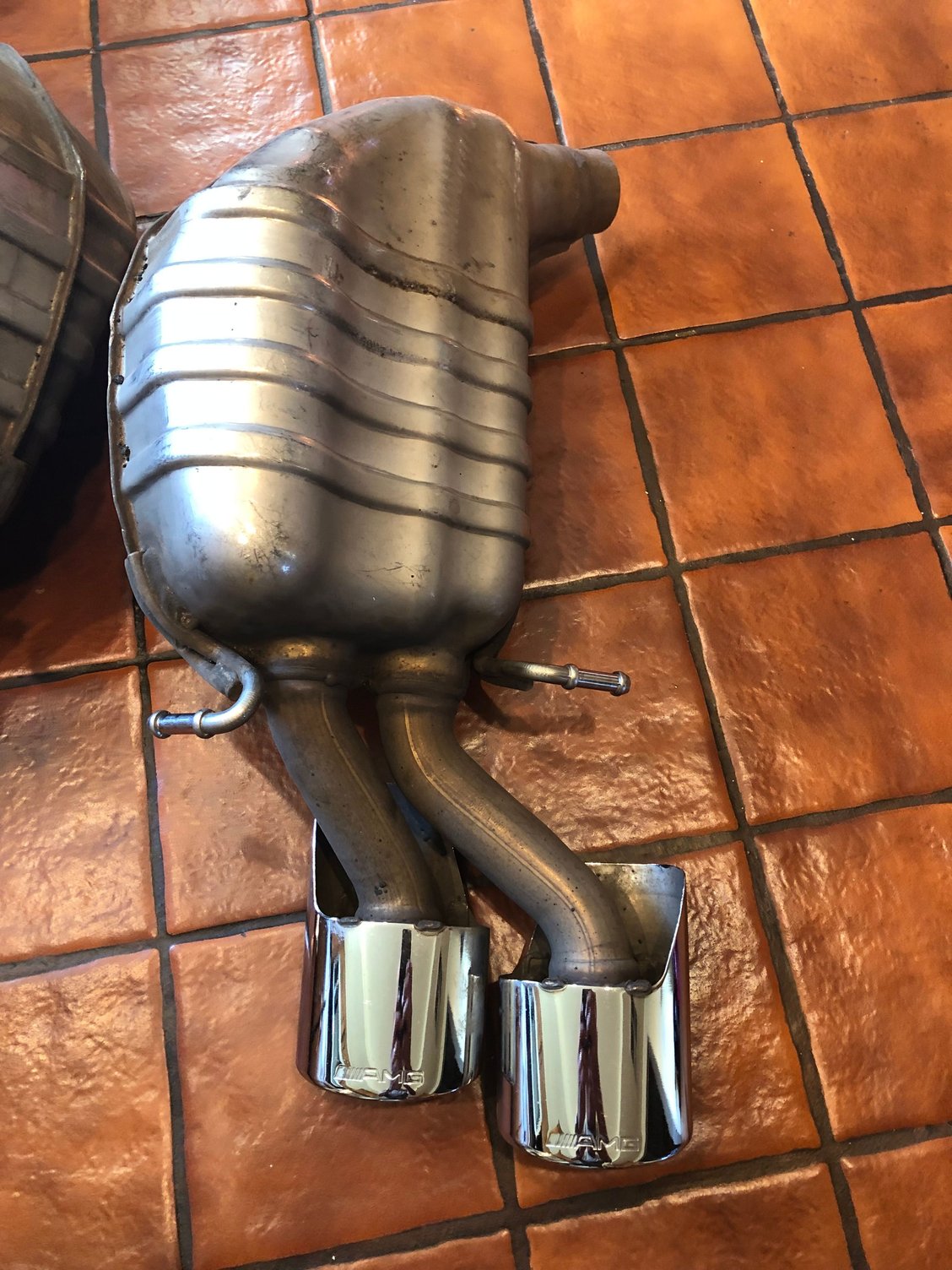

Originally Posted by mondo
Hi, i am in the process of getting C63 mufflers myself. any chance you have pics of yours before they go on the car so i can see where to get the guy to cut them off the old system?
Cheers.
Old Oct 4, 2019 | 03:27 AM
mondo's Avatar
Joined: Aug 2017
Posts: 291
Likes: 36
From: Australia
Alfa Romeo Giulia Veloce
excellent, thanks for that
these are the ones i am getting. came off a wreck. the tips have been painted black, so i will need to revive the chrome, but otherwise they're in good condition.
You gonna love them! Especially if you have LTH.

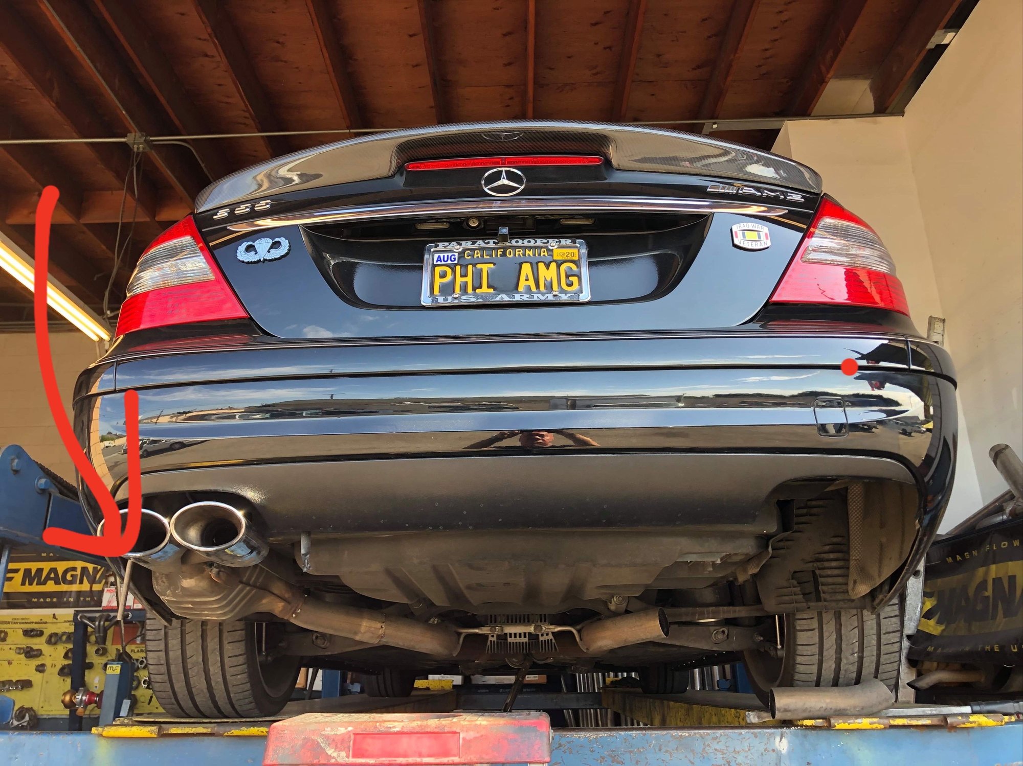

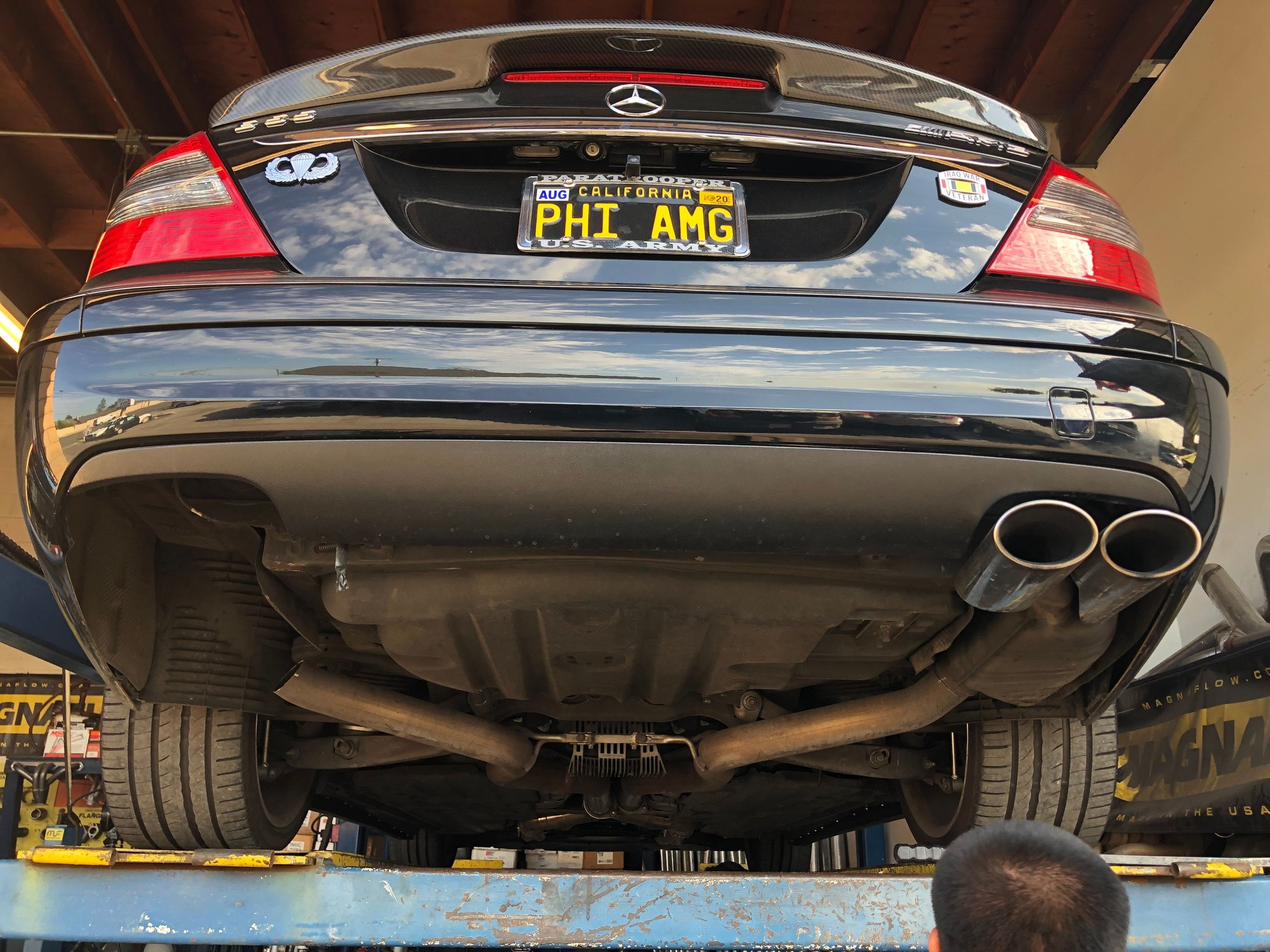

Old Oct 16, 2019 | 11:44 AM
MSG 55G's Avatar
Veteran: Army
Joined: Oct 2018
Posts: 699
Likes: 75
From: OC, CA
2006 E55
Originally Posted by greekstylist
I would very much appreciate that. I have another appointment on friday morning.
sorry, haven’t been feeling well lately but I did find this photo of install. Red arrow points out the new hanger is placed and excess get cut after final alignment. Hope this help
