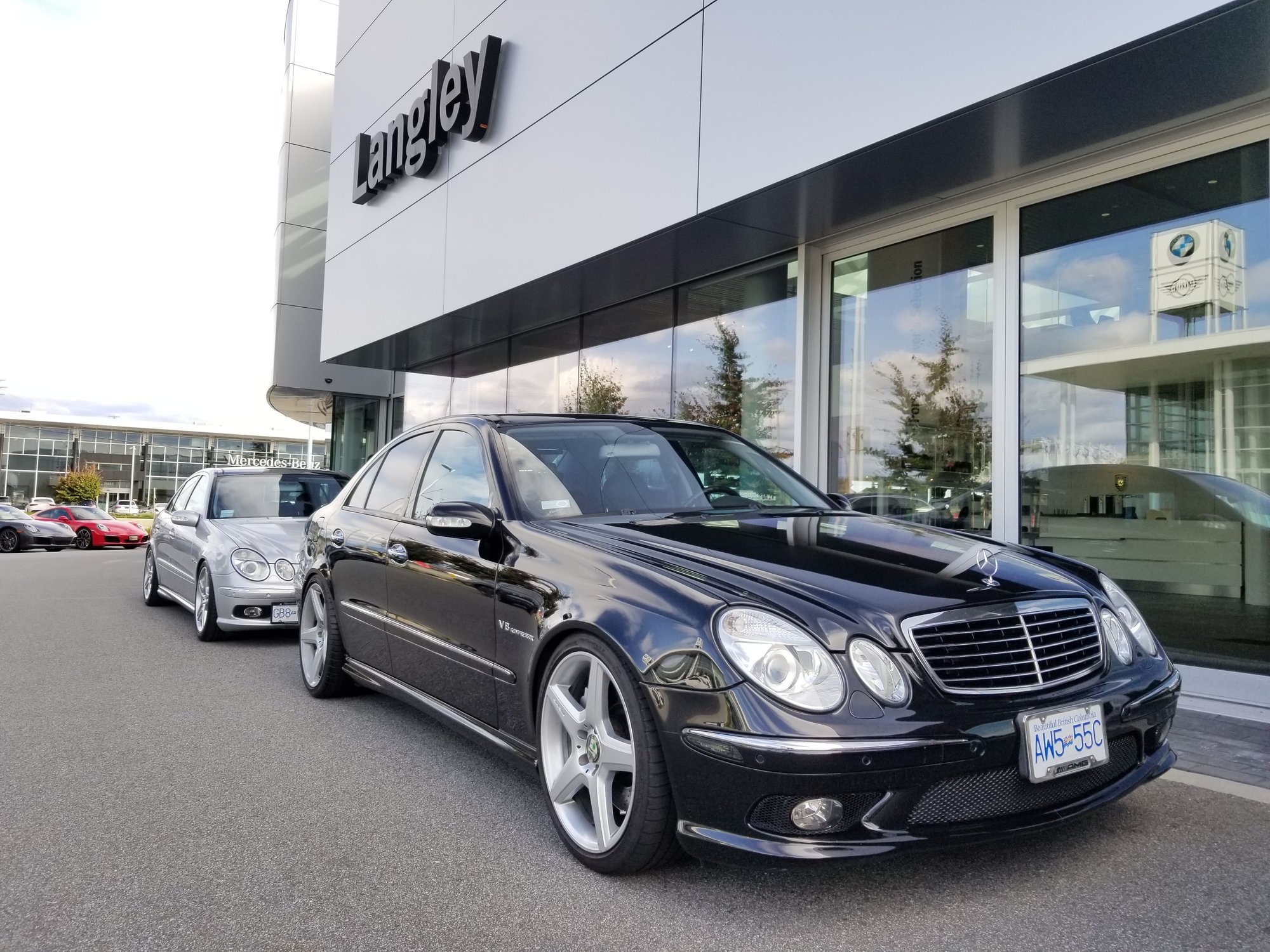

You shouldn't need spacers with the CLS550 or SL wheels, the 30 and 33 offset make them sit pretty flush. The CLS55 wheels are 28 and 28, I rub even on 275s. Pretty sure AMGMeister doesn't run any spacers, his car is behind mine in the picture
