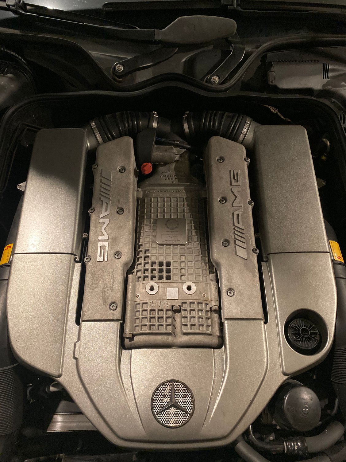

Here’s the story:
So my 2005 E55 160k miles has been basically sitting on and off for the better part of a 2-3 years. I was moving around the country, and didn’t take my E55 with me. Every couple months when I would make my way back home, I would tinker with the car while in storage. Start it up, sometimes the battery would need to be jumped, but the car always fired up. And ran smooth, as it always has.
so within this last year, I finally was able to trailer the car down to where I was living. Then decided to start dumping money into the vehicle. I’ve owned it since March of 2013 and at this point I can’t part ways with it. Sometime back in 2015, I recall the car misfiring under acceleration. I discovered that the purge valve vacuum hose would sometimes blow off. Fixed that issue.
fast forward to 2019, fire up the car up on a cold start - it runs smooth can rev it high. Put it in drive and i can even get a good pull or two, and then the car starts to sputter and then CEL pops on and begins to flash repeatedly. (Much like it was doing in 2015, but this time no hoses seem to blowing off under load) So I take it back home, run the codes, I was getting cylinder 2 & 4 misfire. Logically first thing we checked was the ignition system, tested ohms on all spark plug wires (on both sides even), plugs (stock ngk) have around 100 miles on them but definitely a lot of plenty of idle hours on them they’re a little dirty but I think they’re good, Swapped coil packs to the other side and the mis didn’t move so those are good. Even tested the compression, all within spec 150-160psi. There’s only so much I can test with ignition and it all checks out.

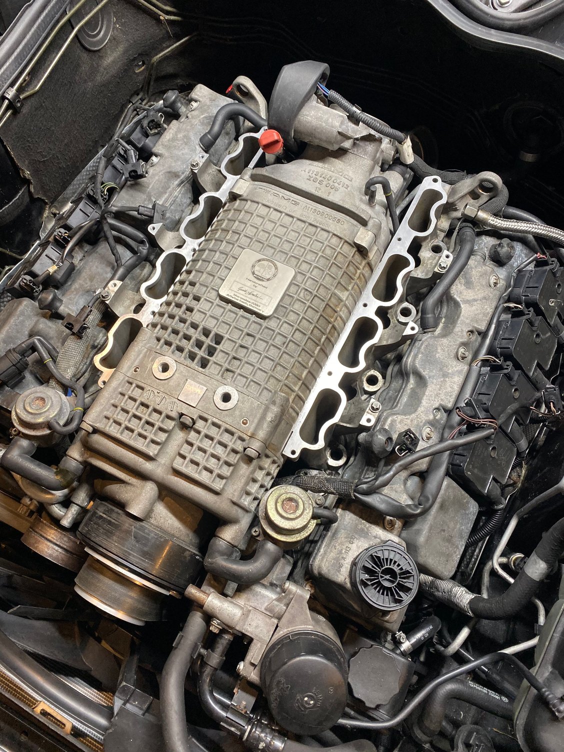

For our next diagnostic, and this is where it gets interesting, we fired up the car and on bank 4 and 2 where the Supercharger sits on the block, directly next to the valve covers, sprayed it with brake clean and it smoothed out! Naturally, we got excited about this, thinking we might have discovered something. So we cleared the CEL and I started the car while my friend spray that exact spot with brake clean again. The car ran smooth the entire time while he was spraying, as soon as i stopped the engine began to sputter and within a few seconds the dread flashing CEL came back on.
By this time we are convinced he have a vacuum leak. We’d like to smoke test it to confirm our “educated” theory, but our autozone and oreilys didn’t have one. But I was convinced we had an vacuum leak, why else would the engine smooth out and run without any misfires while we sprayed the break clean on the cylinder that is giving us a code? It made sense that there was probably a gasket leak where the supercharger sits on the block.

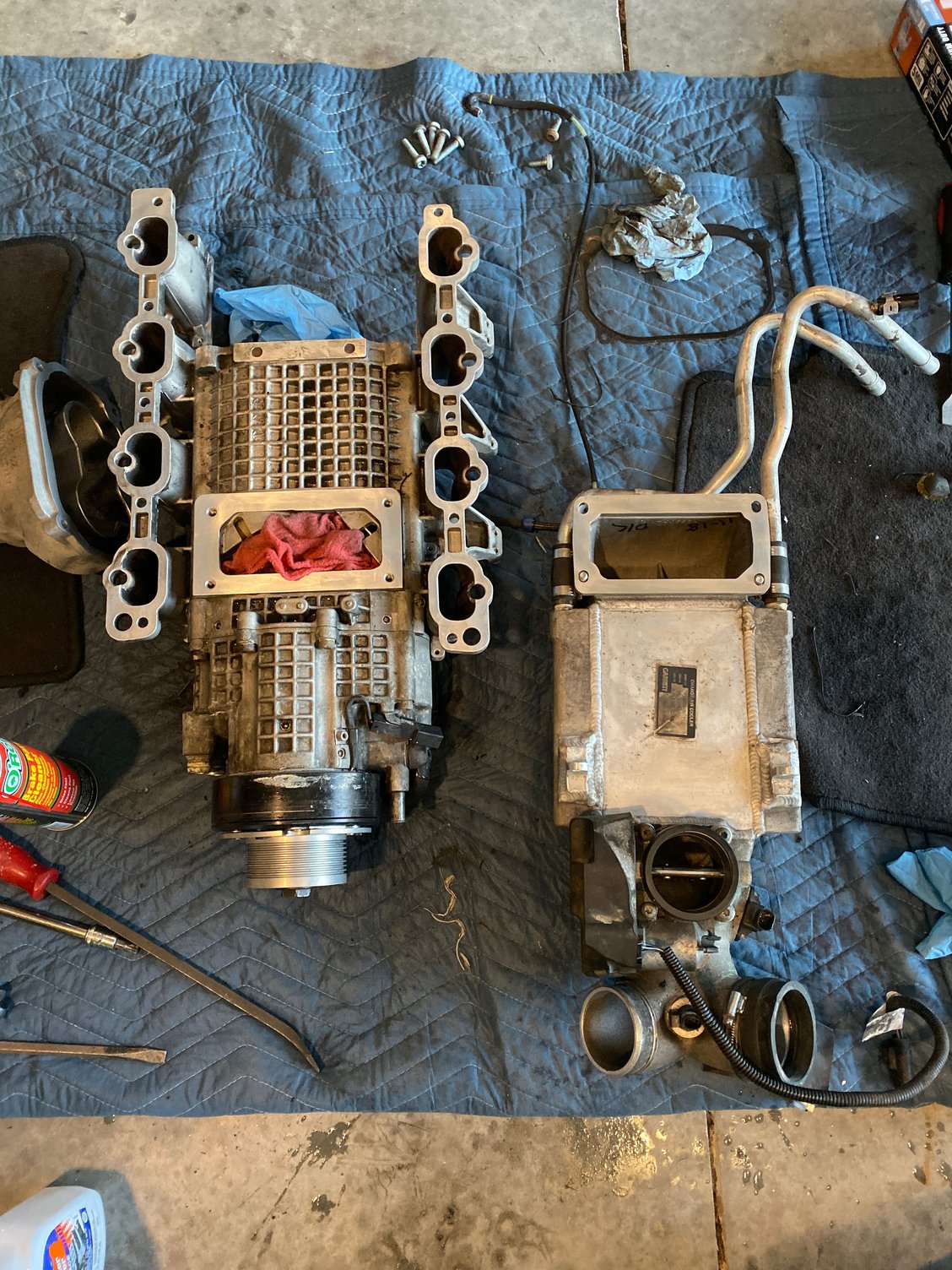

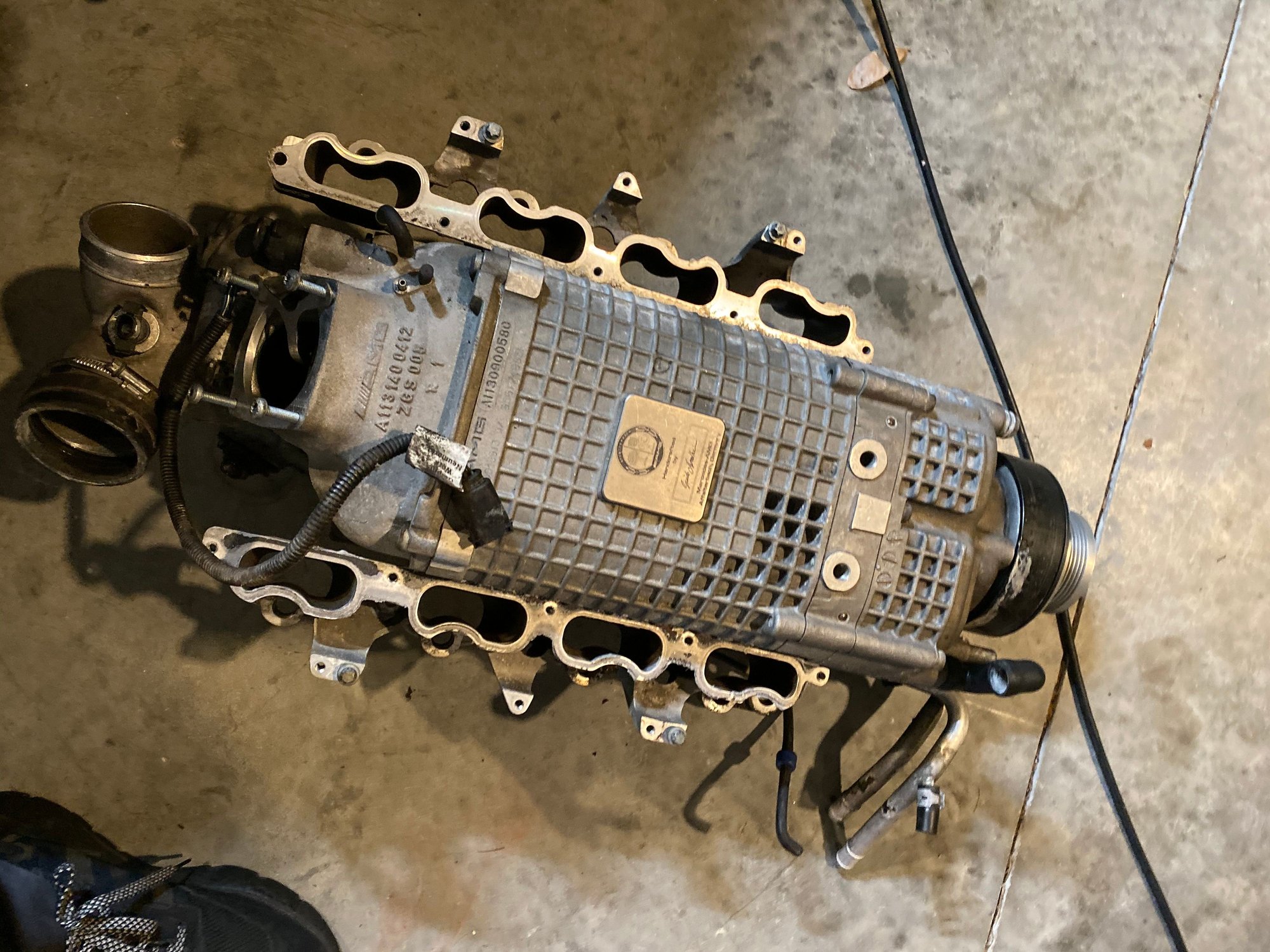

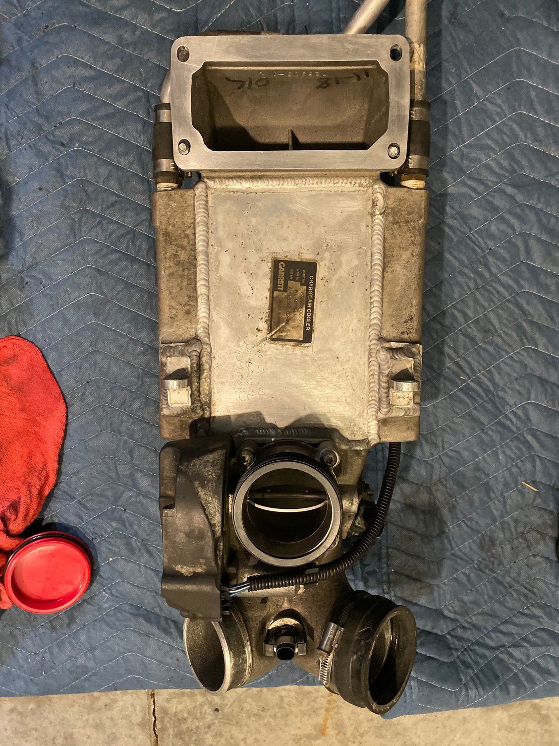

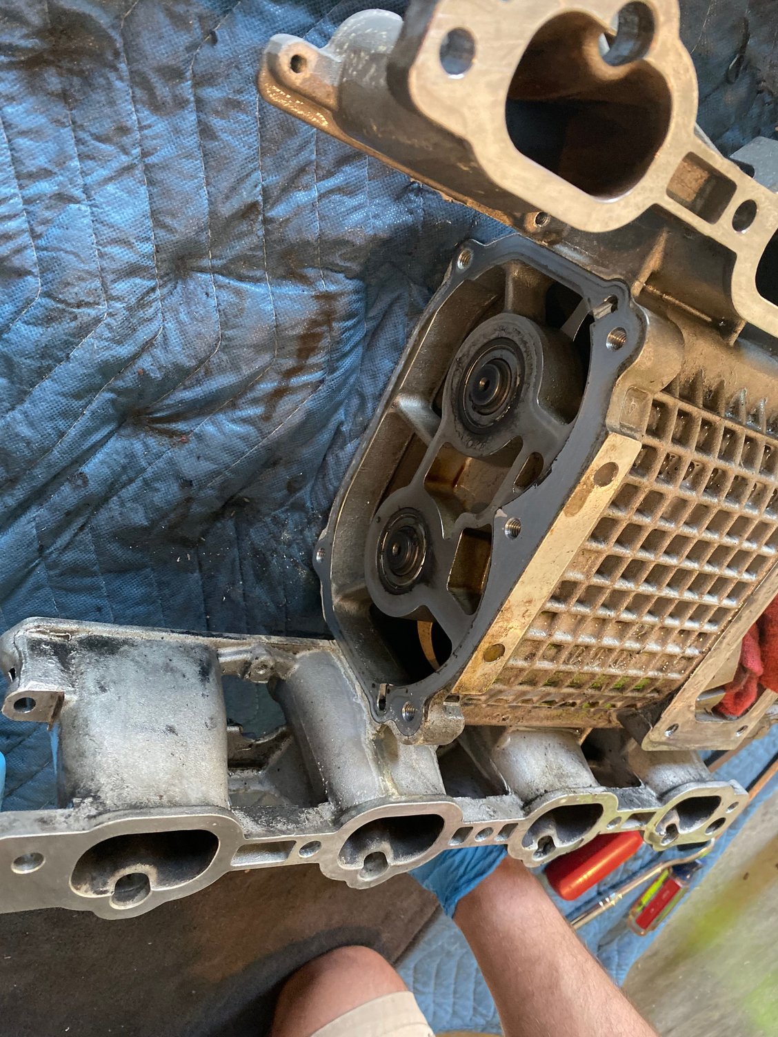

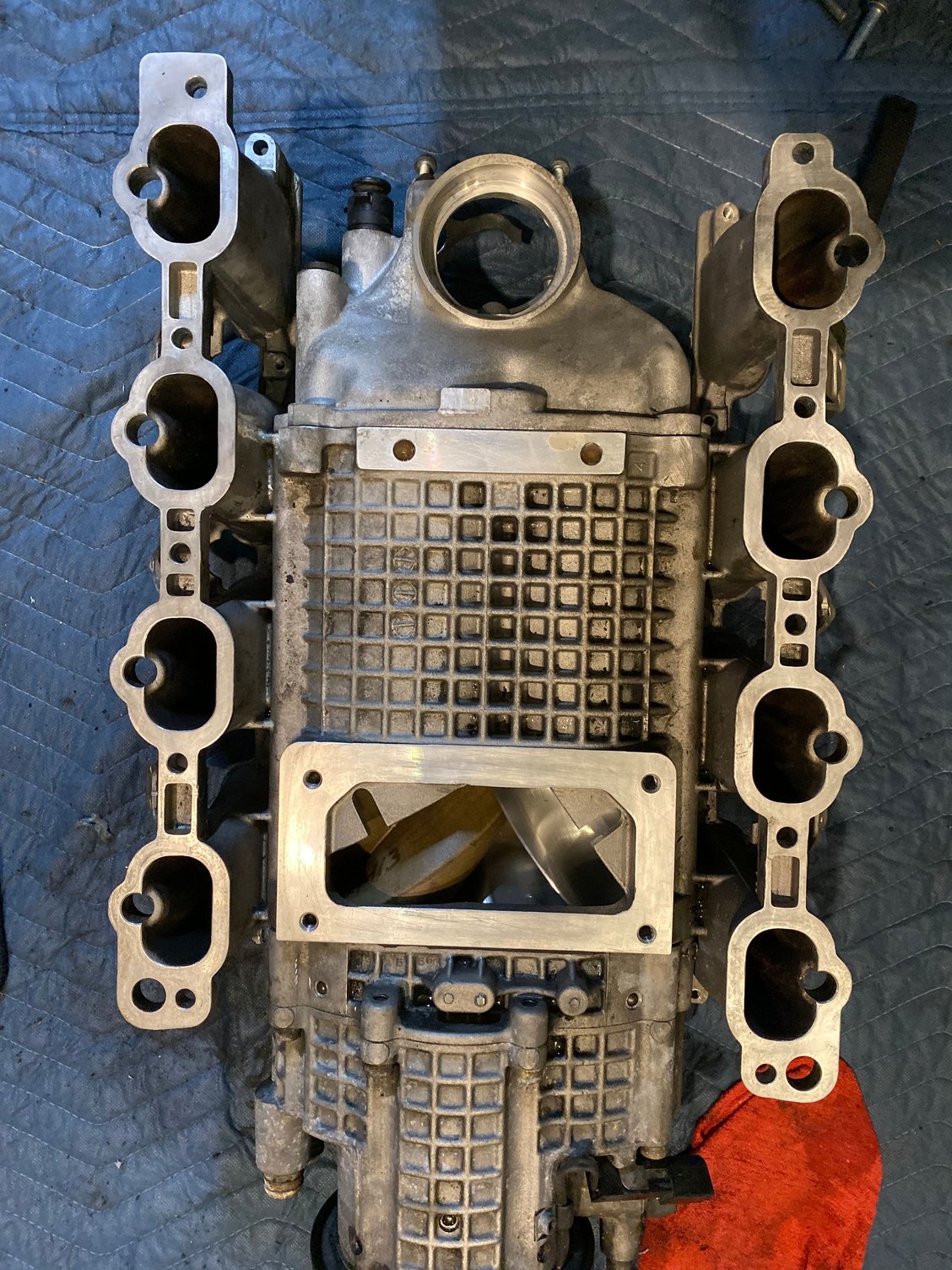

So we ordered gaskets for the blower on FCP. Both gaskets where the supercharger meets block, the gaskets where the surge tanks sit on the blower, the rear gaskets for blower, and there was cylindrical gaskets for where the intercooler connects to the blower itself.
oh, yeah, just for good measure due to the age and mileage. We sent off all 8 injectors to be cleaned. Turns out two of them where dumping fuel, being stuck open. The company we sent the injectors to were able to clean all the injectors back to factory spec and replaced all the o-rings.

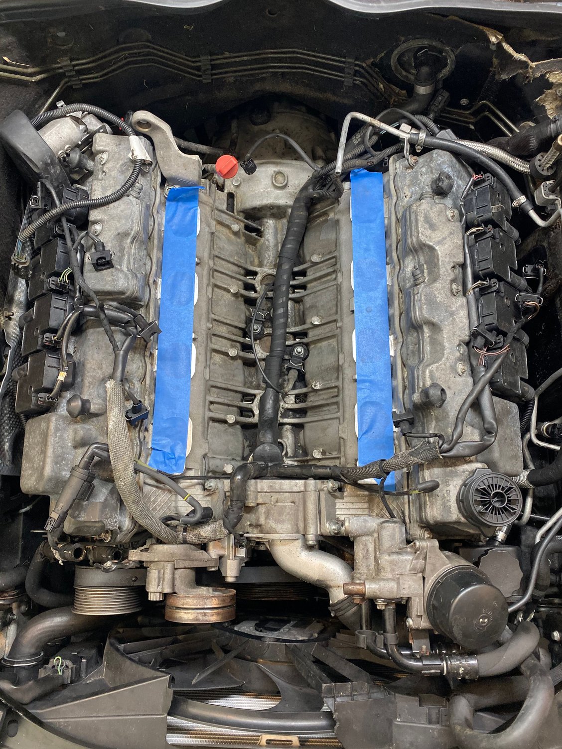

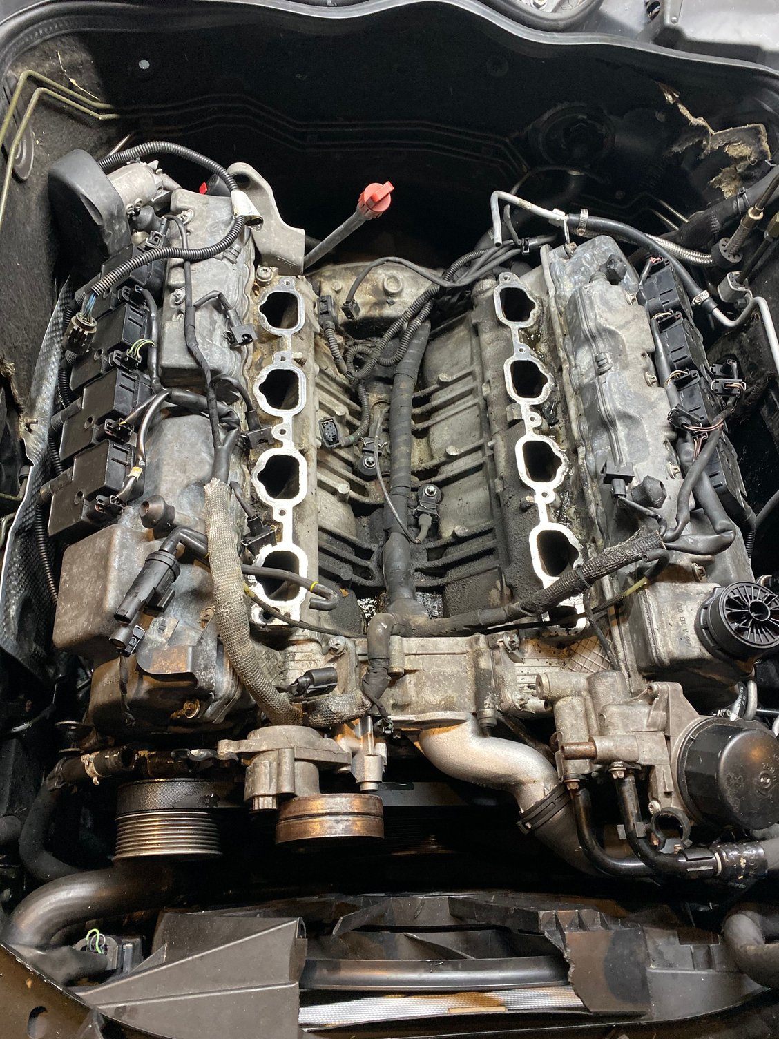

Fast forward to yesterday, after nearly a week of waiting for parts and injectors. We had everything to reinstall install the blower. Very hopeful all this time energy and money wasn’t a complete waste.
we put everything back on the vehicle as it should be, obviously cleaned all the mating surfaces between the blower and the block. Triple checked that everything was in place where it needed to be, and it was. We were ready for the first start up. It was running great, let it run for maybe 5-7 minutes to heat up. Revved it a few times. All things that, before doing this job, would have triggered a misfire but not this time. Spirits were high, we just needed to take it for a test drive.

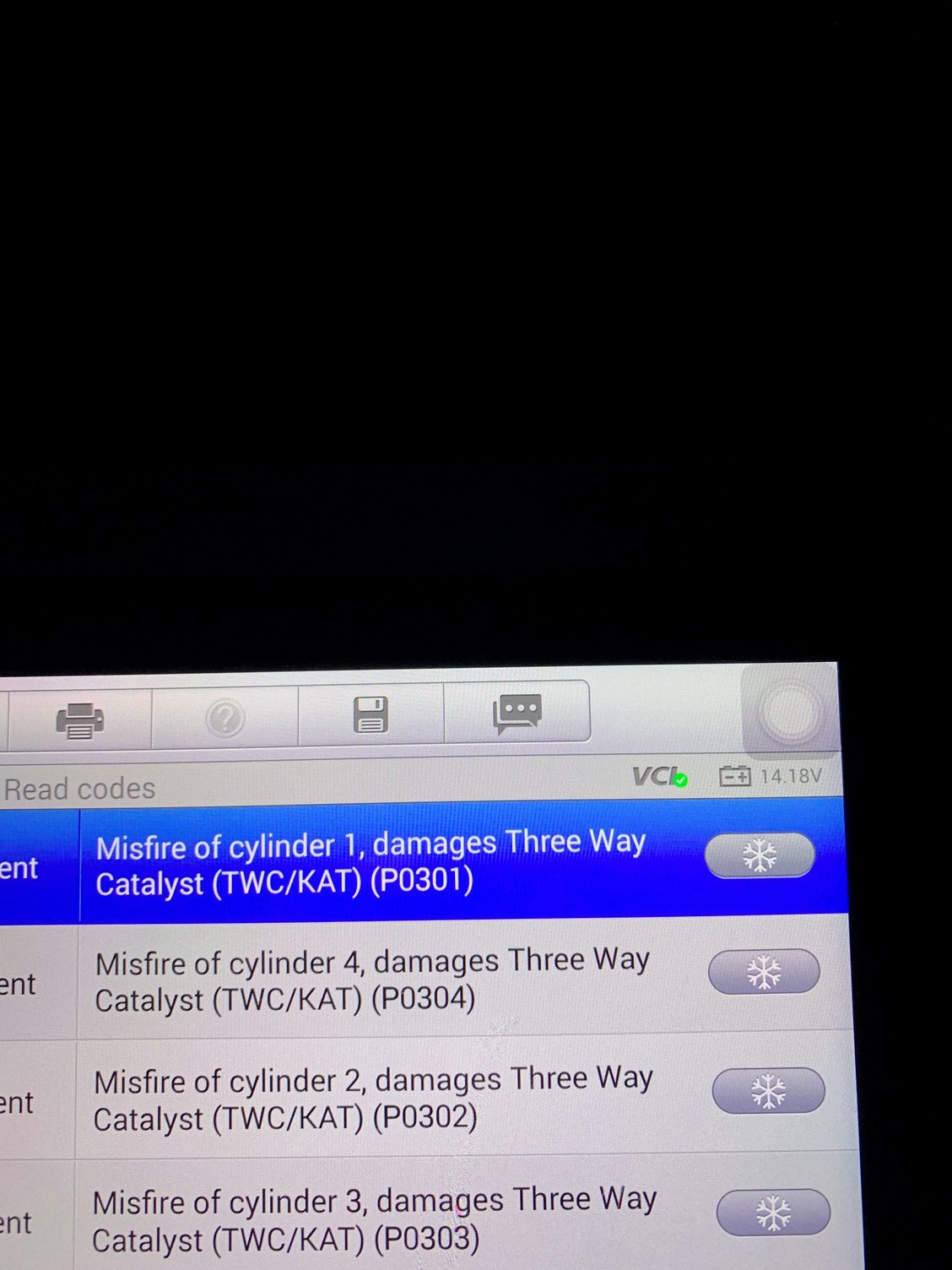

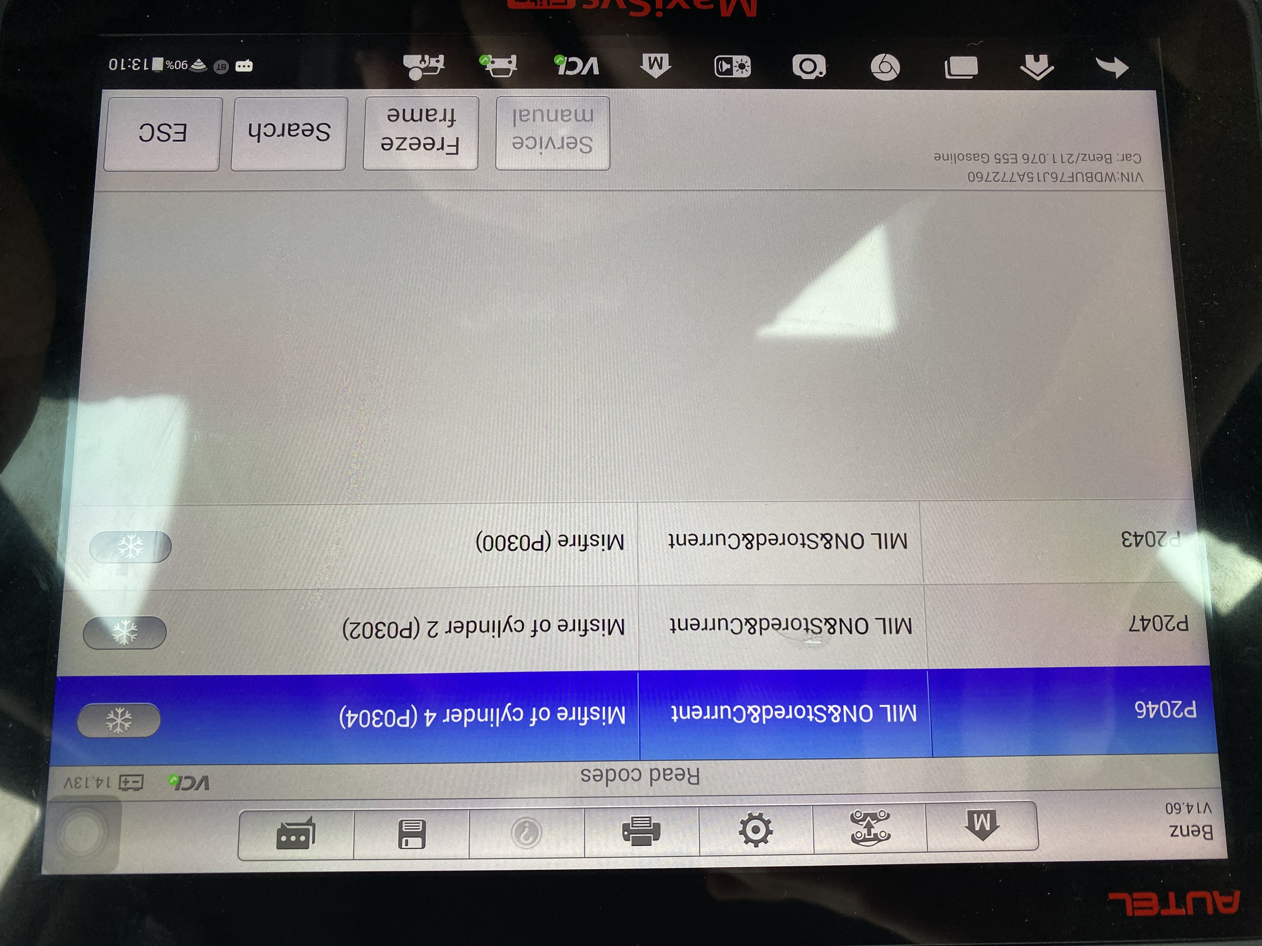

we ran the codes again, and now the ENTIRE passenger side bank is giving misfire codes. Cylinders 1,2,3,4
So we tested for a blown head gasket via coolant, and it passed that test. again, we’re confident it’s not my ignition components. So maybe vacuum leak? I’m not sure, we’re kind of at a loss and feeling defeated.

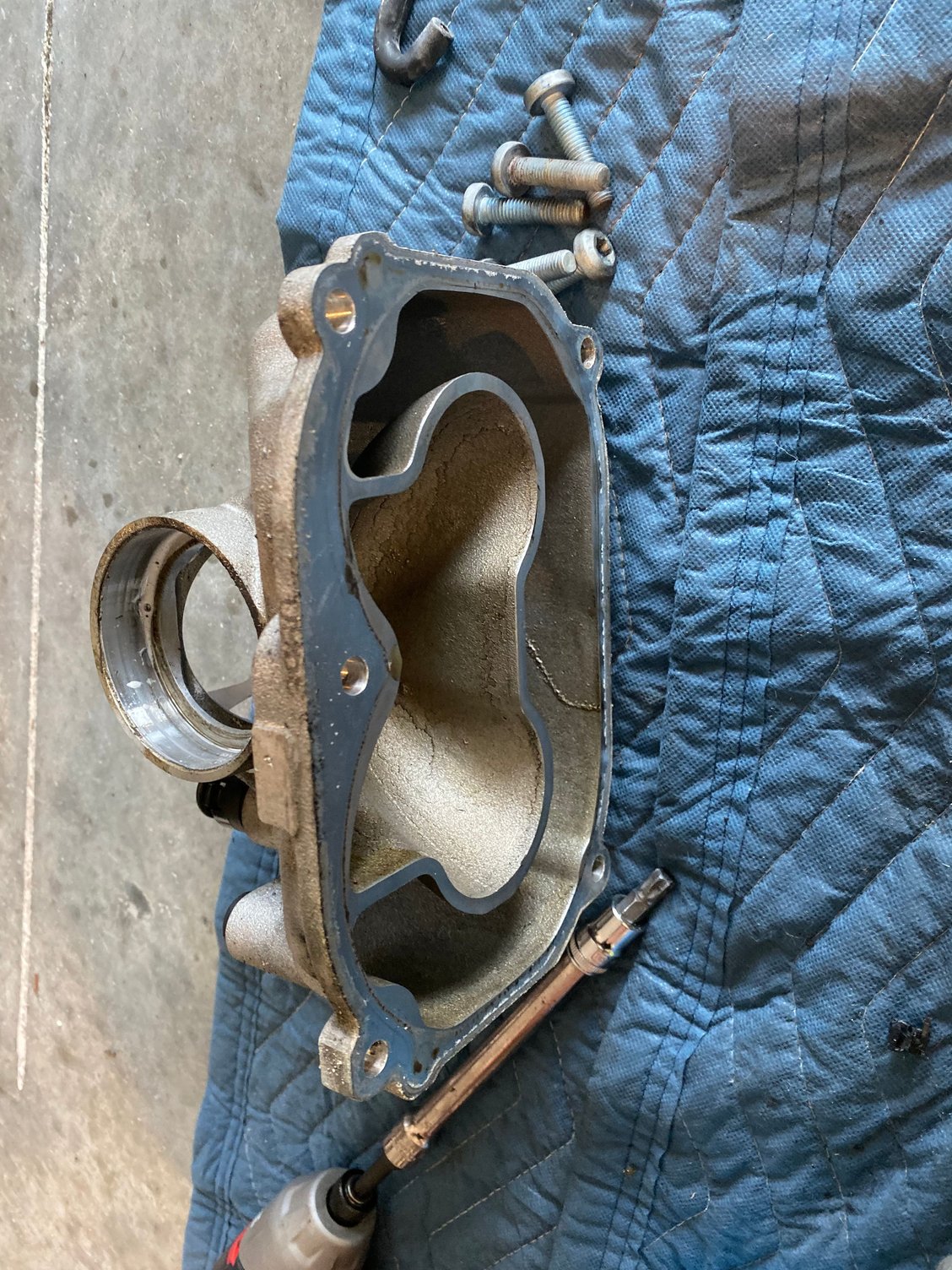

here are a few photos of our job and the codes and o2 sensor reading (somebody with more knowledge than us said those o2 sensors readings are too perfect, so idk what to make of that)
Ignore the broken radiator fan shroud

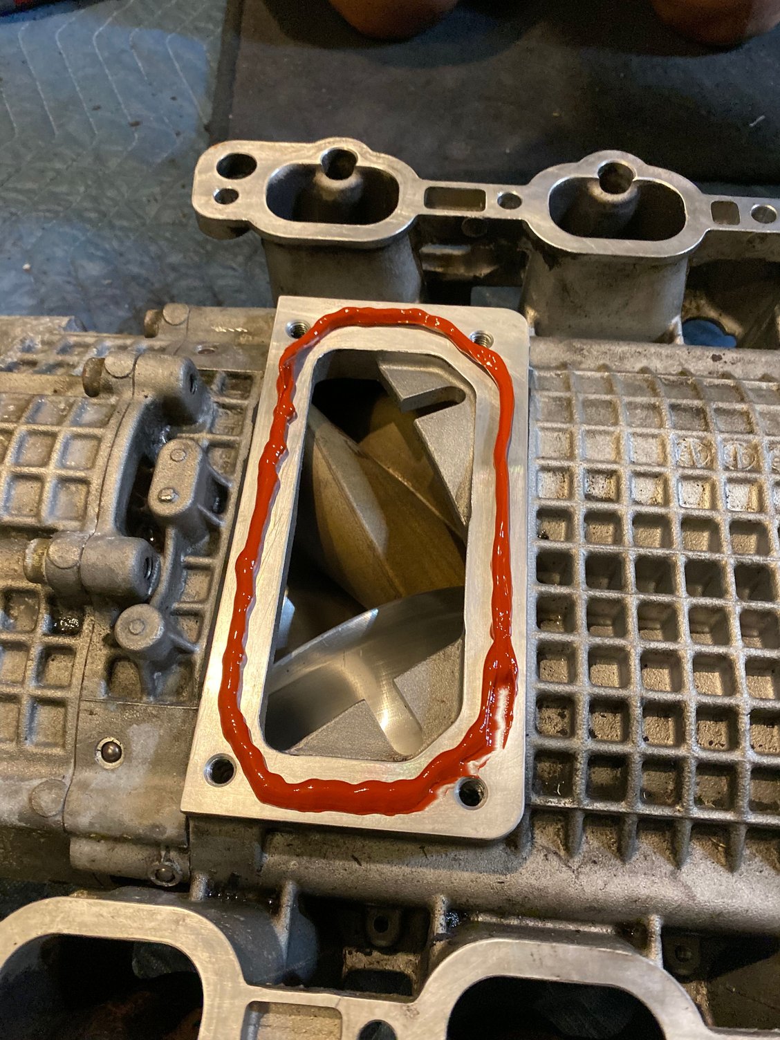

Believe it or not, RTV gasket maker is the correct way to do this. I didn’t believe it at first.
Everything back on, just waiting for injectors
Codes after all the work and test drive
Lower two reading are the o2 readings, for whatever that’s worth

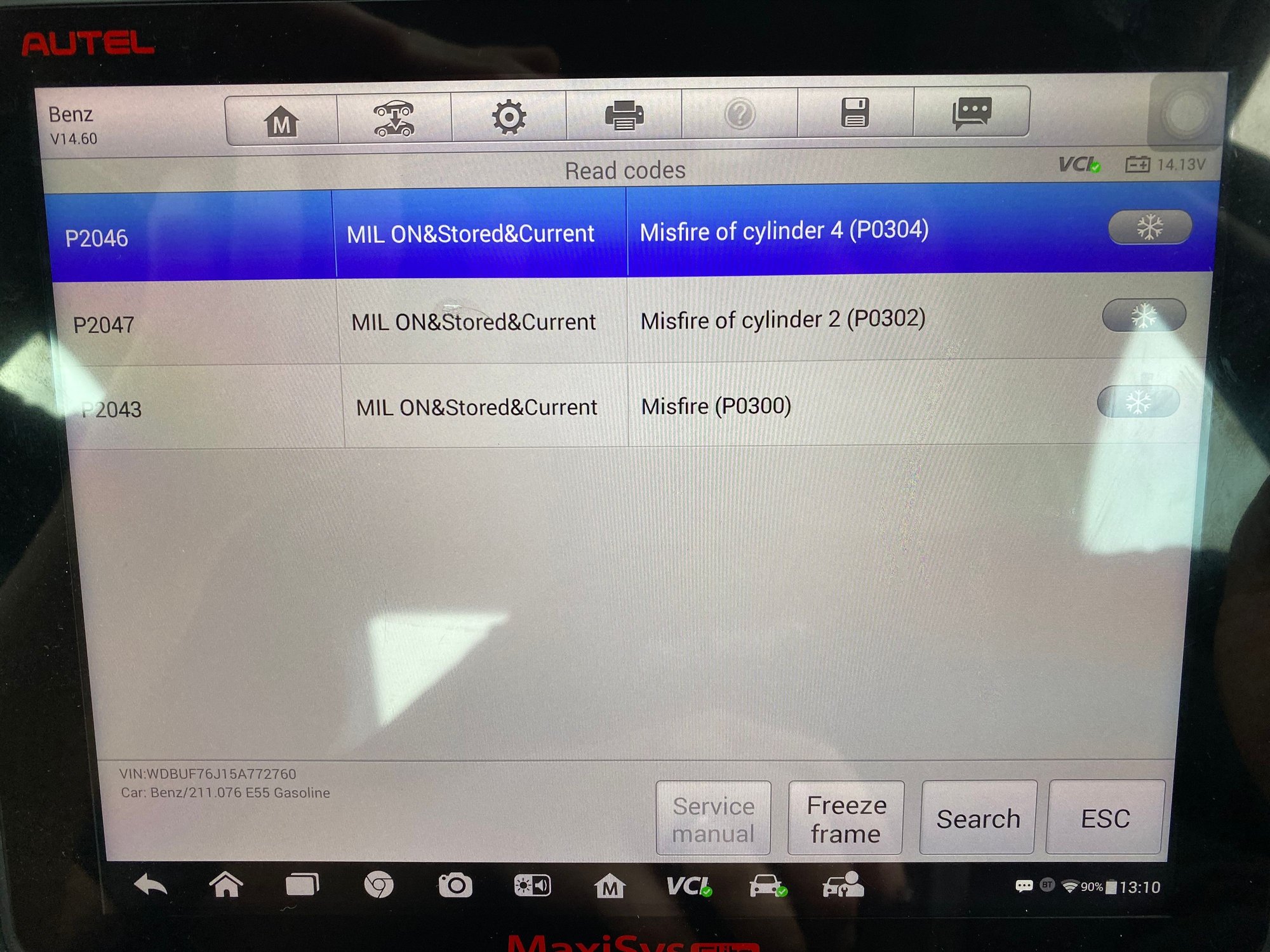

UPDATE:
Cleaned the plugs with a Pneumatic spark plug cleaner, they plugs have only 100 miles and the electrodes were fine and resistance was within spec - they were just dirty. Torqued them down to spec, made sure the wires were on the spark plugs and coil packs correctly. When I took out bank 4 spark plugs, I could smell fuel. We ran the smoke test again, and absolutely NO vacuum leaks anymore. took it for a test drive, nothing has changed. Still get the occasional flashing CEL. What’s weird is sometimes the engine is smooth for 10-20seconds , and then it starts to misfire again. Like I said, we checked compression and that was all within spec.
So, no air leaks, ignition components are fine, fuel pressure is within spec.
Reset the CEL, checked for codes again and still getting cylinder 2 & 4 misfire.
Any ideas? At this point we are thinking we need to do a leak-down test.
What about o2 sensors? Like I said, I have eurocharged tune and cat-delete so I doubt o2’s would make a difference.
The only other thing I’m doing right now (which I should have done overnight) is leaving the battery unplugged trying to reset the ECU. I read somewhere in this forum that when we plug the brake booster port and getting codes to unplug the battery. I’m doubtful, but I’m giving it shot.

unplugged the upstream o2 sensors, the one of the right we suspected might have been bad which was the bank I was getting all those misfires on. And the misfires went away! Took it on a 30 min test drive and it ran smooth the entire time. Obviously CEL is on for upstream o2 sensors not being plugged in and it’s running rich. But the car runs! Bad o2 sensor of all things. smh, what a run around.
