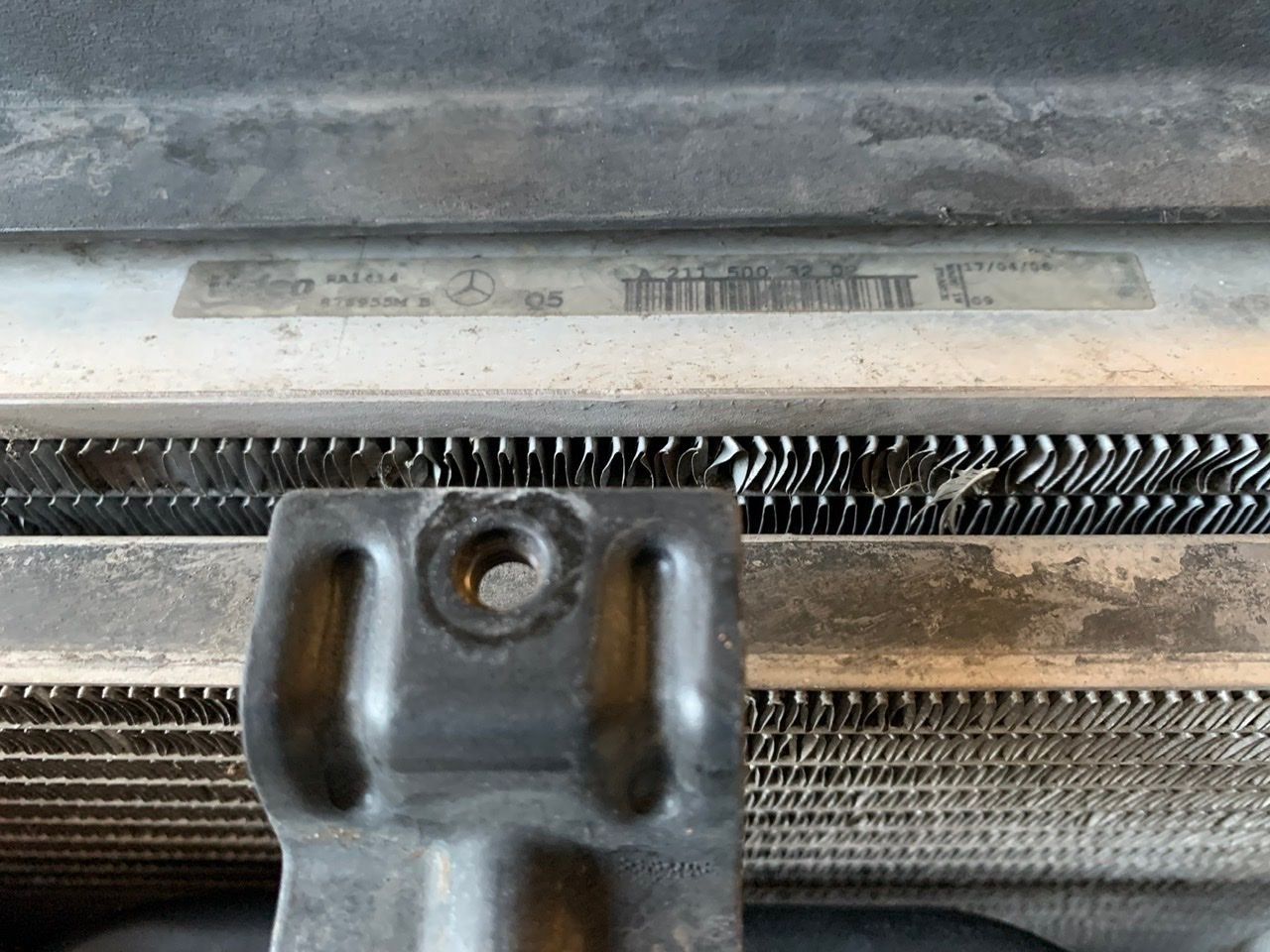

Is this the original radiator?
I need assistance verifying if this radiator is the original Valeo radiator on my 03 E55.
I’m hoping that it isn’t. I see numbers on the far right look like it could be the build date (17/04/06). Does anyone know if that’s the case? Thanks!

Any particular reason you need to know? Usually radiators are only a consideration if it's clogged or leaking, at which point you're replacing it anyway.

03 E55s have faulty rads that dump coolant through the trans heat exchanger.

Looks updated based on the part number, see this thread:
https://mbworld.org/forums/e-class-w...rt-numner.html

If I owned an E55, I would jettison the Valeo radiator regardless and replace it with the Behr.
It's the one and only disadvantage of the CLS55 --- we only can use the Valeo because of the changes to the transmission lines.

AFAIK, The updated Valeo radiators don't cause any issues. I would like to eventually change it out to a Behr but now that I know it's an updated Valeo, I don't need to rush. Thanks guys!
