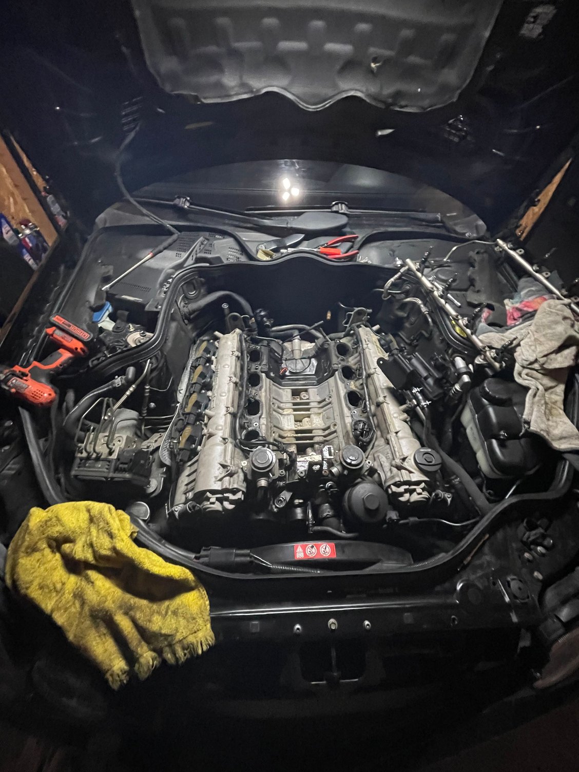

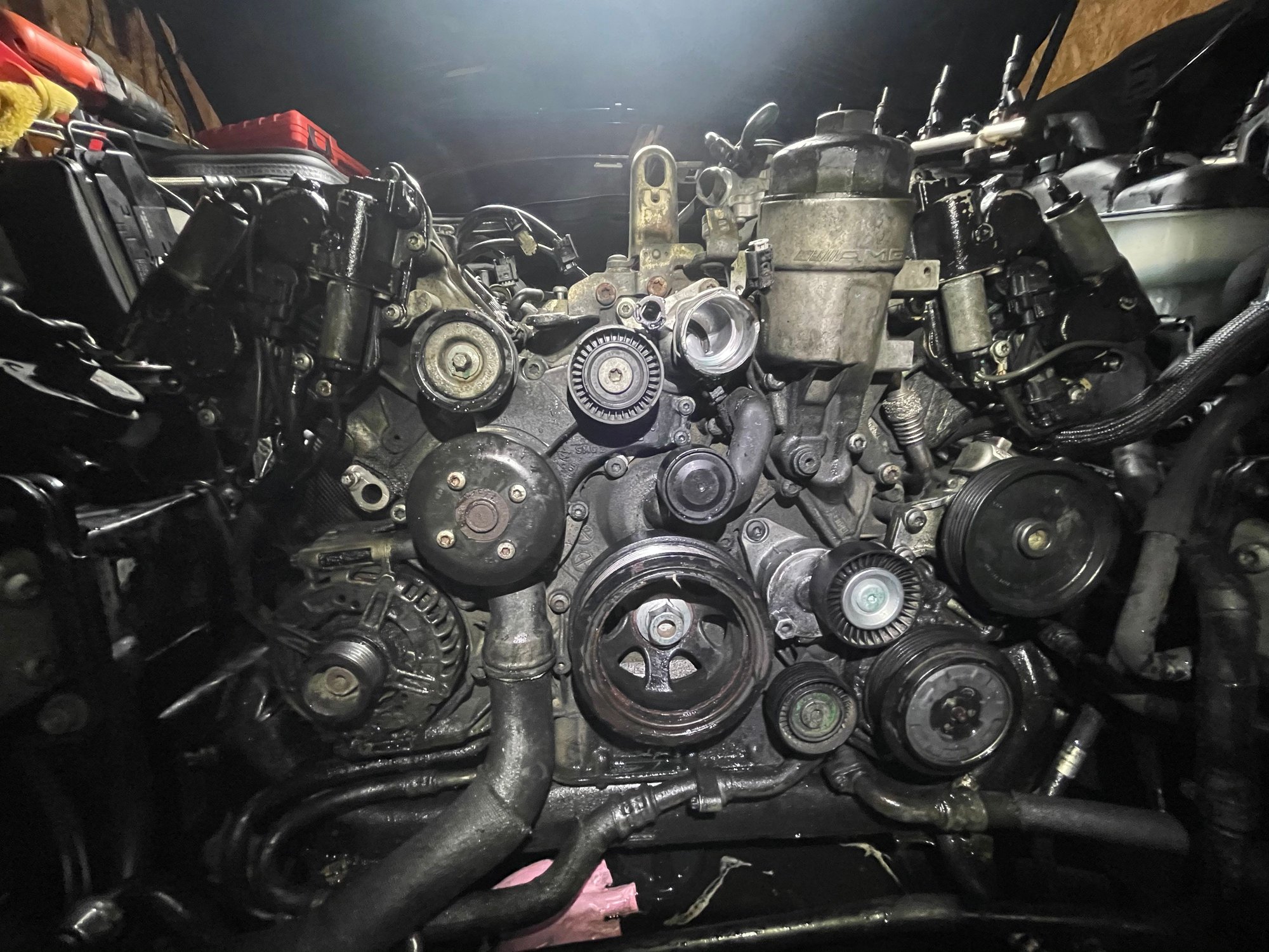

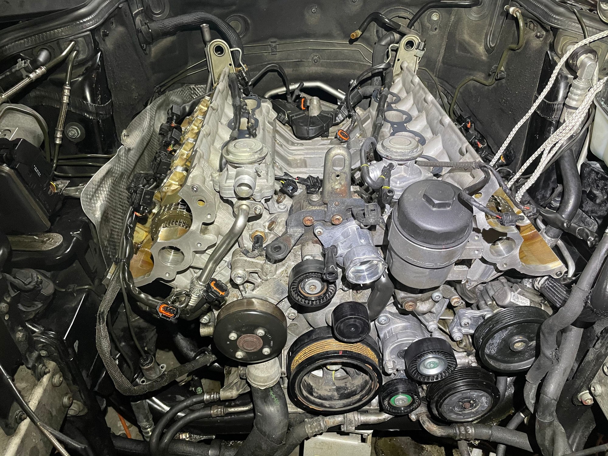

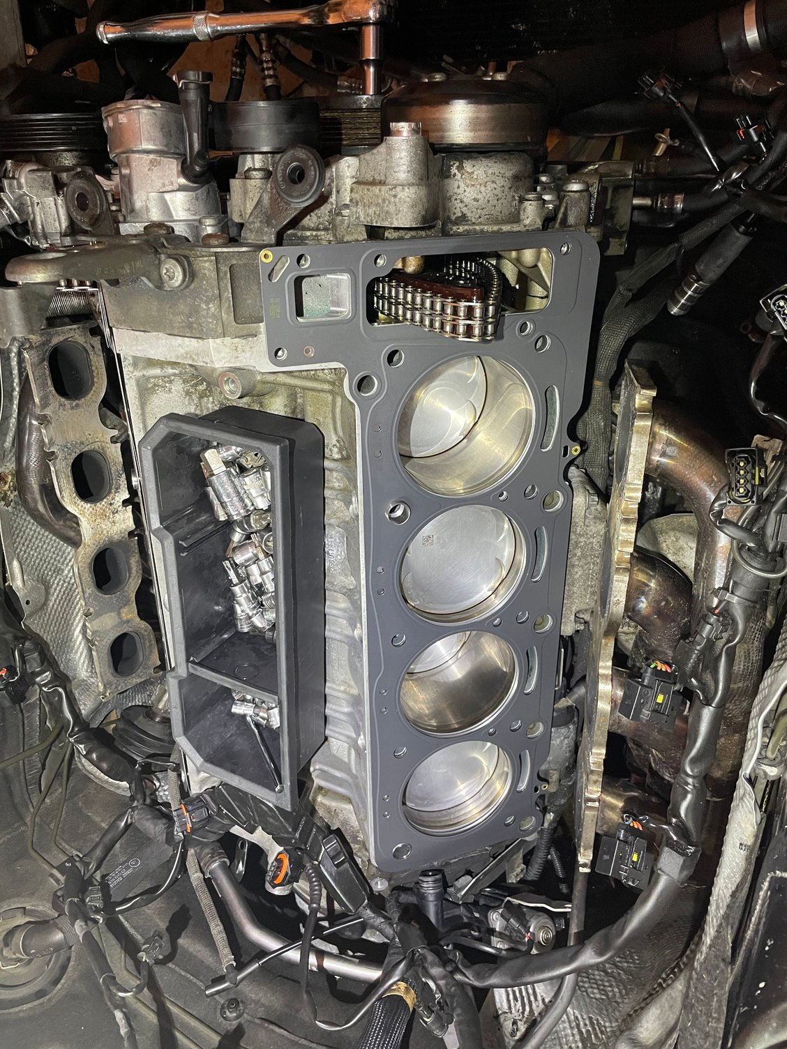

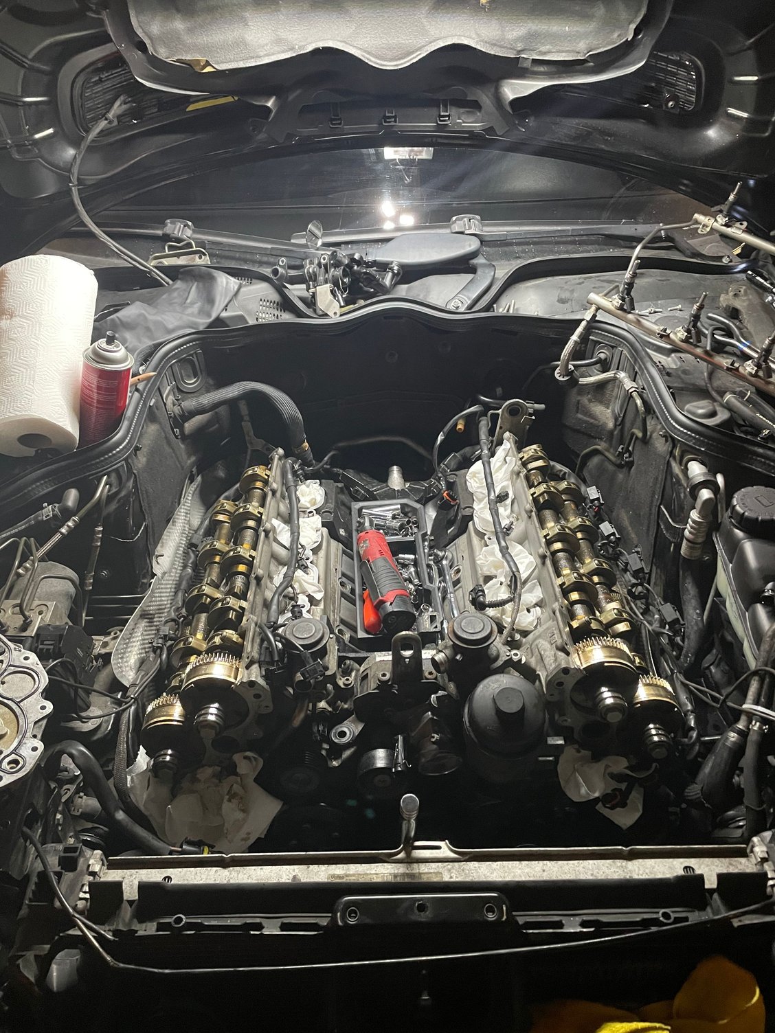

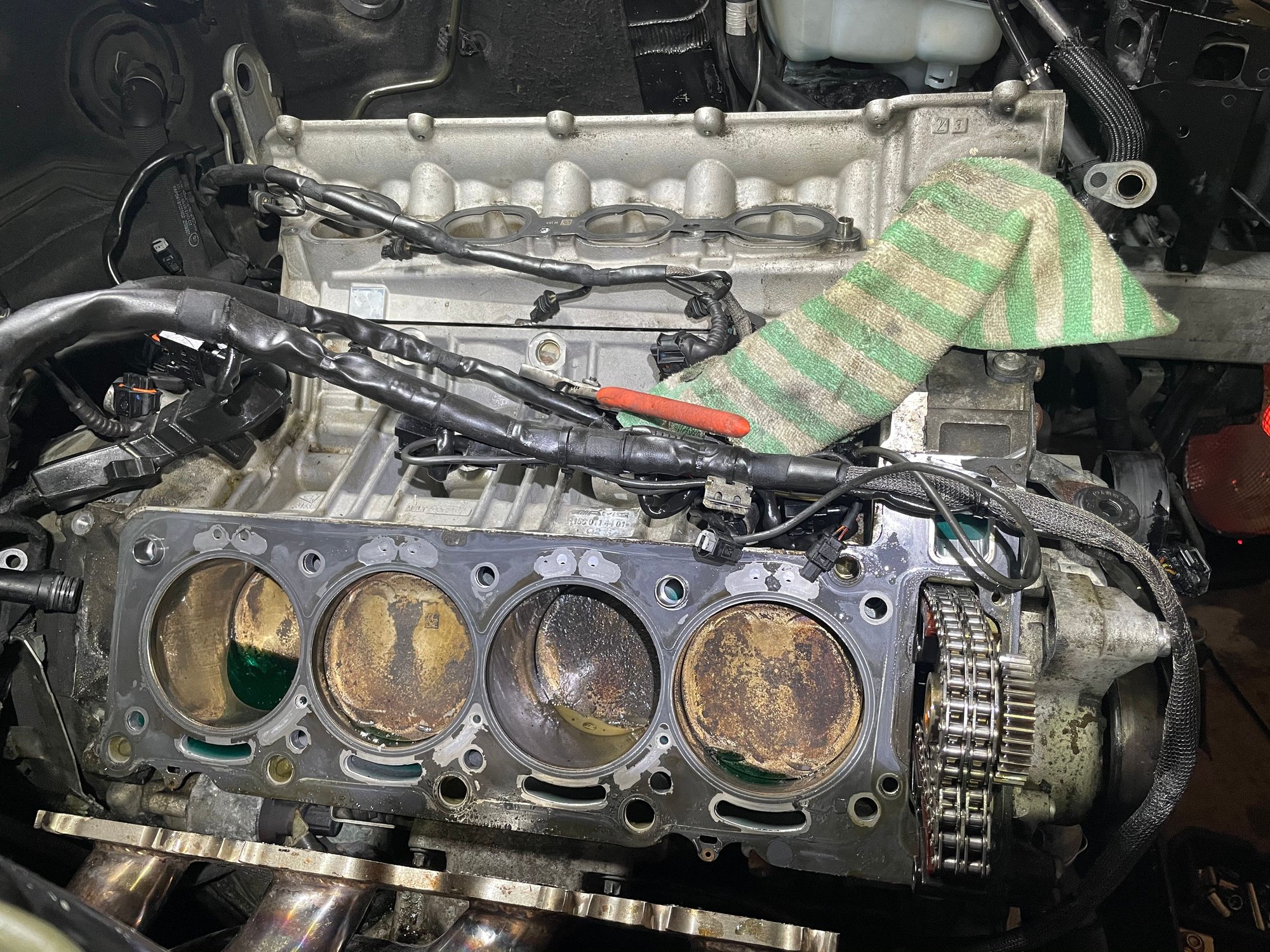

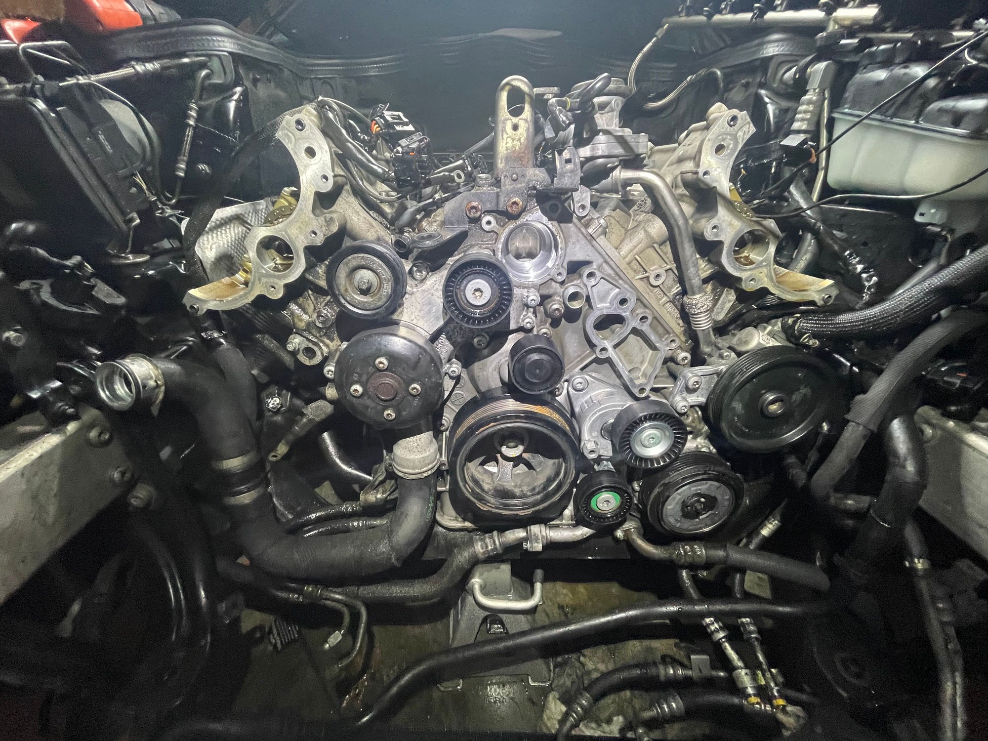

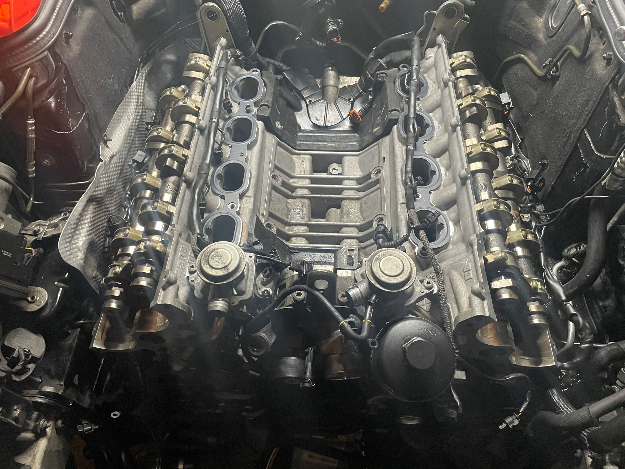

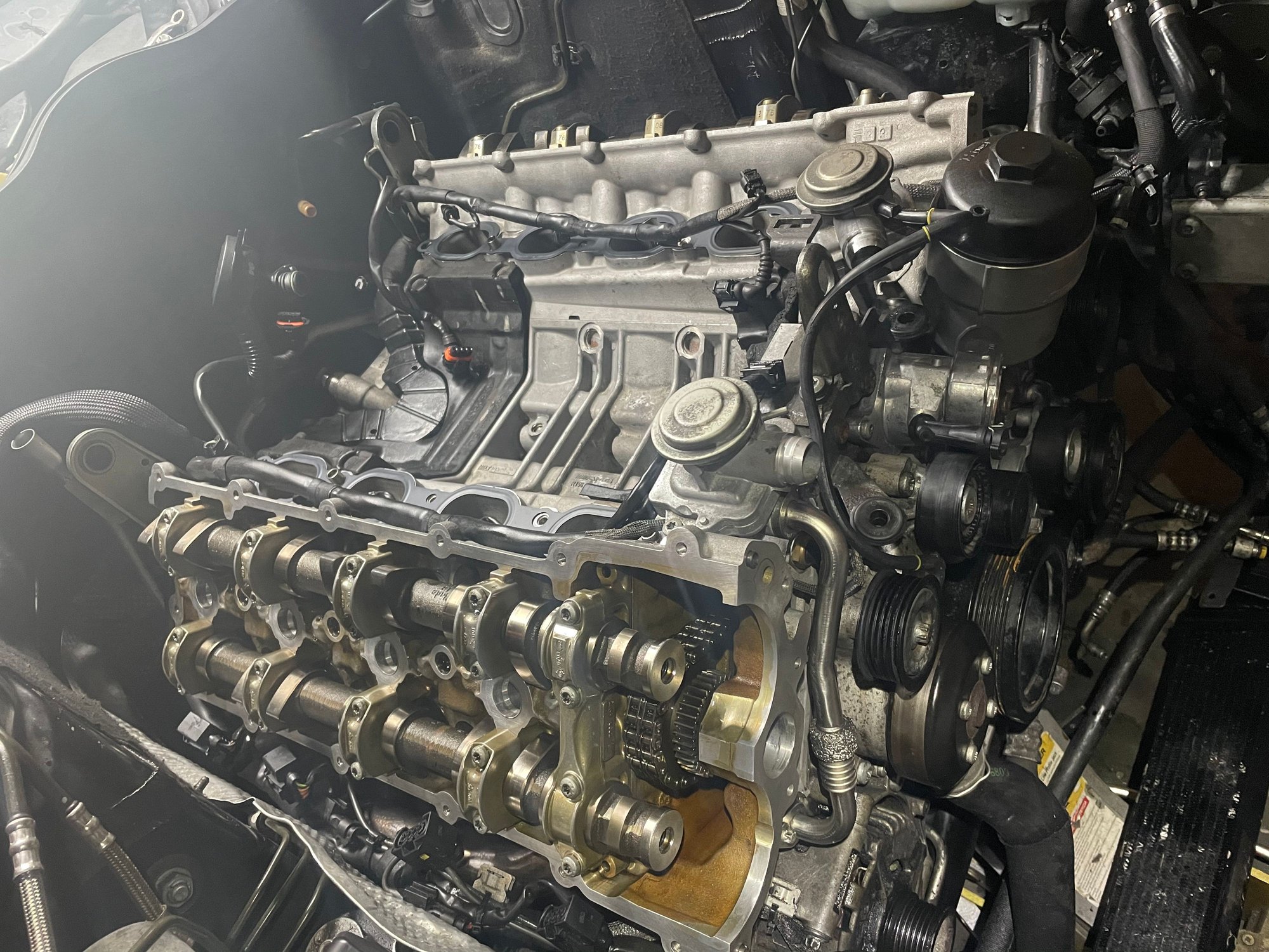

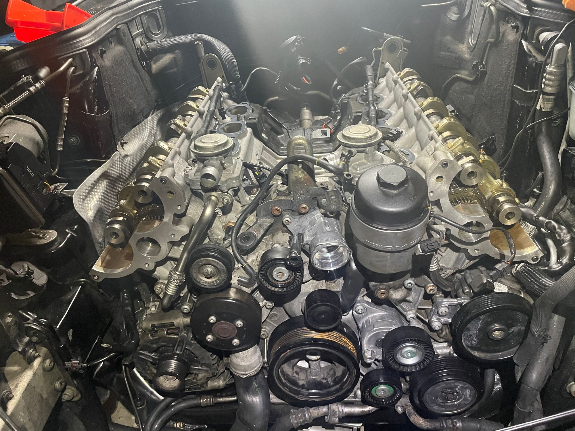

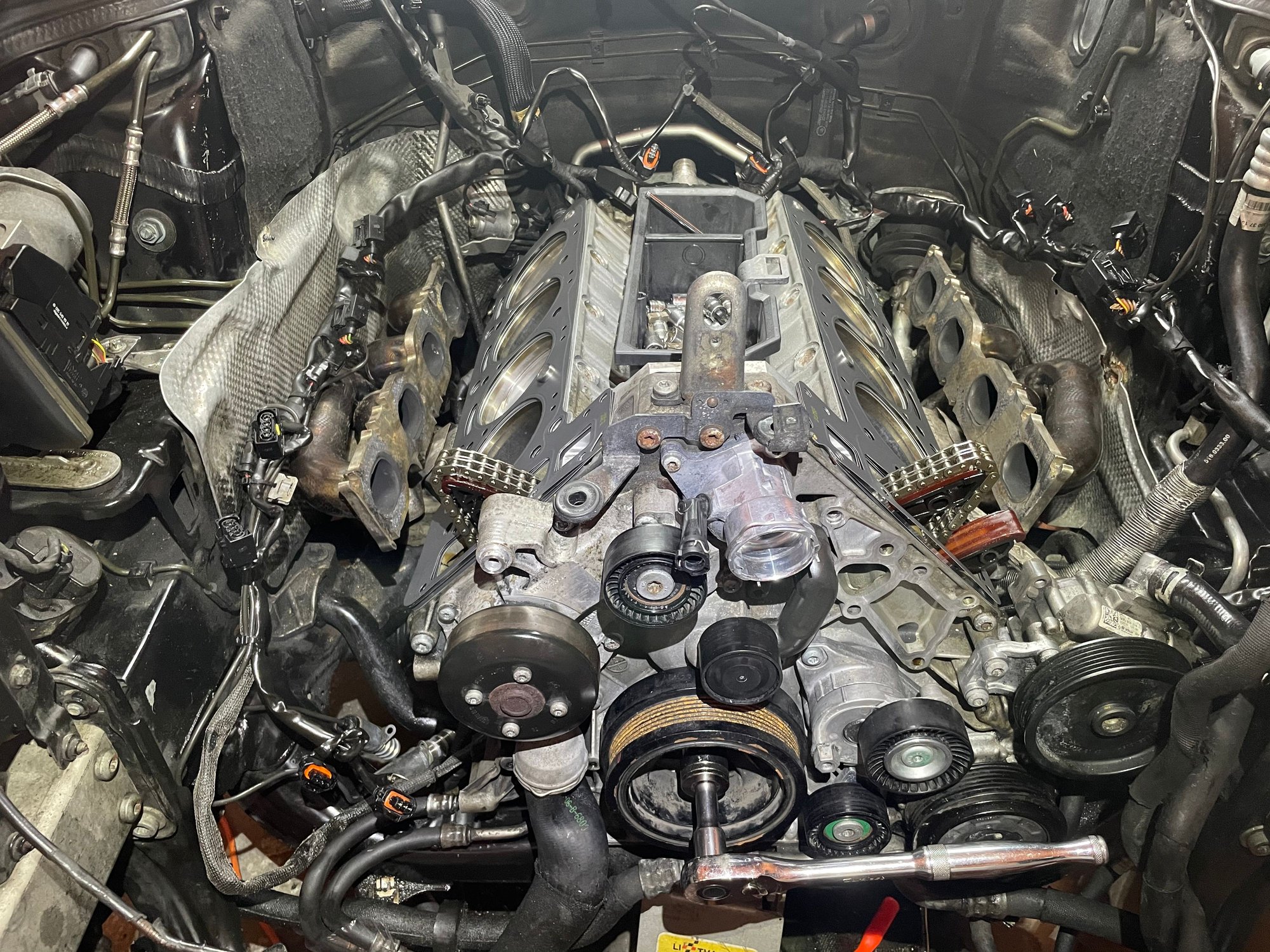

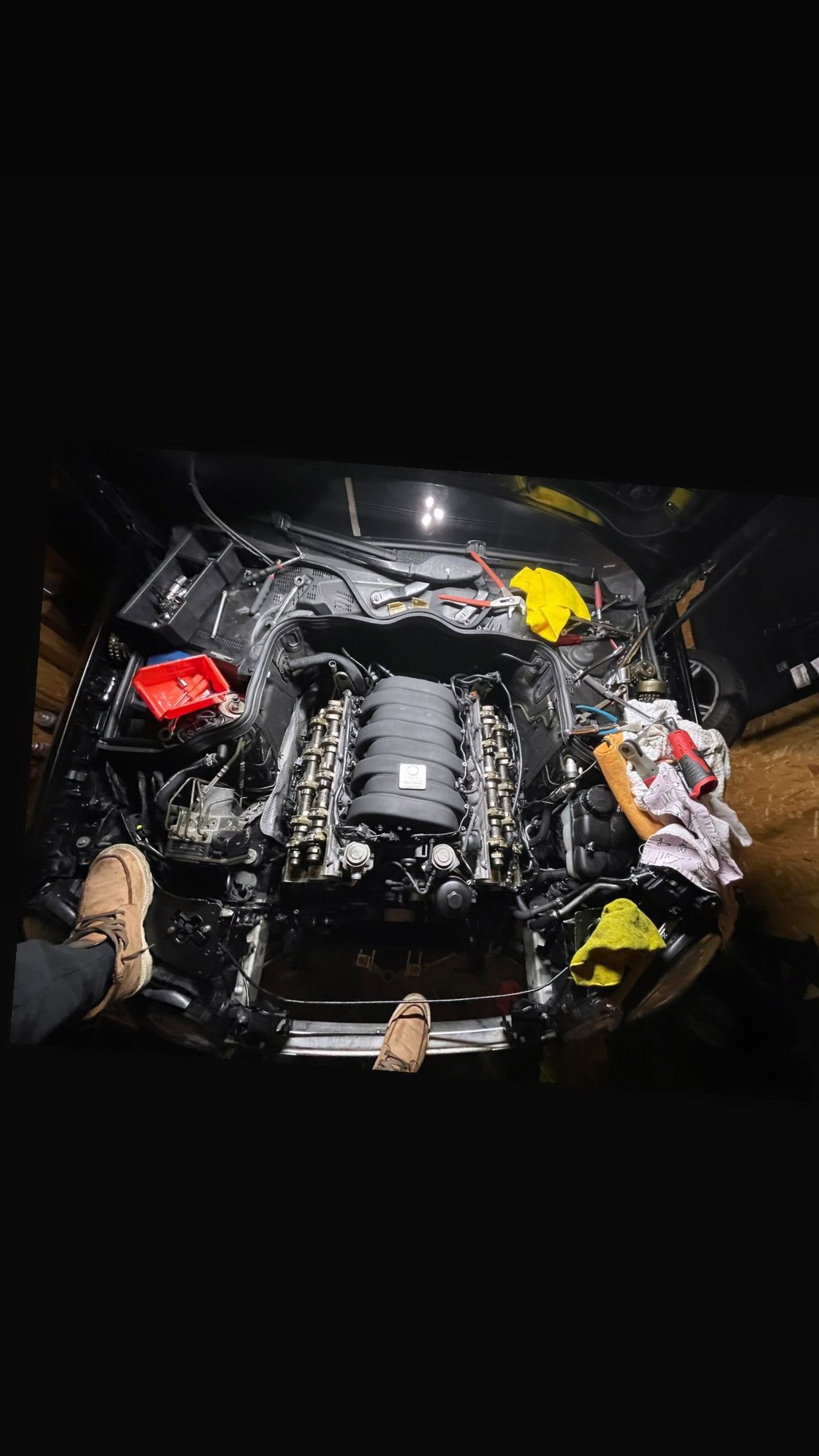

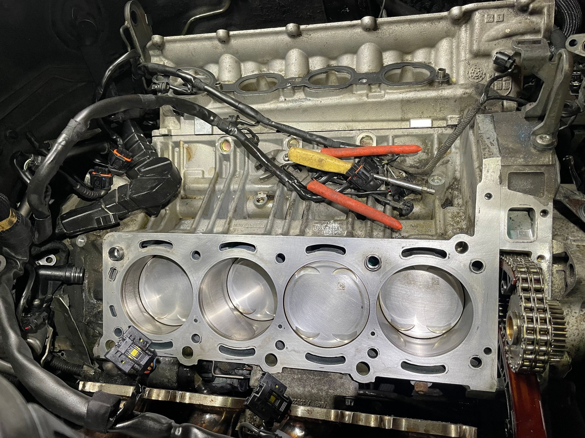

Hi guys I did a rebuild on my m156 about 5 days ago myself since local shop were asking 4-5k for just labor without parts. And I must say no one will do a better job on your car than yourself . I’m located in mass and
ig@ dailydrivenv8
Dirt from fan
Stock heads on my 07 w211 e63 with 141k miles.
Cleaned
Timing chain guard are fragile because when taking off the heads and mounting it back on to avoid chipping the plastic piece on the guard
Cleaned all valves
Piston cleaned with WD-40 and scotch sponge
My YouTube is @dailydrivenv8 Give me a follow I want to start putting more contents out there since I enjoy working on my car 🙏🏾👊🏾👊🏾👊🏾 And check out my YouTube or ig for video content on it 🙏🏾

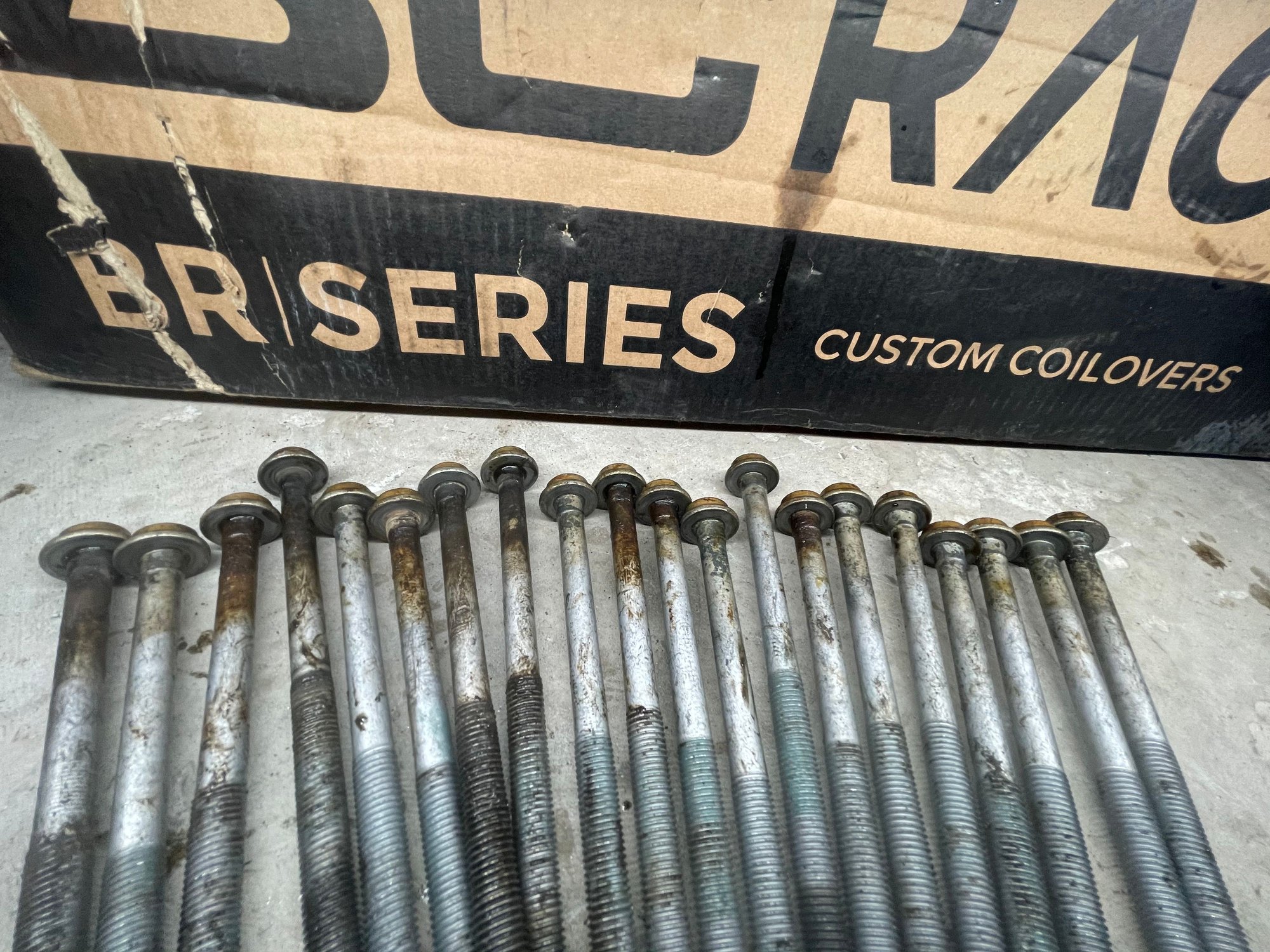

while not an engine rebuild, nice work nonetheless. what was the reasoning for pulling the heads? looks like you had the old version head studs?

What is a rebuild in your opinion then?
rebuild means, new piston rings in most cases. if that means you have to overbore 0.10 or 0.20 over as well, then so be it. for the M156 we cannot overbore, so if your bore is worn out you'll need a replacement block or sleeves installed as we do not have easy access to shops that can reapply the twin arc spray liner.

Nice work, well done.
What parts did you replace besides gaskets and head bolts?
Any of the below?
camshafts
cam buckets
cam bearings
valves
valve seats
valve springs
valve guides
valve seals
chains
sprockets
crank pulley dampener
chain tensioners
pistons
piston rings
rod bearings
crank bearings
water pump
alternator
starter
block deck facing
cylinder head deck facing
cylinder bore liners

I might add to say nice build and congratulations on having the ba_ _s to do it by yourself! I see you replaced the Air Pipe on the front of the engine under the Thermostat too! I didn’t catch that when I took off both Heads and had to do so shortly after noticing oil buildup in that area. I couldn’t help but notice that the front of your engine in that first pic was pretty soaked with oil! It looks like it may have been a combination of leaking valve covers, that front pipe and perhaps even the lower front oil pan? Did you go that far as to lower the front subframe to redo that big gasket! I understand that there’s a very worthwhile MOD having to do with the Oil Pickup pipe (Hackroku?? Maybe) that if overlooked can lead to a blown engine!! I didn’t get that far either but that’s most likely going to be my next “repair” as I definitely could see some seepage from that lower front pan. I have a replacement Timing Chain & Guide Rails and Oil Pump Chain and Rails in a box just waiting to be installed.
I also noticed the nice work of cleaning the top of those gorgeous pistons! May I ask what your method was? After feebly attempting to clean up with lessor strength cleaning agents, I ended up going with Acetone soaked shop towels used at the end of several of those plastic body trim levers, so as not to make a nasty scratch! It took a long while, but rendered very similar results!
I can’t help but mention it would have been a perfect time to install a catch can while you had the intake and passenger Head Off. Did you replace the Valve Tappets while you were at it? I shelled out the extra coin for the SLS Blacks and only wish I had the the coin at the time to get those sweet aftermarket Cam Adjuster Plates and barrel pins. If you read about my eye opening realization in any of my posts regarding the fact that my CA’s were taken apart and put together incorrectly rendering them functionally inoperable and then, as if that wasn’t enough shoddy mechanic work, the Exhaust CA was put on the Intake side and visa-versa, you would have been sure to double check your serial numbers upon reinstall, just to be sure! Yowza! I’m assuming that you replaced the Headbolts since you took a pic of the old ones. That was my main preventative reason for removing both Heads. It turns out that due to the Cam Adjuster issue just mentioned, this most likely was the cause for 8 of 16 of my Intake Valves being bent! I never would have known that had it not been for removing the heads and having them rebuilt by some real pro’s (shout out to Xtreme Heads of Palm City, Fl!!).
