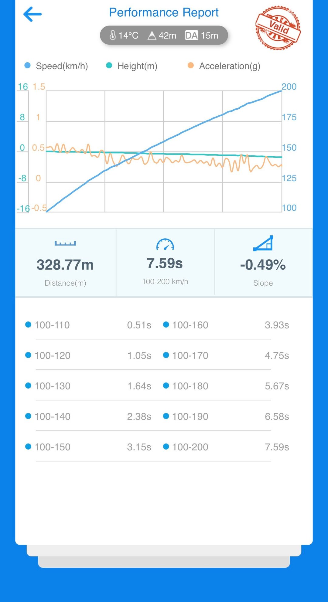

Hello
So im geting the tcu tune from vtech because every mod i got its from vtech…does any one know if the tcu tune drops 100-200 times my its a 2004 e55 with holding gear on manual mode
