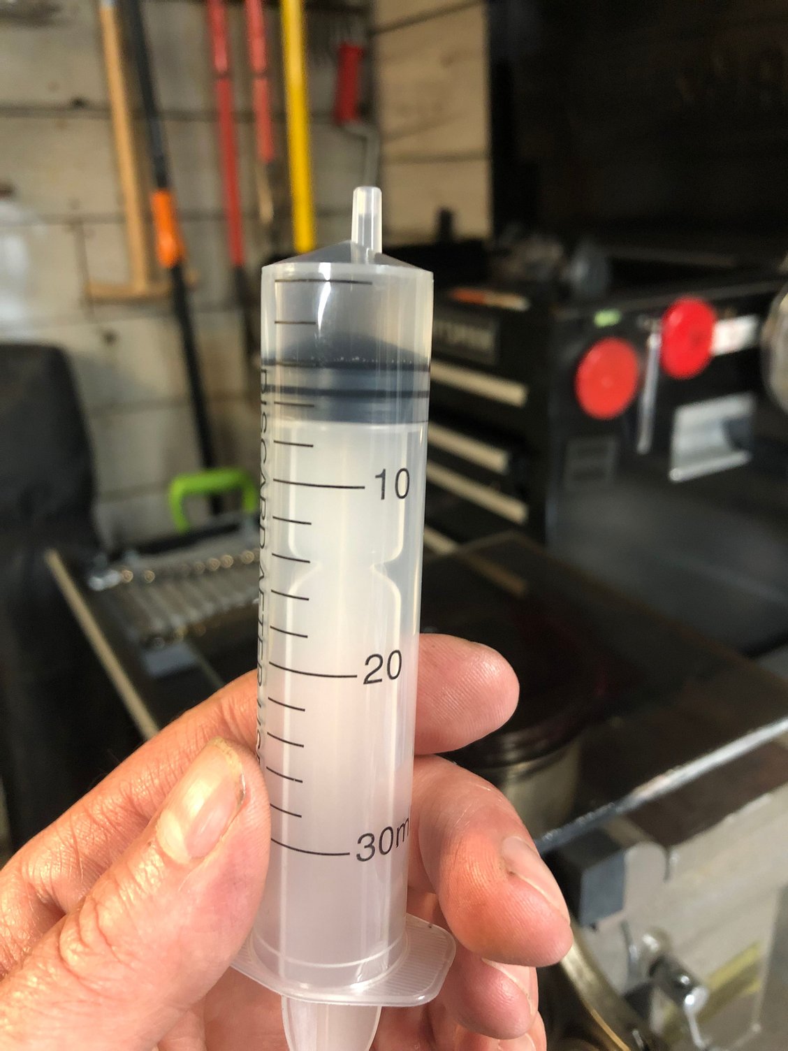

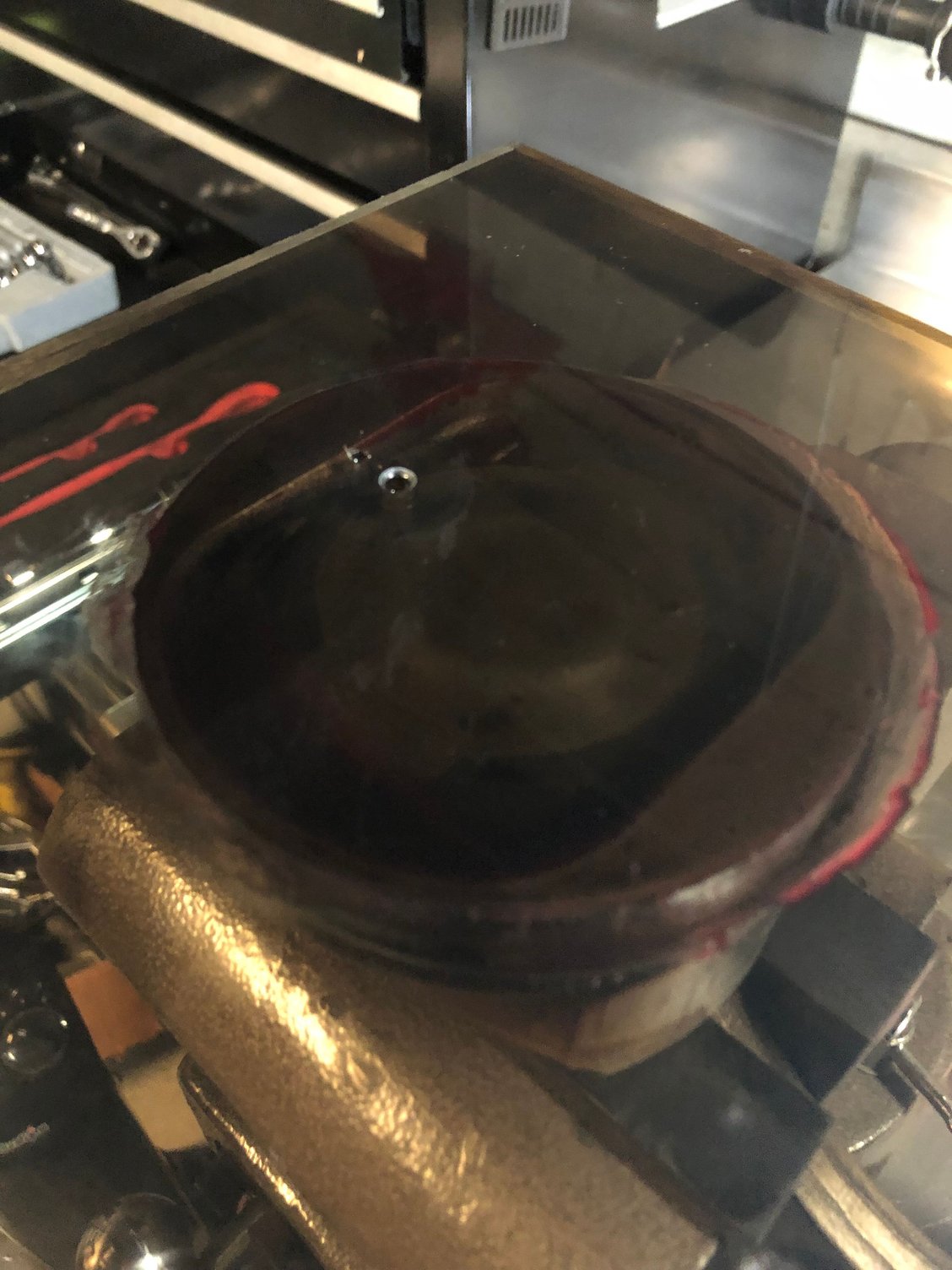

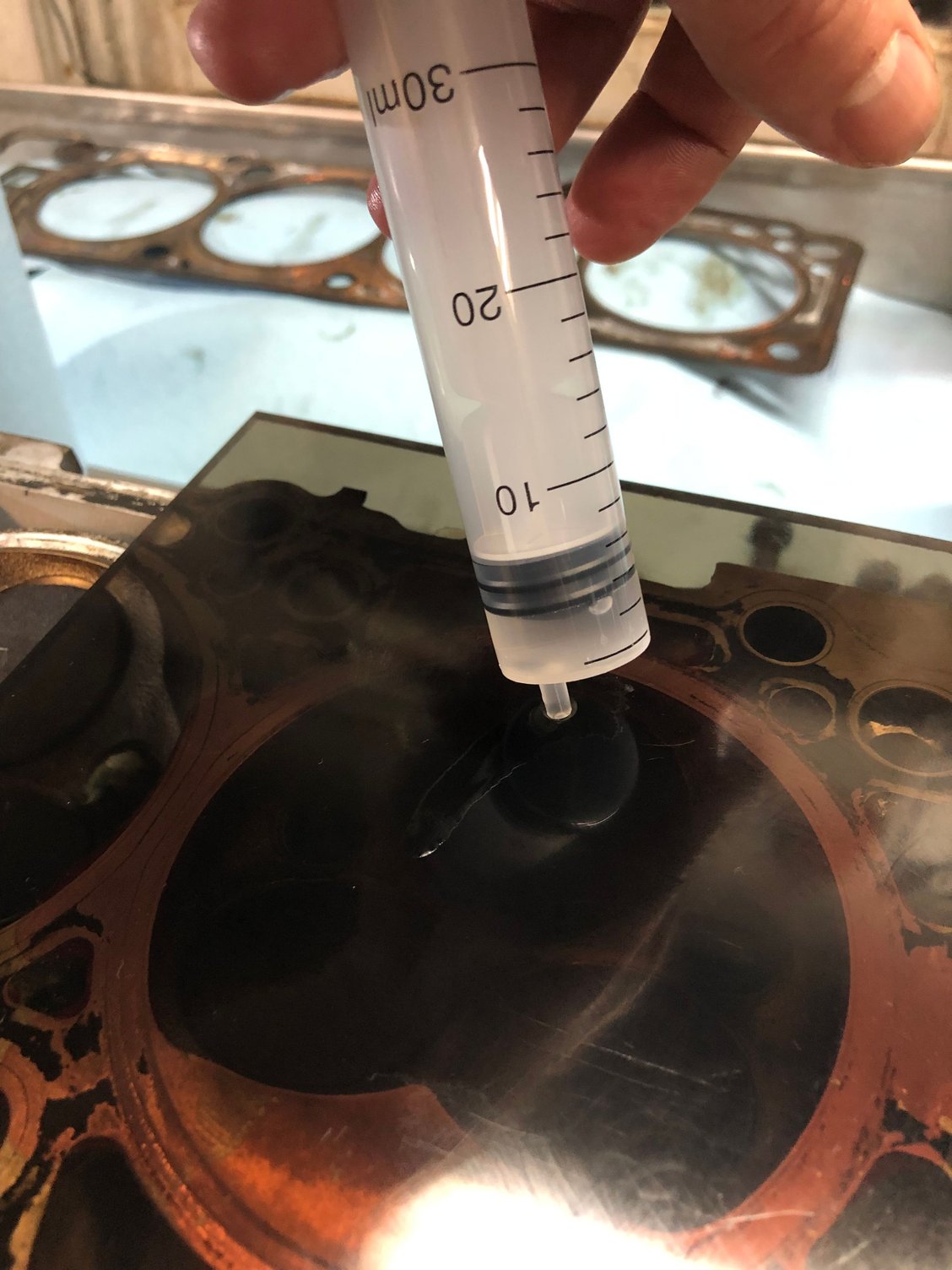

All you need is a piece of plexiglass or glass with a small hole lined up over the chamber. Seal against the head with a very thin coat of grease and add water through the hole using a precise measuring device. I used to do that years ago when verifying combustion chamber volume between multiple cylinders and/or after resurfacing the cylinder head.

That’s exactly how I checked the piston dish volume and the chambers in my NA heads, except I used isopropyl alcohol. Its thinner viscosity makes it less prone to having air bubbles trapped in it.
