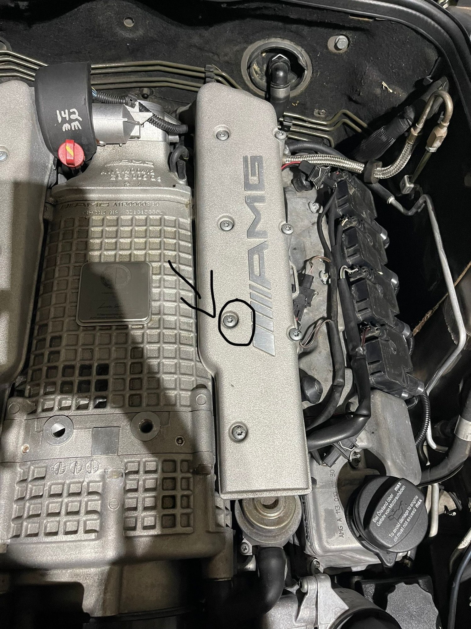

So I picked the car up 2 days ago. When I got home I noticed a small amount of smoke coming from the passenger side in the engine bay. (The car has had some smoke come up on startup intermittently but is usually barely enough to see.) but this time I had a good 10 second cloud of smoke that finally dissipated. Not sure how my car deteriorated that quick while at the shop but I’m assuming they gave it hell so never going back there and will be doing my own work from here on out. I was going to do a valve cover job when I got the car back anyway but seeing that made me order parts immediately. Went on fcp euro and got everything for the gasket job. I went ahead and ordered some spark plugs since I’m already in there as well as an OEM oil filter which leads me to the original problem. When I did the oil change I bought the recommended filter from auto zone (my first mistake). I knew it didn’t look right. Returned it and found the closest thing which was Mann before reading that even the Mann filters aren’t correct because the o rings don’t seat properly. So could it be the o ring is not sealing the filter housing and I'm getting some air past it? After I change everything out I’m still going to
smoke test it but i’m hoping it’s not from the slight over-torquing. (I’m not sloppy, it was a stupid mistake and trust me i’m not proud of it) I’ve done lots of car work but never to something foreign. I didn’t think about measurements in Nm instead of ft lbs, I just read the number 25 and tightened. No cracking or anything like that and as soon as picked my phone back up I read it again, loosened it and retightened it to 18 ft lbs. assuming that did no damage and the replacements go well, the smoke machine will be the true test for air leakage. If I have a question during any part of the process do I open a new thread or continue to post on this one? It seems pretty straight forward from reading but I’m sure I’ll have one that can’t be googled. Thanks to all.

Sorry for they late update, had a lot going on but finally got to finish everything up a few days ago. Found the vacuum leak without smoke testing after scrolling through some forums. Turns out it was the small metal pipe that runs under the driver side surge tank, which is apparently a common issue after changing the valve cover gaskets (job was done by pervious owner and I assume he never checked to see if it was reattached) so I removed the surge tank cover and re inserted the pipe. I was told the car had step colder plugs but when I pulled them out they were the stock plugs. Can’t remember the part number but I know the stock plugs have a 6 and the colder plugs have 7 and the plugs I pulled out had the 6 on them. I went back to eurocharged tune, Put the colder plugs in, changed the valve cover gaskets and did both breather covers which are a real pain to both remove and prepare (especially in 30 degree weather, had to set up a tent and a space heater to get the gaskets to cure). I
believe the engine is pretty much buttoned up but I have one issue that has really put a damper on things. When I torqued the bolts down to only 11 nm
(recommended is 15-20 so glad I didn’t do that) one snapped and another snapped my T-30. Seems to be common as I read a couple threads about people snapping their bits due to their torque wrench not clicking so my next job is removing the surge tank once again, extracting the bolt and finding a replacement. I can’t find any online so if anyone has a suggestion on where to find them it would be much appreciated. If not I’ll have to take the 2 broken pieces to a hardware store and find one that fits. I’ll also be swapping to BC coilovers because my right side shocks are leaking due to a pretty bad pothole. Roads in Statesville NC are absolutely horrible and I knew it was a matter of time before something like this happened. If anyone is interested in the left (or even right) side shocks or the compressor I’ll be selling
them on the classifieds to make a little money back on the swap. So the bolt that I broke off and the passenger shocks seem to be my only issues at this point, but I will post an update soon on how the engine is doing in a few days. So to sum things up I need the bolts for the surge tank (image shows the specific bolt) and some advice on why it’s riding so rough. I’m hoping it only damaged the shocks and did nothing else because I’m getting terrible vibration and I cant pinpoint the exact component (praying it’s not motor mounts). Will the shocks cause this or does it sound like a different issue. This happened before I tore into the engine but it wasn’t sagging this bad until now. I’ll replace the ball joints while I’m in there but as I said about the bolts any Input is appreciated. Thanks guys.

Haven't checked with MB? From the parts catalog 000000-002047 M6x80 (should confirm the length as there are four differnt lengths) retail $4.00. Good luck.

This may be a stupid question but would it be bad do drive it about 15 mins to work and back until the part arrives at the dealer on Tuesday, don’t know why that wasn’t my go to lol only $11 for both sizes. I don’t want to do any more damage but I’m supposed to be giving the persons car that I borrowed back to them tonight and I’ll have to drive something.

I wouldn't worry about that short of a drive, its mostly or all sealed with the other bolts, and if it did cause a vacuum leak it would far less than the hose/pipe that was leaking and you fixed.
