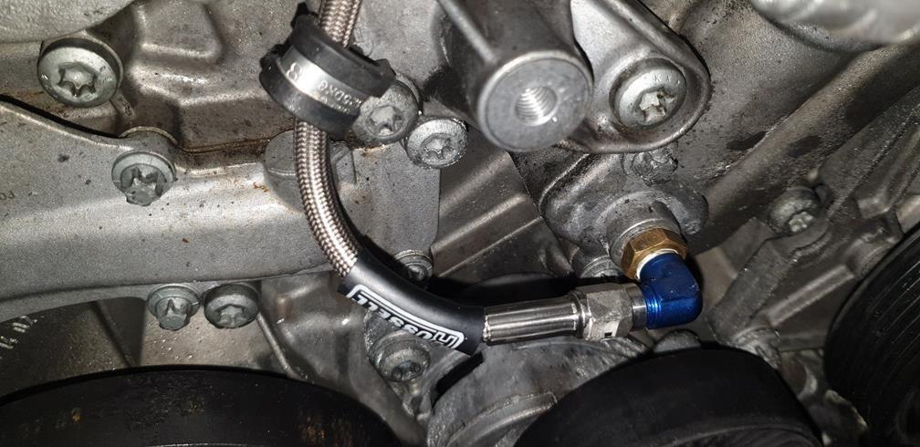

Thanks Joe much appreciated. I've got a 10AN male female adapter that I will put on the lower fitting which has a 1/8" NPT port which I will fit a Bosch combination temperature/pressure sensor. Both inputs will got to my Haltech Elite then I will use A DPO to run the thermo on my oil cooler.

I could be wrong, but not sure that is a good spot to tap for pressure, as it will be behind the thermostat, and ahead of the cooler and filter. Will give you artificial readings on pressure.

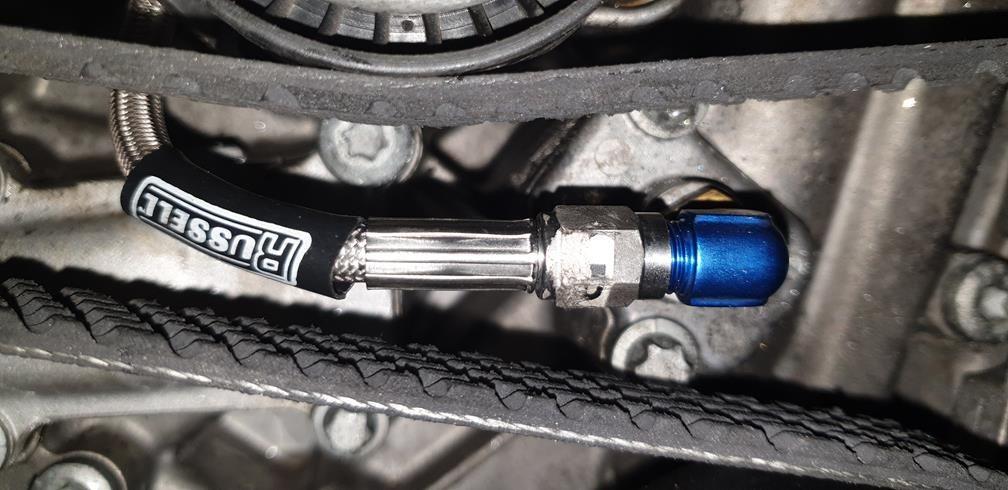

Ok thanks I'm going to have to figure out a way to get the VDO ohm style sender for the instrument cluster into the test port as well as the Bosch 5V combination sender for the Haltech ECU. As you know there is not a lot of space around the rest port due to the engine belts.

Maybe a feed to a remote mount block or something.

I used some fittings and a -3 brake line to remote mount the sensor.
