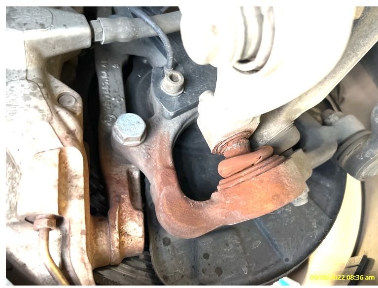

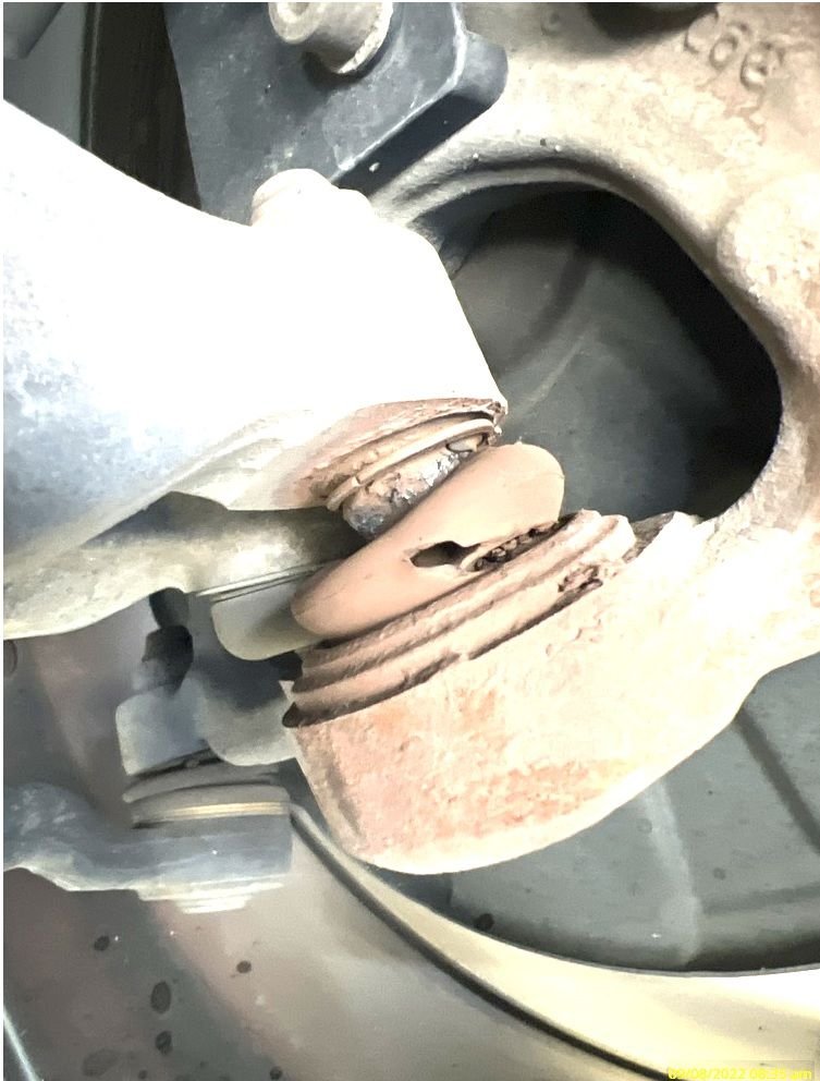

I got a MUCH larger than expected quote today to replace front suspension parts that I just can't pull off right now (kid in college, another with medical bills) so was hoping i might get some advice here from folks who have dealt with this before. I've done a lot of wrenching on cars over the last 25+ years (engine buids/swaps, trannies, pretty much all systems except suspension) but I just never had to (Or chose not to) do anything with suspension. My car is a 2006 CLS55 with 94k miles on it. I've owned it 10 years now and have not yet had any suspension issues but I definately can see it needing attention now (noises, wore out, etc, see pics). I just have a few questions below I'd appreciate hearing from people on, but am also open to any guidance or suggestions beyond those as well.
According to them the front suspension has totally bad rear lower ball joints and about to break, the control arm bushings are cracking and the bearings have a lot of play. Questions:

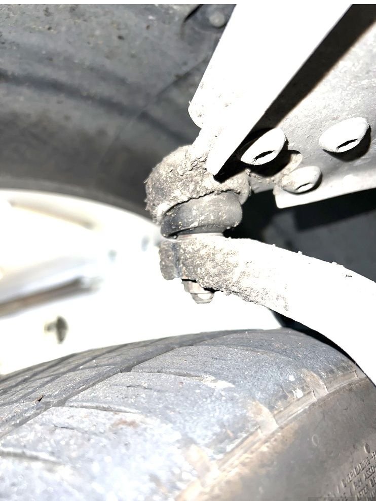

Drop links might be a good item to replace. Also consider replacing nuts+bolts if they looks crappy

Definitely, replace your worn out ball joints, as that is a safety issue and needs to be addressed immediately. In most cases, the upper wishbone bushing don't need replacing, just the individual upper ball joint.
The lower control arm, thrust arm, sway bar links, lower ball joint will need replacing at some point. If money is tight, then replace the ball joints first. Your worn out bushings will keep you on the road until your able to replace them.

What worries me, is those rusted out ball joints, if they were to fail on a drive, your entire suspension could collapse, and the wheel could separate from the knuckle. Personally, I wouldn't drive it in the state that it's in now.

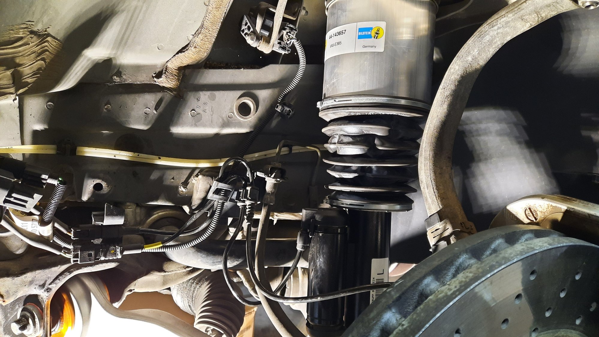

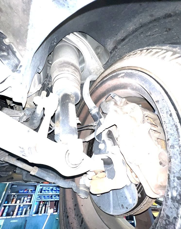

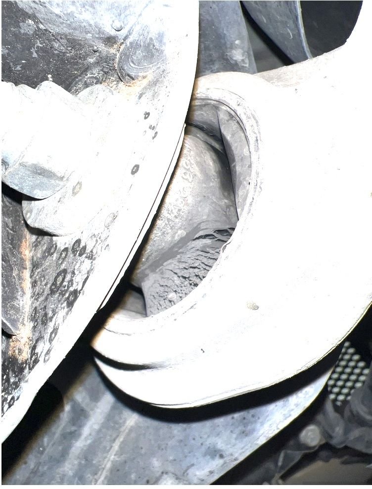

Hello, I am in the midst of a front suspension refresh since my Right front air strut failed on my 06 CLS55 as well. $3400 seems like an awful lot especially since you are not doing air struts too. Everything is fairly straight forward. The lower thrust arm bushing take a beating and get ripped out. I went with the units from FCP that have the spherical joints vs rubber bushings. There twice as much but should not have to replace them again. They have a nice full boat kit with all the arms. If you replace the strut control arms that the struts and sway bar drop links mount to you should get an alignment done after. I replaced my upper ball joints since they are super easy and I had to disconnect them any way to drop the air struts down. You can get a CTA 4013 or OTC 6297 ball joint remover which is not as cumbersome as the c-clamp style. I have one and it works well. A good digital torque wrench with angle would be useful but not a need. I am getting by with my torque angle gauge and snap-on torque wrenches. Please see below for torque specs which have helped me.

Those look great, I saw them being used by Alex from LegitStreetcars as well.
Lol, I just noticed that you guys have that issue with the boots for the inner tie rods as well (deformed). Seems like a product characteristic :P

Yeah those thrust arm bushings really show their cracks and tears when you flex the bushing. I think their is a design issue here that the bushings just do not hold up well especially considering the rest of the bushings and ball joints looked good still. Alex mentioned a rubber bushing or a fluid filled bushing too. At least these spherical joints will outlast the ball joints on the other side.

OP replace those ball joints before you drive the car again. With fresh ball joints and an alignment drive it only as long as it takes you to scratch up the dough to do all the arms. Those arms with spherical pivots... wish I knew of them when I had the E-55. Do both of them on each side at the same time. Those upper ball joints are inexpensive and an easy replacement. Do it. Get an alignment by a guy who can align a Mercedes correctly. This is not Elroy at the corner garage.
