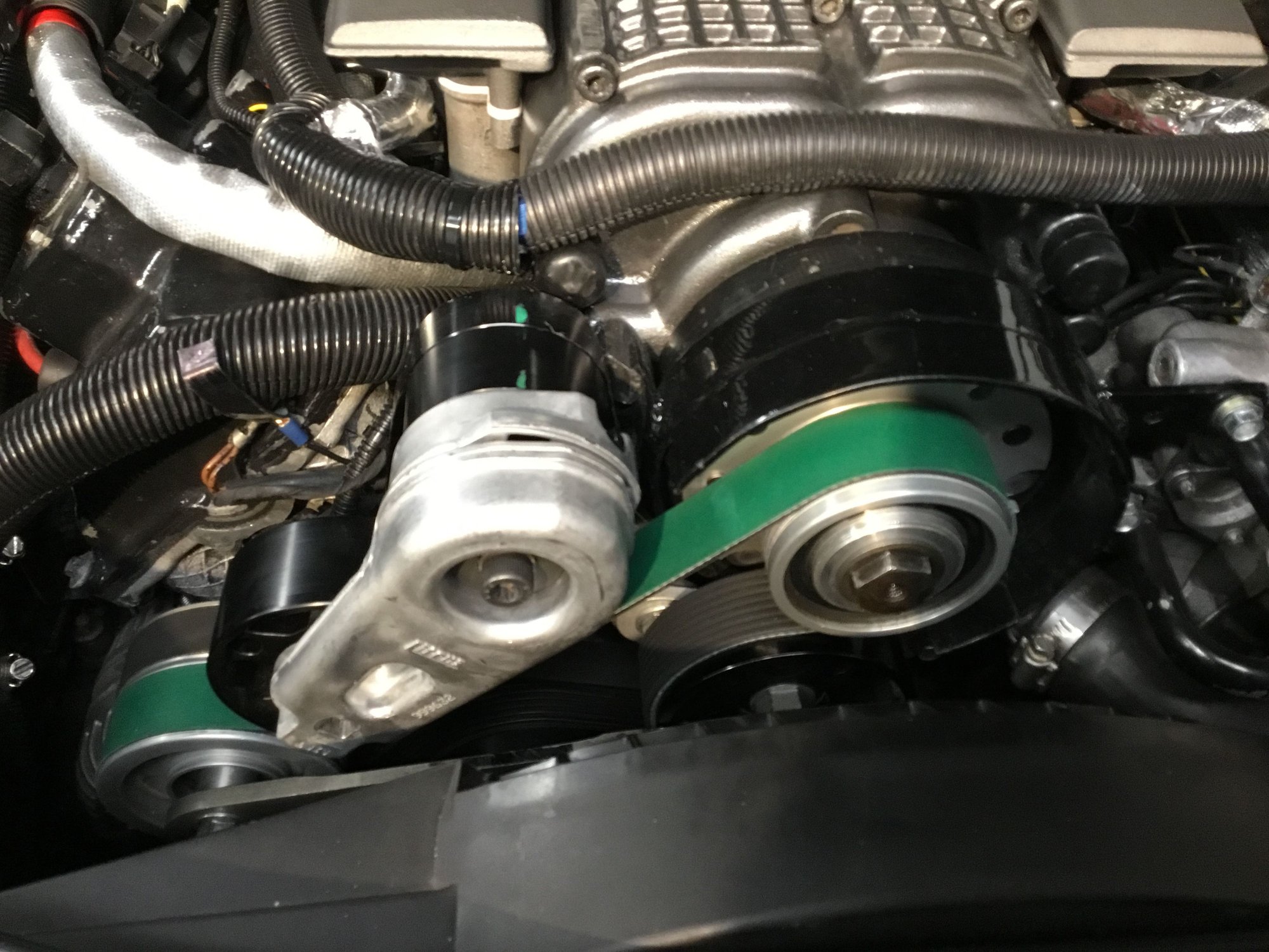

OK here is where I am at. Pulled the blower"again" lol and installed the block off plate. Car drives and idles exactly the same so that was great. Under boost it is much more violent meaning boost is instantly there with no control from the bypass. I picked up 1/2 to almost 1lb pound of boost on the top end but now find that the belt is slipping even worse and don't know why. Also boost peaks at 5k instead of 4,500 and holds better through the rpm band. My data logs now shows peaks and valleys of boost where before it would just climb up and then begin to drop off. I believe with out the bypass bleeding boost the load on the blower is much greater and that puts more load on the belt system.May try some stuff called Track Bite on the belt and see what that does but im at a loss right now considering I feel my tensioner and wrap set up is very very good with everything custom plus a Griptech pulley as well. Tensioner is a 30 lb unit as well. Pulley combination is 168-77. Would like the tensioner closer to the pulley but belt combinations that I tried this size fit the best with the most tension.
On a side note without the bypass the superchager has gotten really quiet do to the boost not free flowing through the bypass system...now there is a constant load on the rotors.

The slip is most likely the clutch... Go solid...
Old Apr 3, 2023 | 09:14 PM
SICAMG's Avatar
Joined: Jul 2014
Posts: 3,324
Likes: 584
2005 e55 AMG
I thought that too so I would inspect it often and found nothing as far as metal transfer or scouring-blueing. With the amount of beatings and 1/2 mile passes on the car the backing plate should be smoked big time but still looks great.
There are still signs of belt dust so I know it still slips....enough for my analog boost data log to pick it up on the recording.
I also never had this issue until I installed 3.06 gears and a lighter torque converter that is 10lbs less from stock so the engine comes up much much faster now.

Also swap over to the Gates RPM belt instead of the green HD one.
Old Apr 5, 2023 | 03:30 PM
SICAMG's Avatar
Joined: Jul 2014
Posts: 3,324
Likes: 584
2005 e55 AMG
Good info. Thought about the rpm belts but heard some very conflicting information on longevity and breakage if not tensioned correctly.
Will order one tonight and update.
It still baffles me with my set up that there is a lot of slip now especially now with the bypass blocked...I guess the blower is really making more boost early and not bleeding off from torque control.
On a side note boost was much much better with a new belt that was REALLY tight but it still dust all over the bracket.
