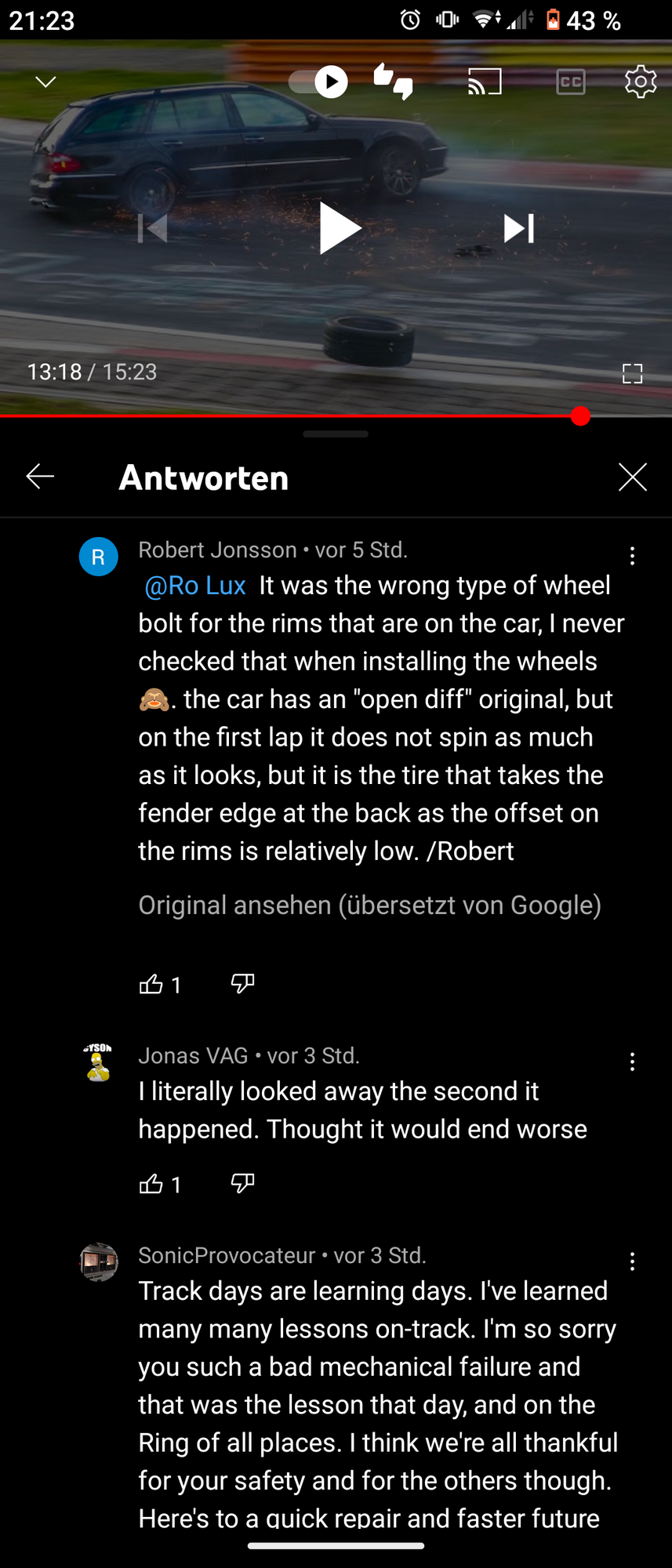

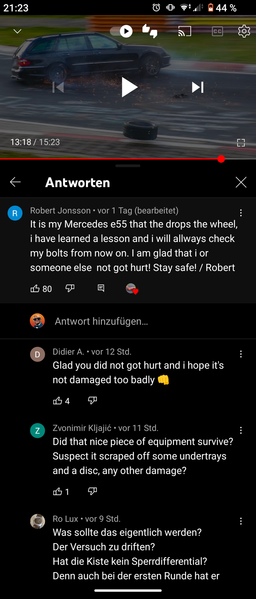

Apparently he installed the wrong wheel bolts on his car.
