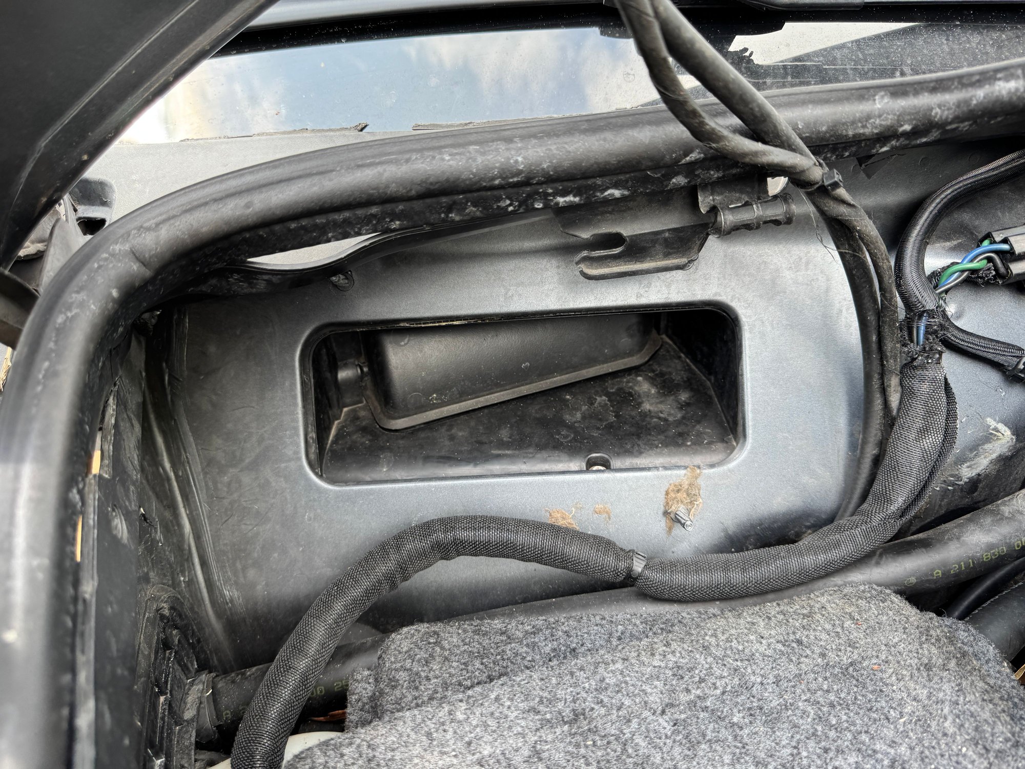

Just got the vrp under hood tank for my w211 e55 and it looks really good. Just now now realizing that after cutting the cabin air filter housing that the vent on the hood is right above the tank. The air intake for the cabin is right behind the tank and i was just wondering if this is going to be a problem in the rain. I dont want water getting sucked up into the vents and ruining the electrics.
Cabin air filter vent location

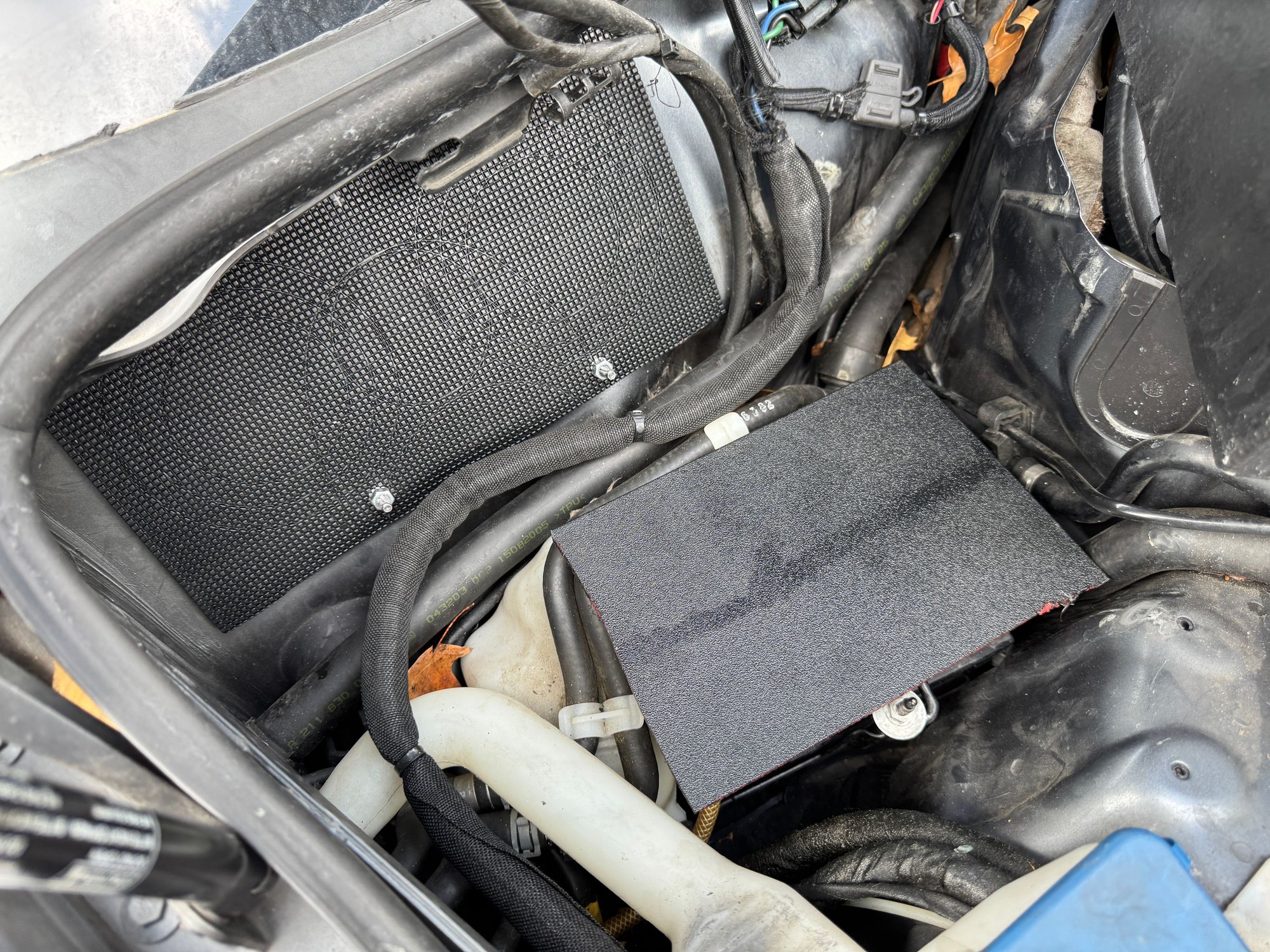

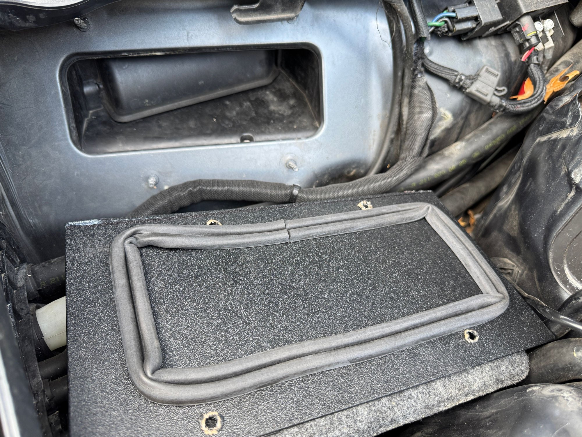

Sorry for the long break, just finished putting the car back together. Heres how everything looks. Got the part new from dealer for 30$. No idea why they said 60. Ive been busy with school and work and just recently finished the e63 conversion and cooling upgrades.

Heres the engine bay

The vent cover i posted earlier actually solved all the water intrusion problems. After installing it i have had no water go in, i did use some tape to cover the little holes just in case but for 30$ its a easy fix with oem MB parts.
