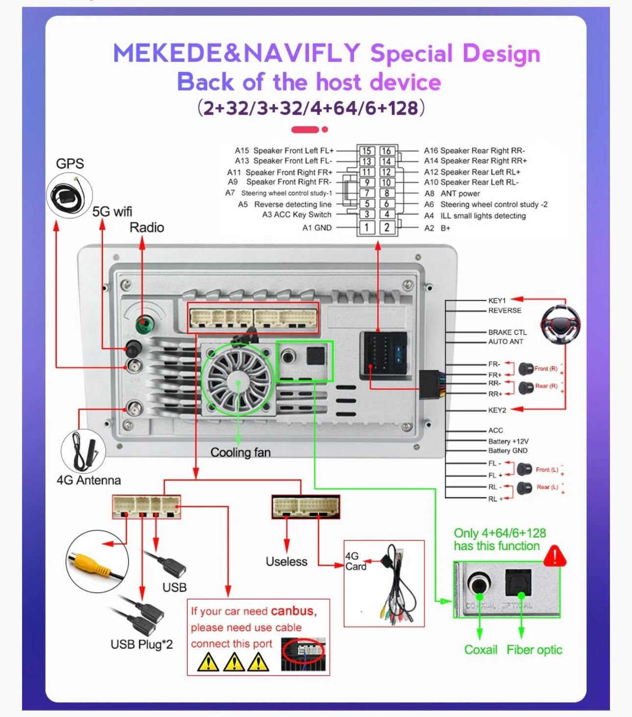

Hey guys, just bought a 2004 E55 with the HK system and would like to replace it with a CarPlay head unit. I know the general thought atleast as of 2014 was to get the RCA to fiber adapter to retain the HK amp, but with that setup you’re splitting the front audio between all and losing fader ability. I get that if you aren’t running 7.1 wav files you won’t take full advantage of the 7.1 anyways, but I would like to be able to use the fader.
I see several of these head units that have a Toslink fiber port on the back- can I use this to go directly into the stock wiring and retain full stock functionality? I haven’t been able to find a thread that discusses that yet.
I have attached an example of the back of one that has the optical + regular plug for RCAs

I'm not sure what that manufacturer advertises but virtually all car audio is 2 channel; as in, no front/back. The backs are almost always just a copy of front, with different time delay. I do remember being able to fade when I had the AVIN usa head unit.
Another option is to install aftermarket amps, but keep the speakers and speaker locations. You could leave the stock AGW for things like phone calls or whatever else... and use the new amps for your audio signal.

TOSLink does not communicate with the proprietary MOST audio optical interface. If you'd like to keep your factory MOST system, the ONLY solution is going with a mObridge 8.1 which can take the factory MOST signal from a factory head unit. https://mobridge.us/product/mobridge...audi-mercedes/
if you want to convert to aftermarket like I have done for head unit and amplifier to utilize TOSLink, you'll need an all in one like i have or separate DSP and amplifer. I use a Helix V-Twelve which is has additional speaker outputs which was overkill. https://www.audiotec-fischer.de/en/h...twelve-dsp-mk2 . could go with a Helix V-Eight for lower cost as our vehicles only have 7.1 audio.
moving to a digital output (toslink or coax) you will lose volume control from your head unit as any digital output from a head unit unless its through USB is essentially line level volume with zero adjustment in volume. so you'll then need to run volume control from your DSP or amplifier to the front of the vehicle.
my whole setup is, head unit mounting kit from enfig, Joying 13.1 inch android head unit (older version of linked below with different specifications and screen), Helix V-Tweleve DSP with Amplifer, Helix Director Audio Control head unit. i decided on this because the factory speakers are very good and i wanted the ability to fully tune, frequency, and time adjust all speakers in the vehicle.
https://shop.enfigcarstereo.com/prod...fig-rmk7-w211/
https://www.joyingauto.com/latest-10...lay-radio.html
https://www.audiotec-fischer.de/en/b...remote-control
as stated above, all car audio is 2 channel. the DSP will then split the L and R signal to all of the channels with processing applied. the same applies for digital car audio; two channel that is processed by the DSP. digital in home or pro theater audio can support upwards of 10 channels but not in car audio. using a 2 channel MOST audio converter i'm not sure if this will then be processed into all 7.1 speakers. I initially ran wiring to bypass the factory amplifier to 4 speakers directly from head unit using a plug in harness to the factory speakers connector off the factory amplifier. this cleaned up audio quality as the factory amplifier is muddy sounding, but the soundstage was not ideal as only using 4 of the 7.1 speakers.
the kit you linked looks decent. it includes the harness that runs back to the factory amplifier location, but bypasses and plugs directly into the speaker harness as I ran initially. the sound quality will be good but you'll lose quality in the sound stage and room filling.
