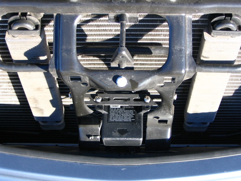

I have: (i) two jammers mounted behind the "meshing" below the grill; (ii) a radar detector behind the grill; and (iii) one jammer mounted to the rear license plate frame.

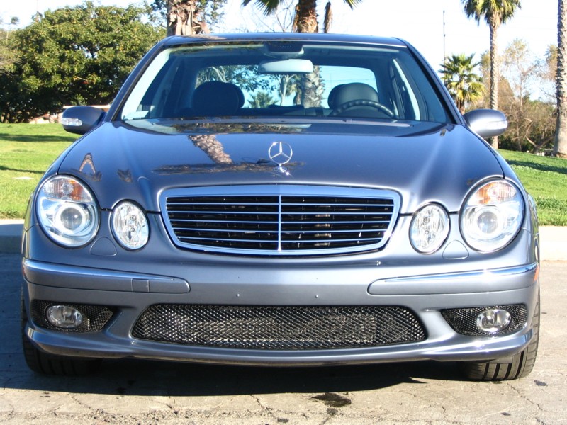

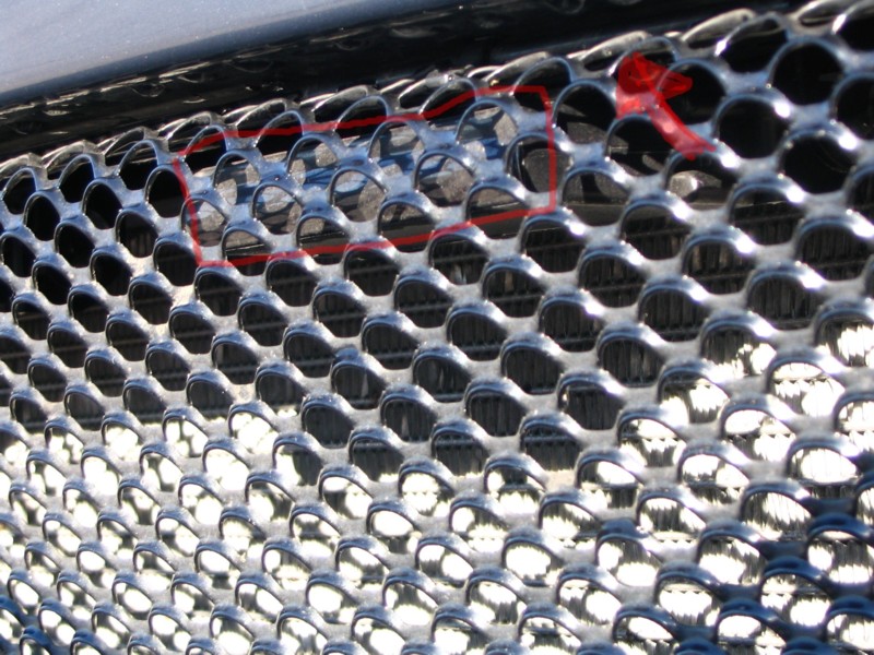

on my mother-in-law's 04 E55, the front transponder is mounted behind the lower grille mesh.
Some of the grille metal was removed from where it blocked the transponder lenses; the transponder looks like it's attached with zip-ties.

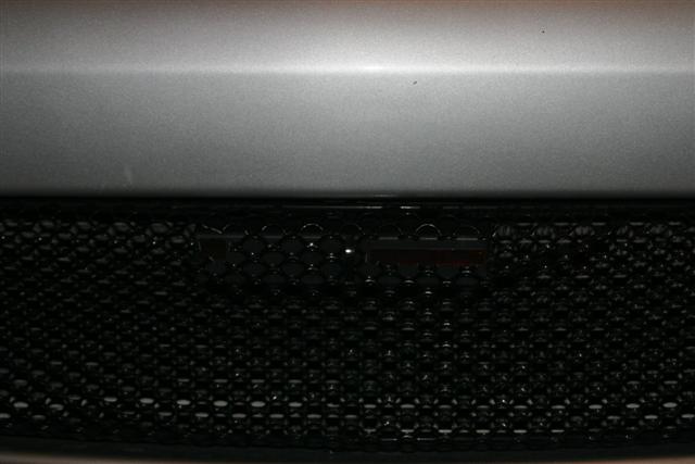

here's a pic of the front. sorry, but I haven't been able to take a closer front pic. I guess if you look closely, you can see the transponder mounted center-top of the grille.

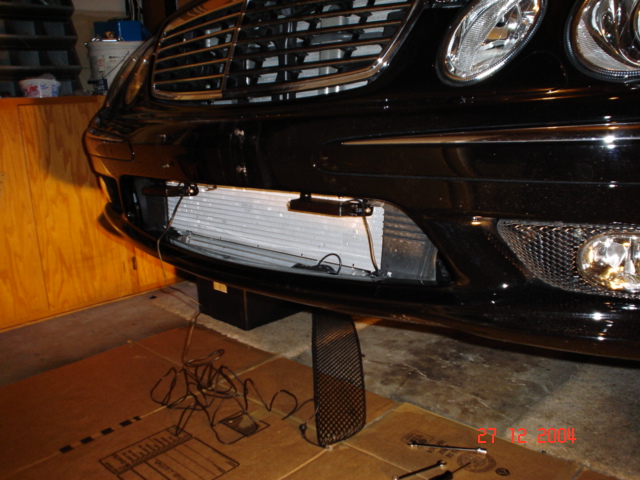

Sorry, when I read your post for the first time, I didn't realize that you were asking specifically for information with regard to Lidatek/Blinder. The system that I have installed is a Beltronics. I've had it for 8 months and have been pleased with it. In that time, I've been "painted" with laser twice and, on both occasions, avoided apprehension. I have two lasers and a radar up front; one laser in the rear. I had a guy install it for me, so I can't help with your questions with regard to the wiring.
Best of luck. (This is my second time on a forum; first time attaching photos, hope it works.)

Third time a charm?
Now at least I have the photos uploaded to the "Attach Files" box. I hope that they make it to the posting.
(I'm considering changing by Member ID from "lbE55" to "Village Idiot E55.")
Attached Thumbnails Lidatek / Blinder Laser Jammer Install Question-img_0030.jpg   Lidatek / Blinder Laser Jammer Install Question-img_0032.jpg   Lidatek / Blinder Laser Jammer Install Question-img_0034.jpg   Lidatek / Blinder Laser Jammer Install Question-img_0035.jpg   Lidatek / Blinder Laser Jammer Install Question-img_0036.jpg

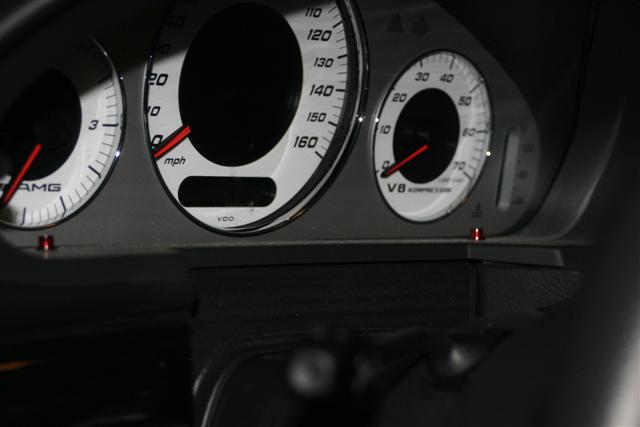

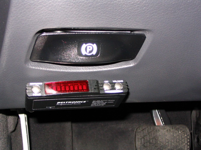

Okay, Gareth: IIRC a while back you asked me to post pics of the LED's in the dash, too, so here they are. Also is a pic of the city/highway/volume switch mounted up under the dash above "launch" pedal, and a grille pic of the transponder.
Attached Thumbnails Lidatek / Blinder Laser Jammer Install Question-127_2722-small-.jpg   Lidatek / Blinder Laser Jammer Install Question-127_2724-small-.jpg   Lidatek / Blinder Laser Jammer Install Question-127_2727-small-.jpg

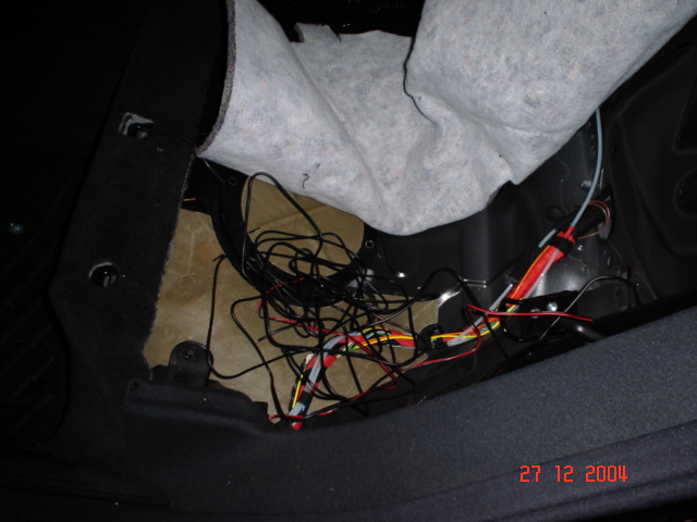

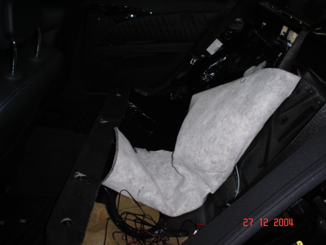

After a number of challenges I finished the Escort ZR3 install. I finally found a good location for the 12 volts (switched power). After removing the driver side trunk panels I connected to the wire that powers the trunk cigarette lighter (spare tire air compressor connector). I found a good ground next to a location that MB used on the wheel housing just in front of the fuse box next to the DVD drive in the trunk. With the forward trunk panel (behind rear seat) removed I routed the connector block (ZR3) on the driver side under the rear seat. For the front transceivers I mounted them behind the lower grill like other have. I then used 3/8” flexible automotive conduit and routed it from the front transceivers over the front wheel suspension (followed factory wiring already routed the same way) and then between the floor pan and the plastic cover plate under the car on the driver’s side. I routed it up the side of the fuel tank and entered the cabin with the entrance used for the fuel pump wires. The rear seat needs to be removed which is easy if you find the little tabs that needs to be pushed (one on each side). I removed the round cover plate that allows access to the top of the fuel tank and fished the wires from the under side to the cabin under the rear seat. With the back of the rear seat removed it was easy to run the power wire from the trunk lighter connection. I mounted the control panel in the same place as the photo IBE55 posted. I mounted the remote mute button on the side of the shift lever console just above the surface of the driver’s seat. My biggest challenge was reconnecting the connectors that I cut off the transponder wire so I could route them. I thought they were RJ-11 connectors like on a telephone. The problem was that they were some other connector like the one that goes from the handset of a phone to the phone (not RJ-11). I ended up soldering the original connectors back onto the original wires. I have a RJ-11 crimp tool and life would have been much easier if they were RJ-11. I hunted around for the better part of a day and could not find the crimp tool for this connector. In the end this install took about twice as long as I planned but I know it was done right because I did it. If you have any questions you could drop me an email at CCIE7879@hotmail.com. I will be traveling to Japan this Sunday so will have some delays in answering email.
Attached Thumbnails Lidatek / Blinder Laser Jammer Install Question-dsc00096.jpg   Lidatek / Blinder Laser Jammer Install Question-dsc00097.jpg   Lidatek / Blinder Laser Jammer Install Question-dsc00098.jpg   Lidatek / Blinder Laser Jammer Install Question-dsc00099.jpg   Lidatek / Blinder Laser Jammer Install Question-dsc00100.jpg
