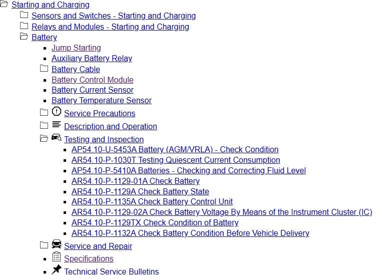

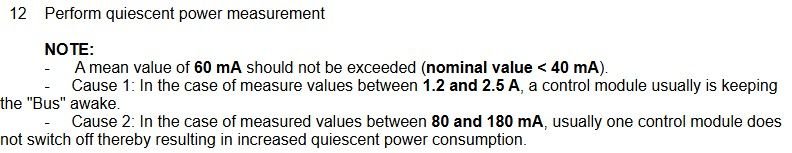

In the link I provided, this section has good stuff like this:
and this:

So I just started going through task AR54.10-P-1135A Check battery control unit 23.10.07
MODEL 211 up.
The fault code for the BCU was 9040 which is undervoltage. Terminal 30 voltage was 12.2. Battery charging current was -13.5, and the actual voltmeter battery voltage was 12.28.
It then directs me to run a "jumper" from the negative post to ground then disconnect the negative cable from the BCU. At this point my very thin wire jumper started to smoke so I figured it was too undersized. I quit at that point.
