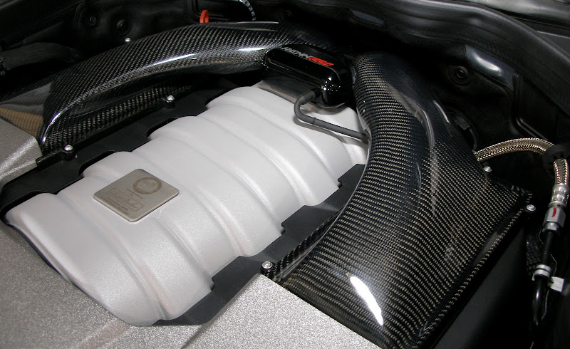

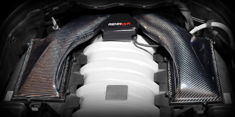

Its good to know a bit more info on those products, thanks a lot for the help MB_Forever. I thought the engine cover looked fantastic but if it yellows really quick then id rather not buy it at all.
I have been through Renntech's website and unfortunately its kind of outdated. However I contacted them and they sent me the following picture of their CF intake. I must say it looks quite ugly and im not sure the image is even meant to be on the w212 E63, but if it does the job then its all good right?
Also I was wondering if anyone had any pictures of the stock headers (exhaust manifold) for the w212 E63. I am looking for a replacement which looks exactly like the stock AMG ones but with a bigger diameter, for warranty-saving purposes hehe :P

I checked on RENNtech's website and found the following pictures of RENNtech's air boxes:
Where did you get the picture you posted above?
The supersprint exhaust in your link is a complete exhaust system with long-tube headers. They look nothing like stock and don't resemble at all. However, the supersprint stuff has always been very nice and top quality.
