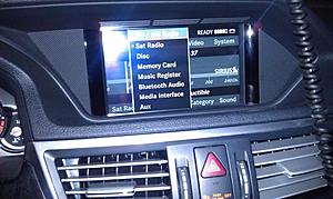

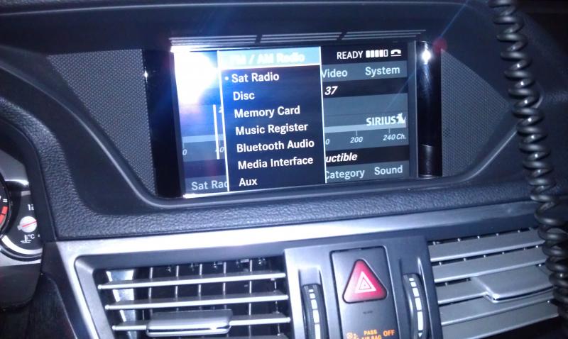

You have to go to the audio drop down menu and pick BT Audio (sometimes you have to hit the audio drop down twice), but you can't have the phone paired to any other devices or the car gets confused (or the phone does).
Should look like this:
Then when you click on BT Audio it will ask you if you want to connect to your device (connect last device or something like that).

Thanks for your help Derek. So went to my car and the bt audio magically appeared. However. I tried pairing the phone as the audio source and it connects initially then it says authorization procedure unsuccessful. I decoupled it as a phone source and tried again, same message. So it connects and pairs as a phone but not as a BT audio device. Did this happen to you?
