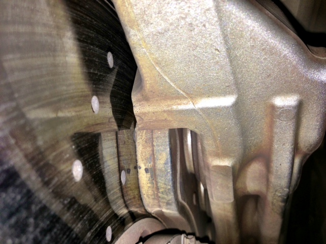

Thanks for all the replies....very helpful.
Here is a pic of the current state of my brake pads.....any thoughts here from you guys on how much life is left on this set of pads? I'm guess its down to 40% but not sure. Any guesses?
Thanks!

Those pads look fine.
You can keep them untill the pad part (excluding backing plate) is 1/2 what it is now.
My guess is another 6-10K mi on those, depending on your driving conditions.
Another thing to keep in mind is that it's best to remove the wheel to view them from the top.
Then you can see if the inner pads are worn the same as the outer pads.

Thanks, Lunarx. Thats about what I was thinking too. Just FYI to others, thats with about 19K miles on the clock (14K in NYC, 5K in suburbia)...so i'll likely get 25-30K on my set of pads.
