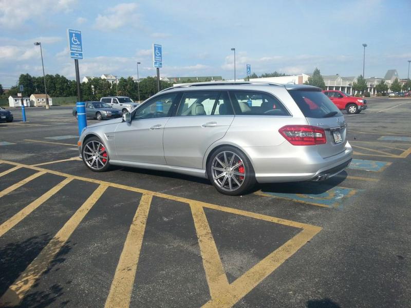

Really like my 2 month old to me Merc AMG Wagon
My main complaint is the ride over rough roads and there are a lot around here in Newport R.I, I live in Fla winters so I don't think it'll be a issue there. But man this car rides really brittle over bumpy roads, I've got the Conti tires on it now, maybe a softer tire might make it ride better? Any ideas? I was thinking about changing over to the Michelin Pilot Super Sports when these half worn Contis are done? would the car ride smoother over bumps with the Michelins, anybody tried this swap and any difference? I still can't get any answers on having the display show song titles and artists, other than that streaming works fine, the car can even show text messages which is cool. I guess I just won't worry about that because this car may never display info, I've tried everything I can think of with the car and the phone (android Galaxy 3). The car is looking great, just put a coat of Synthetic Wax on it the other night and really shining.
Attached Thumbnails Really like my 2 month old to me Merc AMG Wagon-s8egwofhvraacxfadin4moaubipl-7fqb6gbga8zmww.jpg

the Mich PSS come in 295 in rear, so u would have to go a touch wider....different opinions on whether our 9.5inch rears are ok with a 295

I'd think with the 295's it would ride a little bit better as there is a little more rubber on the sidewall as the tire is a little bit taller. That was kind of my plan in going to the 295's better traction and maybe better ride and I'd actually like the car a tad bit less low for getting in and out with my wheelchair as I'm a paraplegic. I've got the performance package on my car too like yours and the Distronic which I love as I drive with hand controls and it gives me a break from being on the controls all the time, great option for someone like me especially. I like this car so much better than the CTS-V I had before, it was a 2013, just did not like it and traded down a year and 20 grand more for this car, it was a good move, much more storage space in this car too as I play wheelchair tennis and lug around a couple extra tennis chairs in the back, even my handcycle fits in the back fine. Very practical car. I also have a VW Jetta Diesel for long trips to keep the miles down on this car and get 50 mpg, so good combo. The VW is not reading on the display streaming music either, maybe I've gotta get an iphone I guess, I know that would work.
