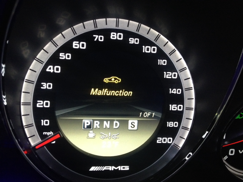

Just took of the 20s and put back stock wheels back because roads in NYC got so bad dont wanna screw up the wheels. I swap the wheels drive the car around my block and no issues. I let the car sit for two hrs and then go for a drive and this malfunction message pops up. Cant get rid off it. And advise what could be a problem here?

Take it to the shop most likely it is the air suspension in the rear...I replaced two in my 05 E500 4 matic wagon

either the pump, the bellows, or the shocks themselves....good think u are under warrenty
has the car sunk at all or is it sitting ok...

It is sitting fine

Reset it by unplugging negative from the battery for about one minute. See if that helps.

Just tried it. Still same

i've had same malfunction a couple times this winter. both times because the car was frozen. went away when the car was stored in the garage overnight.

Yes i am. I had the car in the garage for few days without driving it because of the crapy weather. I hope i have the same issue. Thanks

Better print out that pdf service bulletin that is around on here somewhere and take it with you to service. You sure don't want to wait until it sinks so much that wheel wells sit right on the wheels. I haven't had that message since I took it to service armed with that pdf. Yeah, they had to replace a bunch of parts, including the bellows.

I think the issue was the cold in NY. I didnt drive the car almost for a week. It was sitting in the cold garage. Today only in the morning the malfunction massage popped up but then after lunch i drove car all day and everything was fine but still going to a dealer tomorrow.
