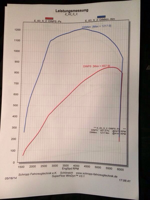

I wanted to share the outcome do GAD turbo upgrade for the 2014 E63S 4matic, I had this result for a little while never had the chance to come on MBW and post it this is the GAD stage 5, turbo, heat exchanger, fuel pump, gearbox and exhaust upgrade.
Good job to the guys there

jesus.....do the trans and differentials need upgrading with all this power?
is the graph saying there's 1200+ pound feet of torque???

The only numbers they have given me is 100-200km in 5.3 seconds with driver + passenger! the transmission and MCT are upgraded the differentials are good they don't need any upgrading.

Nice gains. Any upgrades to the engine ?
Numbers are 857Ps / 1217Nm = 844HP / 897 FT/LB

No upgrades on the engine and thanks for verifying the difference between PS and HP

What's the actual power at the wheels instead of the crank estimates?

I have no idea the guys in Germany prefer the superflow dyno and they go for crank power and I would also think that most WHP very and are estimates as well

HP and dyno numbers don't mean anything.
Post some verified vbox numbers/graphs of 60-130mph and 100-150mph.
Besides that, congrats! It's definitely fast if it ran in the 5's 100-200kph @ under 3% downhill slope.
