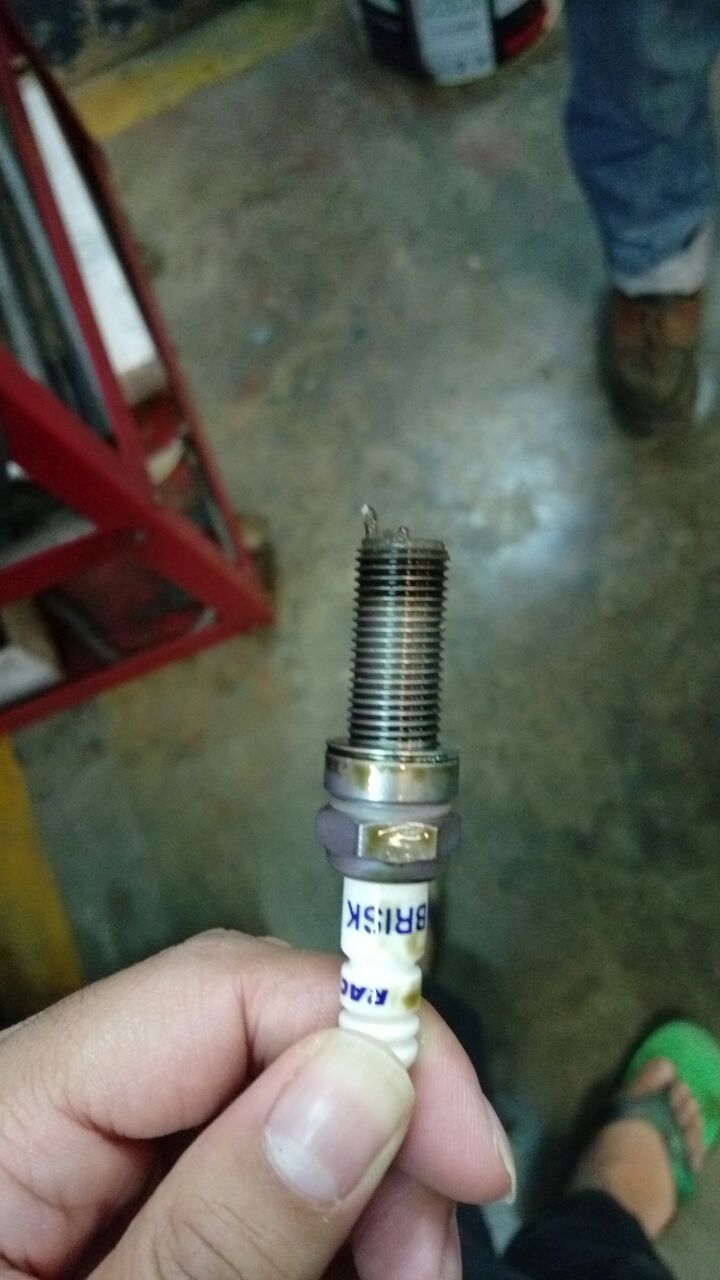

Just an update. I decided to try a set of Brisk Mr12s non projected tip plug here they are compared to a stock plug. Thread reach and body are a perfect fit, only difference being the non projected tip. The reason for this is a shorter ground electrode has less distance to pull heat out, and the tip doesn;t become a glowing ember out in the combustion chambers during high boost. Note the difference in center electrode. These babies should be damn near impossible to blow out under load. My only question is part throttle/idle behaviour where projected tips are usually better. Only one way to find out, installing this coming weekend and I'll report back.
Curious how the Brisk MR12S are doing for you? Was having all the issues mentioned in this thread, troubleshot based on experience with other platforms since I don't have anything to read codes... Interestingly, many of these symptoms are similar to other component issues so spark plugs didn't occur to me until it was a "duh!" on my part. Have a Renntech kit with stock plugs per their recommendation (they stated same reasons listed in this thread but I thought odd since generally went against common practice on any other platform). Right around 15k miles I started seeing symptoms, periodic limp mode right after WOT pulls, etc. Guess I missed that part of their recommendation.
Seems Brisk MR12S would be great on a Renntech platform if running decent boost. I have these on a very different platform running over 2.5 bar boost- been performing great. What does Renntech run in their kit (stage 3 I think)? Something like 1.5 bar? I never asked...

i used Brisk plugs on my engine
it is a ****ed up plugs
it ****ed up my engine
and when i send them and email them they didn't answer me mail
guys becarfull from using this plugs

Originally Posted by mjd222
hi
what happened to the engine?

The broken tip came of the engine no problem
But it Hits the fins off the turbo when it was came out the engine
The turbo is F to the bones
