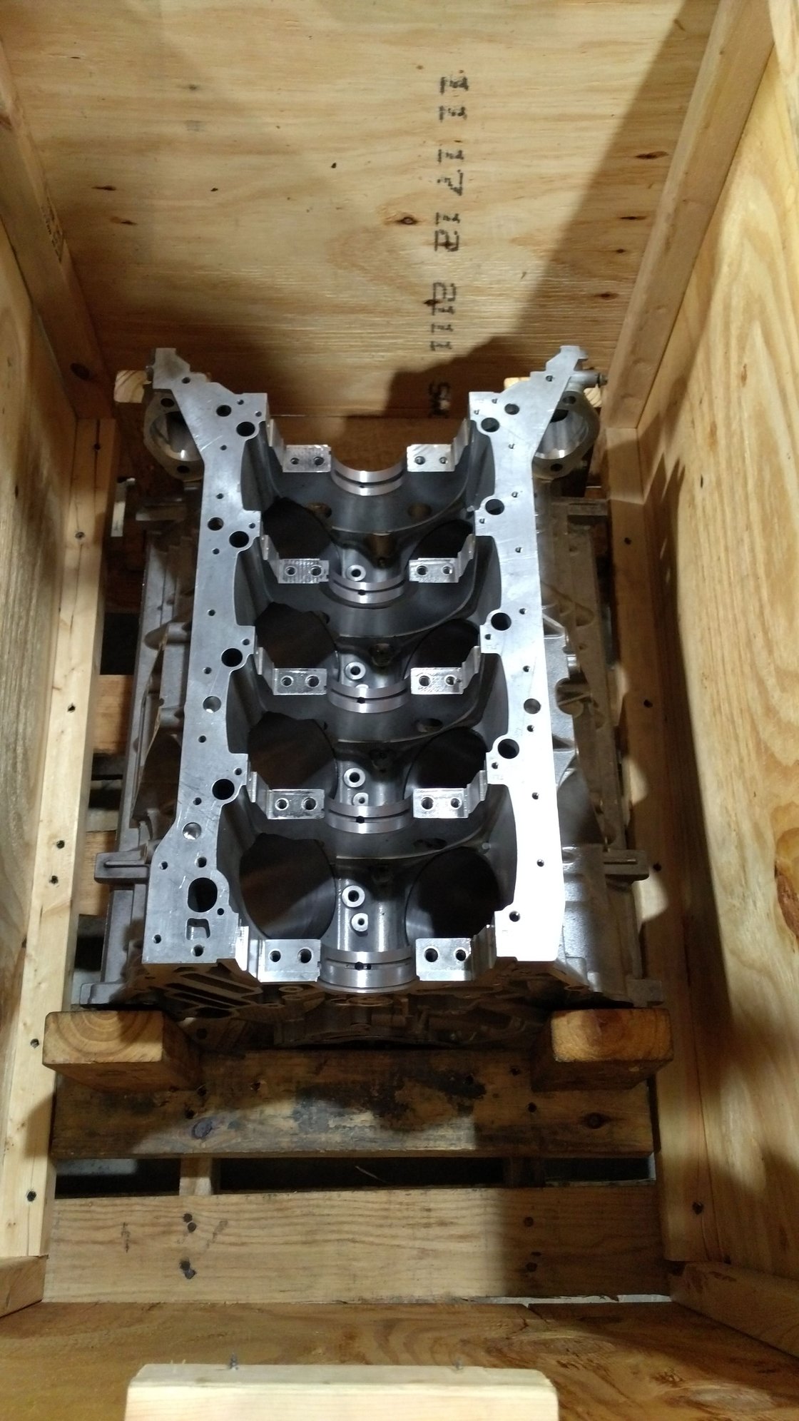

Yes, It is true I have Kleemann K4 package and I am pretty satisfied with it. I have 2 cars CLS63 and E63. I blew up one of the engines in search of cheap tuning from different suppliers. That was my first M157 ) My suggestion and advice: always go with one tuner for everything.
I was really curious about the W4 kit so I gave it a try. I have rebuilt one of the engines with the following setup:
Darton MID Sleeves
Wiseco Forged Pistons
Crower Rods
ARP Studs and Rod Bolts
Porting And Polishing of Headers
Some pictures attached...
Target: 1000+ HP
ARP Main Studs
Darton MID Sleeves
Set of Wiseco Forged Pistons
Package Received Last Week
Ported Headers
Polished Headers
Ported Headers
Ported Headers
New Gaskets, O-Rings, etc...
E63 AMG on CLK lightweight forged wheels and Hoosier DRs (Branded with Sponsor stickers)
E63 AMG This years Sema Drag Racing Finals at Rustavi International Motorpark, Georgia
CLS63 on MOMO 18 Inch Wheels and Hoosier DRs
Kleemann Custom Intake
Kleemann K4 - 98 RON Fuel (This is US93 Octane)
Darton MID Sleeves
Kleemann K4
Sleeved and Honed Block M157
Crower Rods & ARP Fasteners
ARP Bolts
and finally my dreamed W4 kit ordered in October 2015 )

822 whp on a dyno dynamics - nice!!! thats the cls63 right? the E63 is going to be the W4 kit?
what did the 882whp setup run at the dragstrip?

Goletiani- That's an amazing build. Can you share some of the specs on the bottom end components. Were the rods and pistons custom, or do you have part numbers you can share? Same for the Darton sleeves, custom or part number available?

And at the end of the day, the stronger better bottom end that exceeds the limits of nano/twin arc spray etc etc etc is Darton sleeves, good forged pistons and connecting rods.
No different from the old Murican/domestic engine builds
