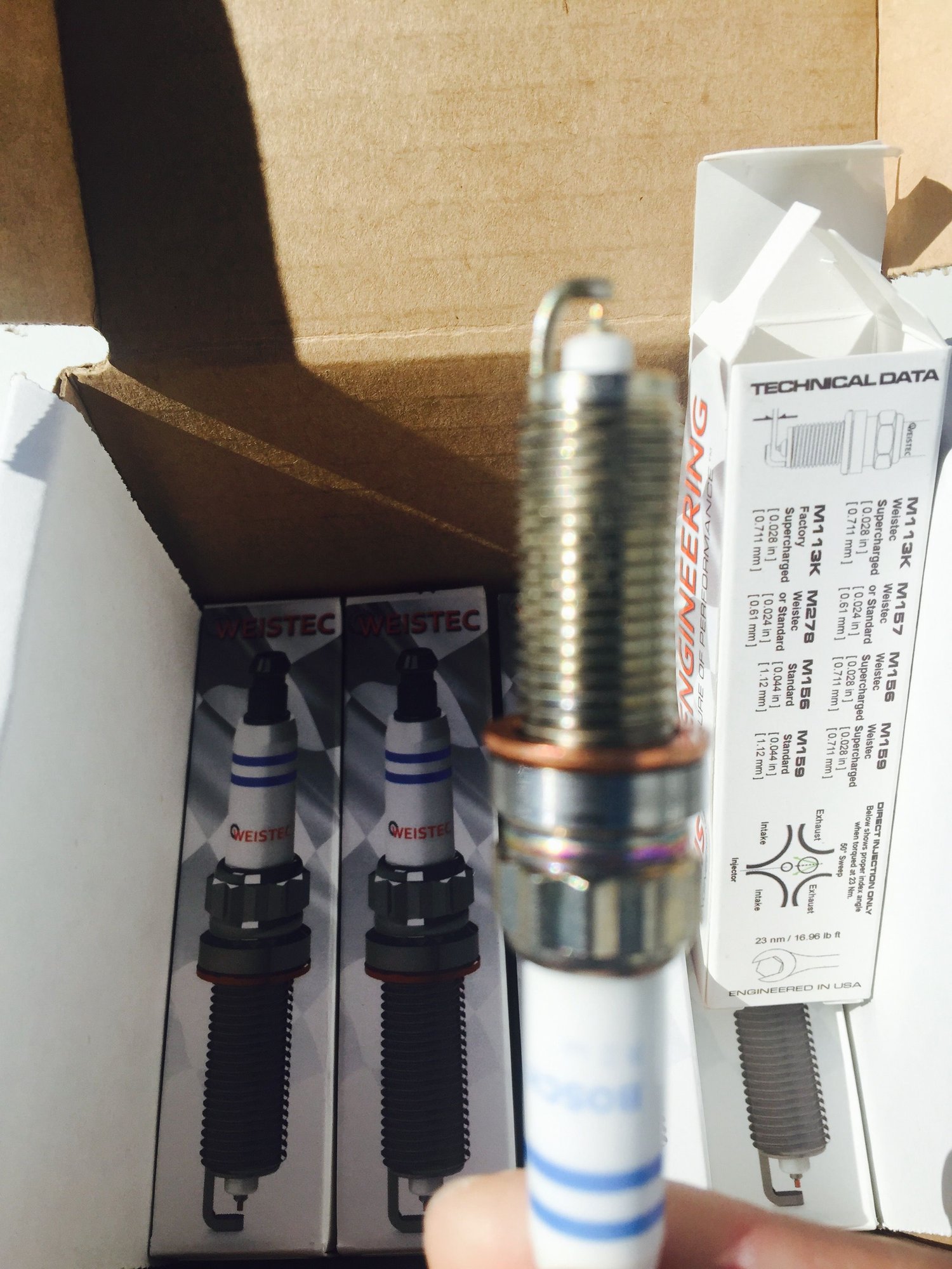

So I visited the new facility for their spark plugs in which I am getting the B service ( 40,000 ) miles, but I only have 19,000 miles, LSD, Transmission and Brake services and must say they have a pretty nice setup.

Can you post a pic without the cardboard cover?

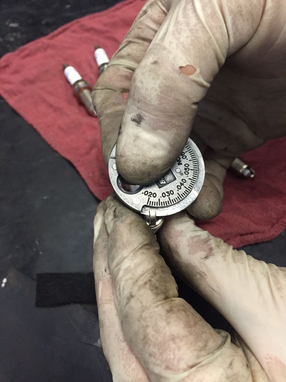

Here you go: Sorry for the iPhone photos.

Hmm, projected tip iridium's. Not my first choice, but close up the gap and will be fine I'm sure...at least for a while.

Would you mind what you mean by closing up the gap? These are pregaped as what I was told for the M157? Are you saying use OEM pregaped specs.?
Many thanks.
Anything that says pre gapped should always be checked. Not sure what weistec sets them to, but I'd run them at .022.

Thank you. Is .022 factory spec? Tune spec or base off experience?
No. .022 is a reasonably tight gap for high boost applications. Oems usually .032ish.

Interesting...Bosch plugs huh? What is the part numbers on the plugs?

Thank you. Just asked my SA to gap it at .022. Hope with all the services I am getting done, my car will drive like its on butter.
I actual only had 6,000 on my Renntech spark plugs, but figured since Im getting everything else service at the 50% discount, might as well change new plugs.

http://weistec.com/spark-plug-set-m157-m278.html

looks like on the weistec box they have them at .024 for the m157

Back to the drawing board for me. I think the Weistec is the Bosch version of the NGKs used by Renntech in the past.

Oaky. Gapped the new plugs at .022 instead of .024 which is what they gapped it at will help.

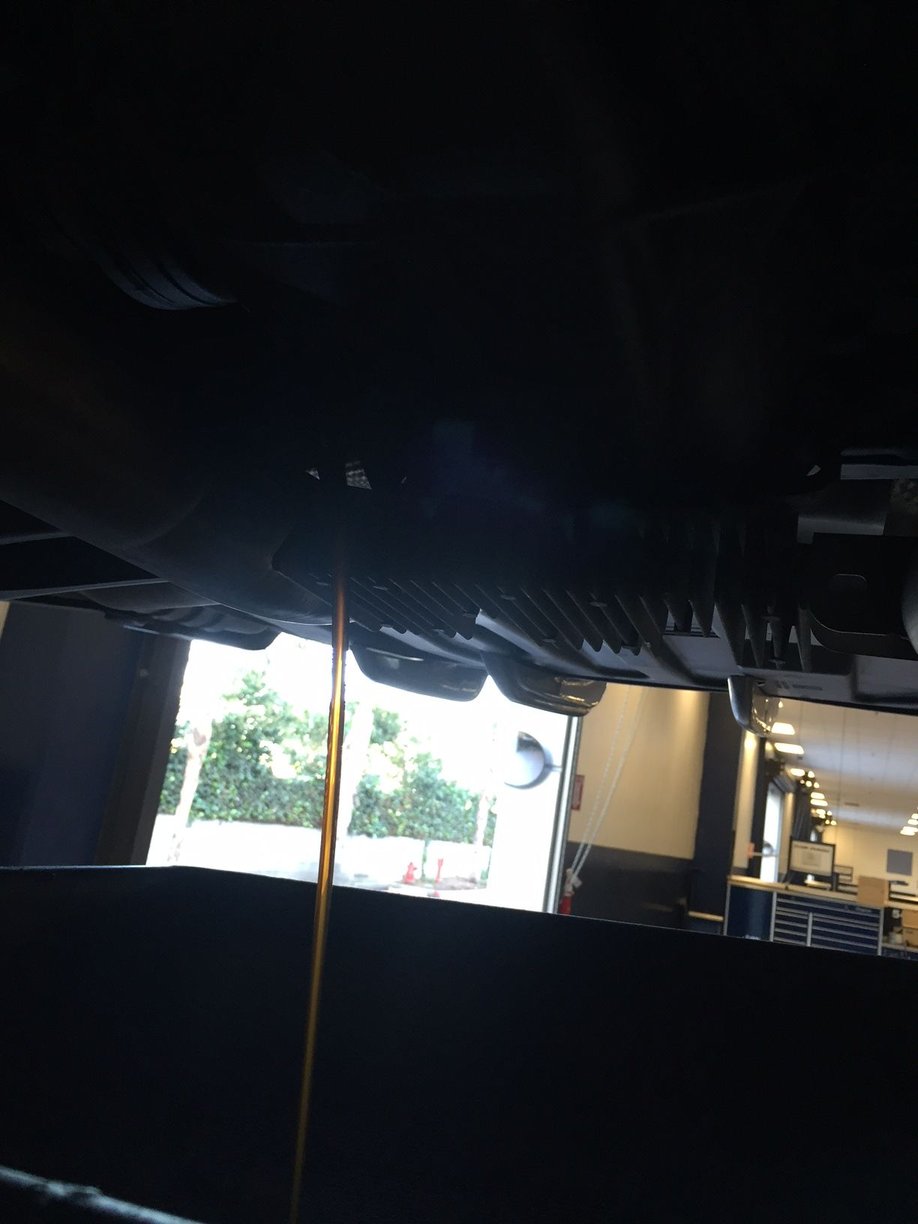

LSP getting flushed.
