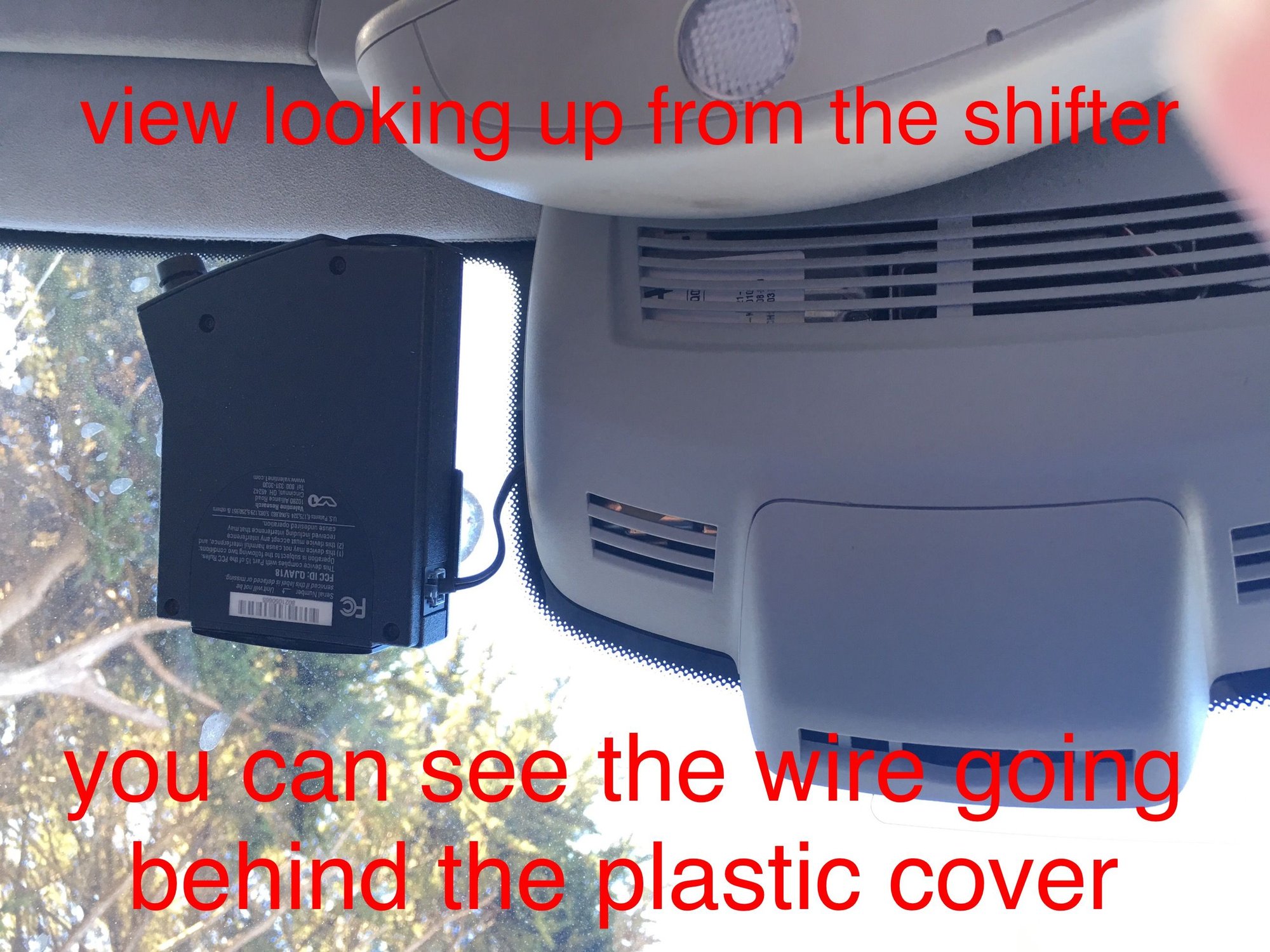

I'm new here and couldn't find any DIY instructions for hardwiring a radar detector without running the wires down the pillars to the fuse box.
I wanted as short of a wire as possible to minimize rattles and ease of removing for any warranty reasons.
This provides switched power (key on, radar on. Key off, radar off).

Nice job! I wouldn't mind a short written description to go with this, specifically the wires you spliced in to. Thanks!

only thing is, i know from mounting the valentine on the car that the position you have it at sort of blocks the view to the rear somewhat (for the rear facing antenna). i don't know if it actually makes a huge difference but i just remember having it that high up doesn't give it a clear view looking out to the rear.
at least it's a valentine and not less good other one (every other detector that isn't the valentine).

From the up-close photo of the plug where the wires are pushed in, it looks like the plug has 4 openings. It looks like one wire goes into the slot on the frontal passenger side of that plug. The other wire goes into the slot on the rear driver side of that plug. Is that right?
yah, that's what I wanna know too. also which one is negative and which one is positive. cuz you know, my polarity tester is broke.
