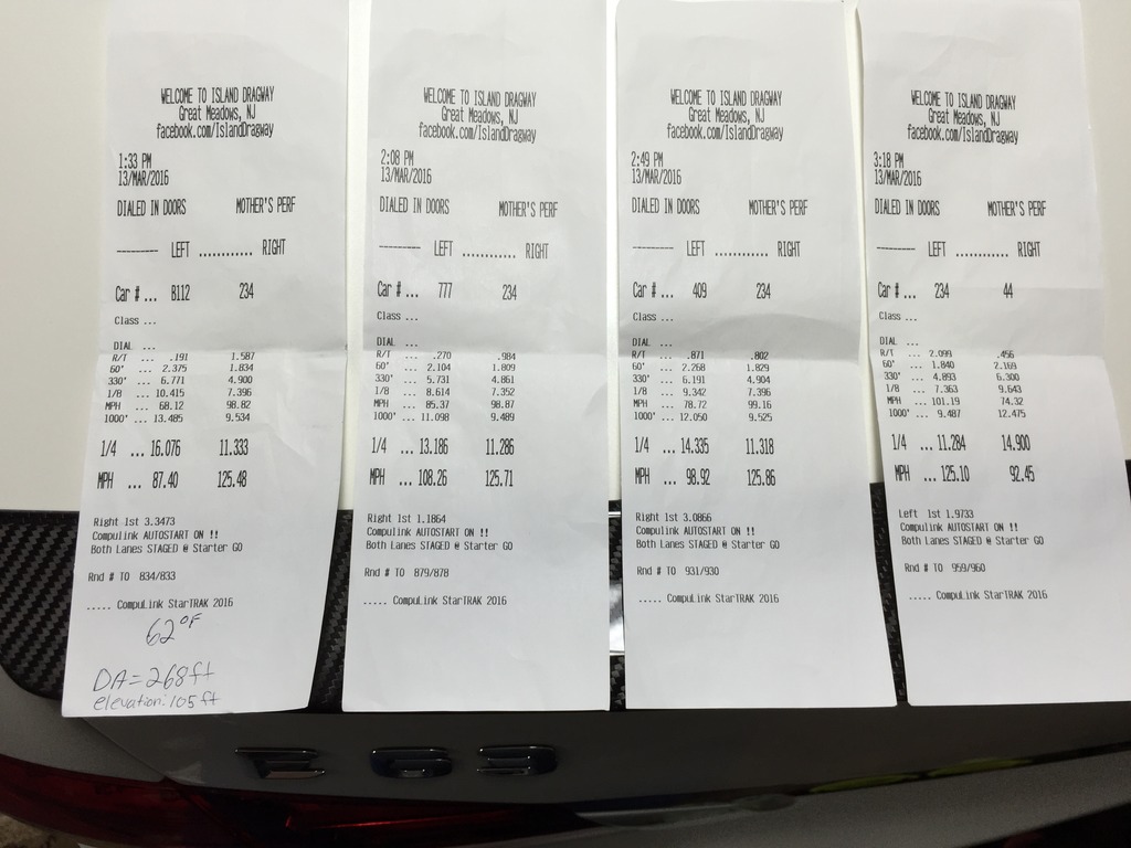

My mods are websites tune, weistec filters, weistec plugs, ams catless downpipes.
Fuel used was 93/100pump mix that I think was old 100 octane here in(Long Island, ny)
Ambient temp: 62
Da: +268ft
track elevation: 105ft
Full interior
Gas level was inbetween half tank and a 1/4 tank.
Times ran:
93/100 pump gas mixture
11.33 @ 125.48. 60' was 1.834(brake boosted launch at 2k rpm)
11.28 @ 125.71. 60' was 1.809(race start)
11.31 @ 125.86. 60' was 1.829(race start)
11.28 @ 125.10. 60' was 1.840(race start)
Video of 3 of the 4 runs.
Time slips:
Weistec 1/4 16' e63s-5e1604f0-68e0-43f9-8d92-be1d59439989.jpg

That's impressive!! Nice runs and nice consistency
Interesting how everyone's experience with race start is a bit different at the track
How do you think you did... What are your thoughts on the times considering your investment in mods

Well I'm a bit disappointed. Thought if see an easy 11.0/11.1(for sure) considering some run that with tune only. But I had a bit much gas in the tank for that. And I'm convinced my 100 octane station had **** fuel.

I hear ya
You had ideal elevation and temps are ok... The weight of the gas shouldn't have given you 0.3
I have seen a guy with a rebellion piggyback tune ran 11.25 and he ran 11.5 stock both runs on pump gas
Every car is different in how it launches

Good consistent runs. Trap speeds leave a lot to be desired.
Looks like the second Weistec E63 with traps in the mid 120s mph

I made a mistake. Track elevation was +515ft. Not 102ft I said earlier in the first post. That's why my times were hurting a little. I'll retry at Atco within the next two months when we get a track rental.
I heard these cars like hot lapping. And to launch and get a 1.6 60' you turn traction fully off and brake boost 2.5k for the launch

your DA was 836 ft for that day and weather, not great but also not a DA that is going to totally kill your times.(see calculator results below).. I think not turning traction control off would be more the issue with your times, but i still would of expected a little more mph on your runs given your mods
DA calcuator :
Correct your ET and MPH using the DA (Beta Testing)
Density Altitude: 836feet above sea level
1/4 mile ET: 11.284
seconds
1/4 mile trap speed:125.10
MPH
DA adjusted results:
Stock and Mildly Modified Naturally Aspirated Engines
11.195 @ 126.076 MPH
Extensively Modified Naturally Aspirated Engines
11.268 @ 125.45 MPH
Extensively Modified Supercharged and Turbocharged Engines
11.271 @ 125.252 MPH

125mph is not that great when the average should be 127-129mph. Maybe traction control killed it for you
