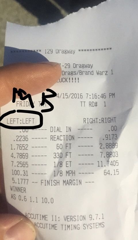

The slip at the beginning , 1/8 mile , 7.2 /100 mph

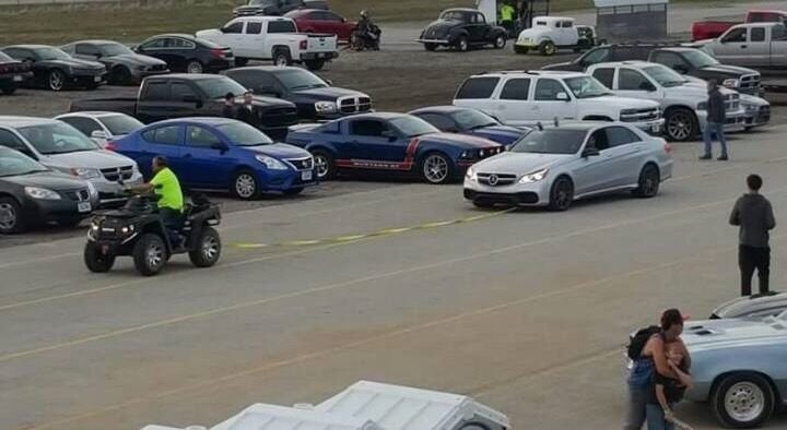

what i want to know is did anyone report the kidnapping going off in the righthand side of this ^^ pic? dude is rear-naked choking the ginger kid and running off with the kid while everyone else is watching a scooter pull a mercedes!
