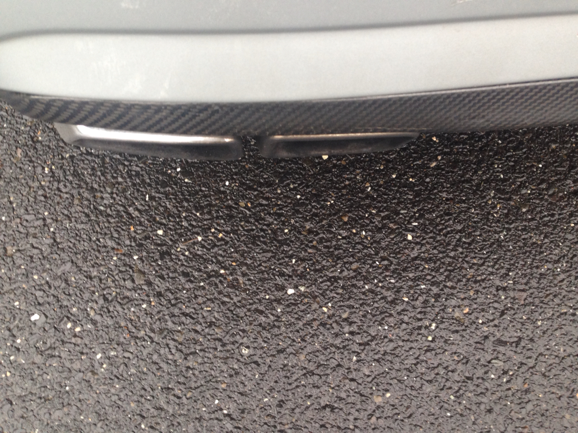

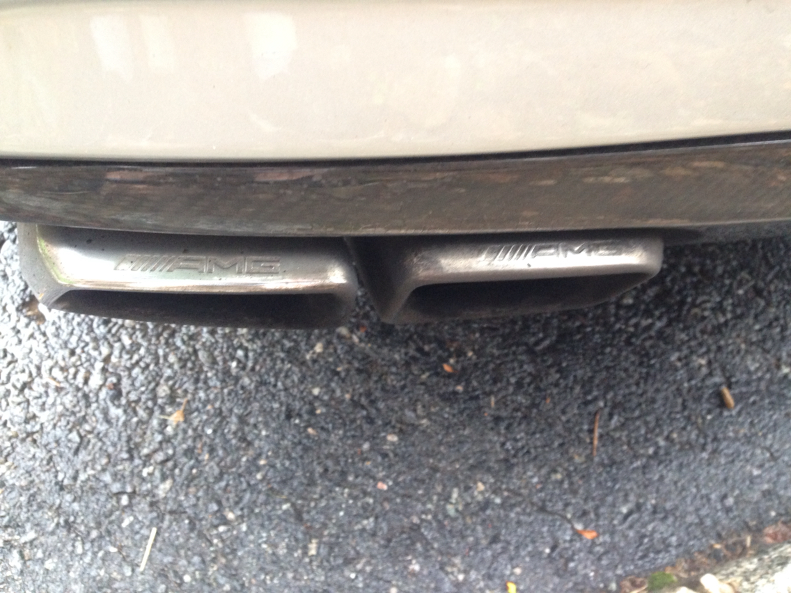

The other day I saw my exhaust all the way in when u can't see the the amg and when it's hot u can see the amg sing it's really drving me crazy I can't figure it out.....
Pic one when it's cold and pic two it's when it's cold ...

Thermal expansion. It grows in length when hot

Is any way I came make it come out when it's cold

You can have an exhaust shop lengthen the post catalytic section so that it's always out

Yeah this annoys me because it looks nicer when it's outwards slightly and you can see the AMG embossed tips. However when parked up, they shrivel up and on my car, I can barely see the tips.
The only solution is to extend the tips by 1cm...but this then means they'll extend by an extra 1cm when hot too. However I think 1cm extra will still look ok. Any more and it might look slightly odd with the extension being too much.
