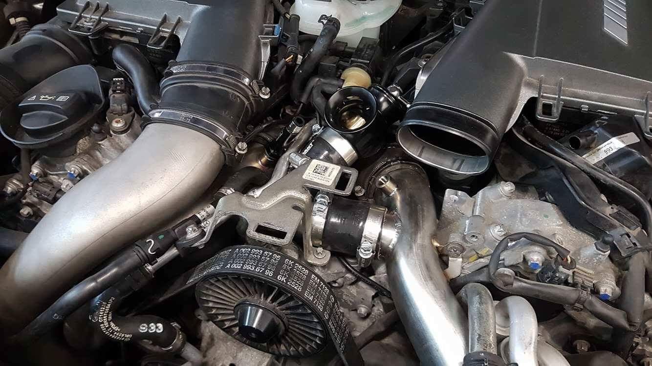

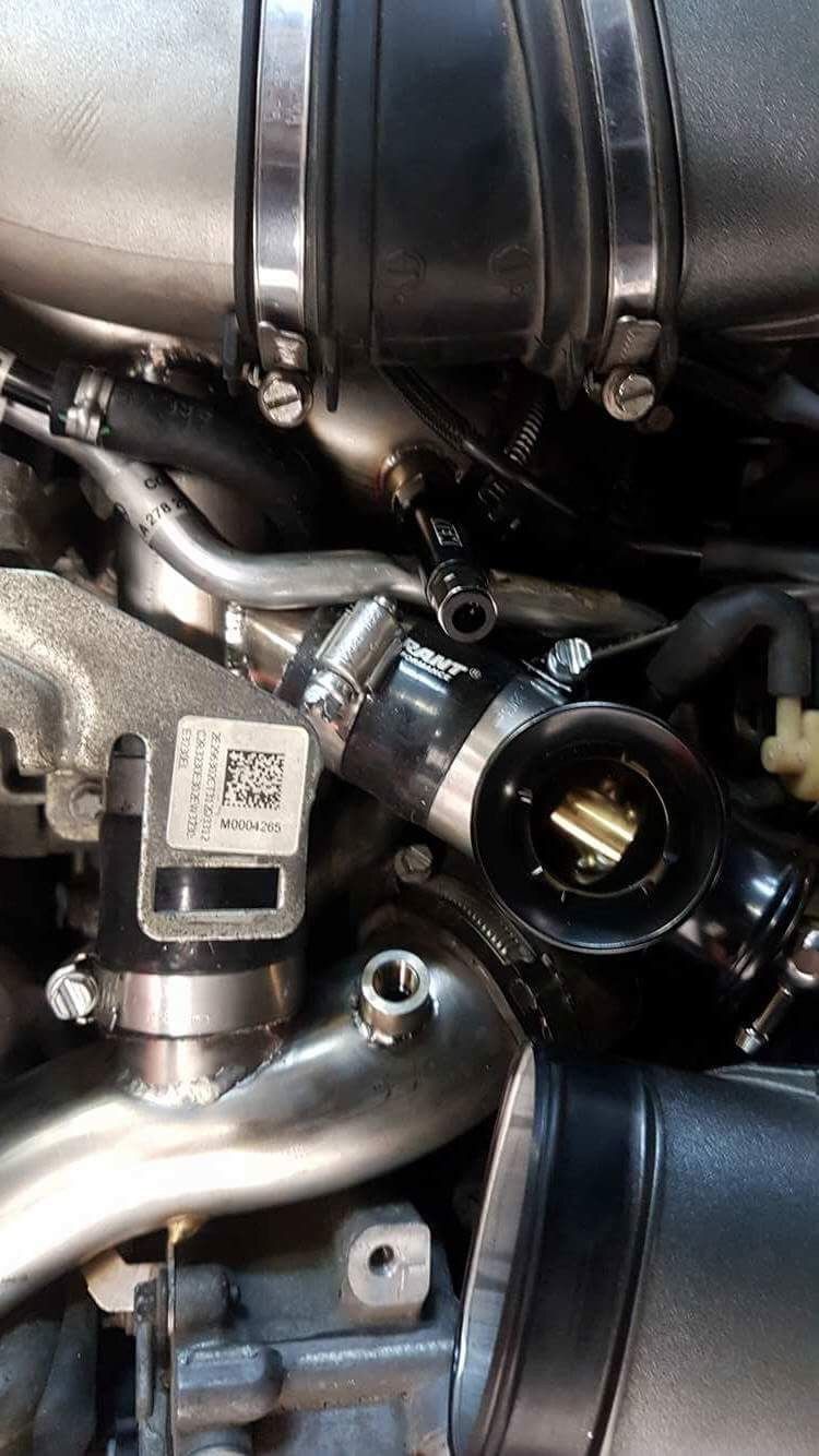

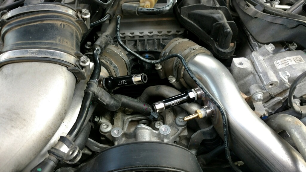

Just few picture of my new bov set up and watermeth set up ... more picture when the watermeth set up is going to be finish ....

Its not for the sound its to be sure the turbos doesnt surge and safe the turbos at long term ....

I was going to do the same thing! Who did the work? I'm not comfort running high boost from stage 2 turbos without additional venting to reduce pressure spikes and compressor surge. Can you tell me how much that cost and would they do another set?

What are the black little AEM things?

Injectors for the meth/water mixture

If you made custom one you have to do Vacuum/Boost Adapter because the only place he have vacuum is in the map sensor you have to machined an adapter ...

Are you running rich? Usually when you add atmosphere bov the computer needs to know the air left the motor to keep the injectors from trying to over compensate . Not really a horrible thing . But you may foul plugs. Lmk how it is . Looks awesome. Also you should consider doing pre turbo injection. It's deff more beneficial then shooting through the intercooler. I've done tons of test. Pre intercooler injection yields the least gains and you will get puddling

That's only an issue on MAF cars. M157 use speed/density strategies. If you have the right spring in it, it is closed at idle and only vents on boost transition to vacuum on decel.
As for nozzle location, I tend to agree that pre intercooler in the V seems counter productive. I think that weistec and others were just trying to do creative packaging when they put it there. I was thinking post TB on the Intake manifold as it makes the 180 transition, but not sure that will be picked up by the IAT sensor. If going direct into the IM , you need a solenoid based system to avoid potential leak issues. Ideally I think pre-turbo Plus direct in the IM would yield most benefits.
