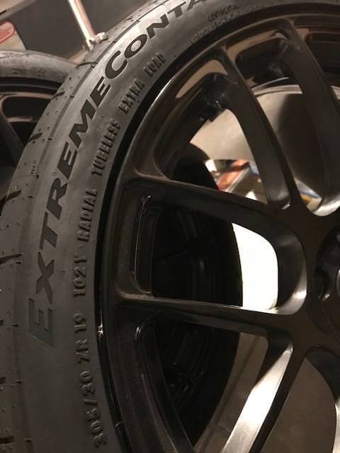

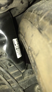

Ok. Did the 275/35/19 up front thing I was yapping about. This is what it looks like.
Another terrible pic
How close is this dirty tire to the strut?...
I think there is about 3-4mm's
The Front wheel specs are 9.5x19 ET35 + 3mm spacer (effectively +32 offset to clear tire from strut) So far the car drives pretty well with this set up in stock height (I always drive in S). I hope this bit of info can help someone who is wondering about the same.
Nice work. I test fit my rears with 12mm spacers and with that I thought that a 9.5" ET40 would be needed but surprised that 9.5" ET32 is.
V cool to see W212 owners pushing boundaries and fitting wide tires on these heavy pigs.Originally Posted by Rehabguy
Ok. Did the 275/35/19 up front thing I was yapping about. How close is this dirty tire to the strut?...
That said I think 265/35R19 would be a better fit esthetically and it is also a good O.D. match for a 295/30R19 rear. With the 275 front I would want the height of a 305/30R19 out back and that would be a difficult size to fit. What size are you running on the rear?
FWIW I tried the stock 19x9" et37 + 10mm spacer (effective et 27) and it rubbed at full compression on my 4Matic E63.

Rear rubber
This is how close it sits to strut... Plenty of room... seemingly...

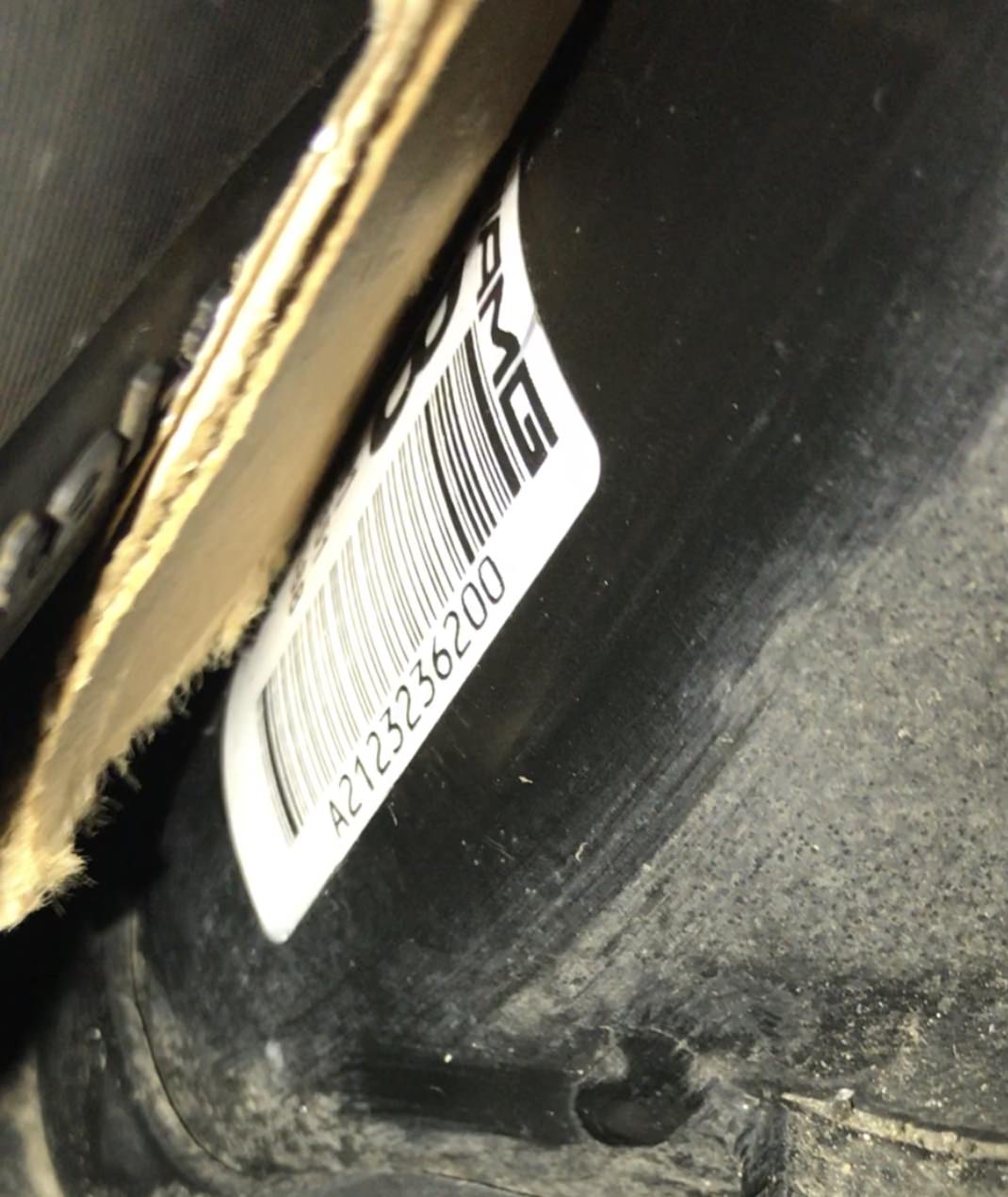

However, this is how close the rear sits to the body/ liner
With the stock wheel + 10mm spacer you must have rubbed on the fender, right? With my current set up the rim protection lip on the tire does sit a mm or two past the fender. So far I have driven over speed bumps at 5-10 mph and driven outta my driveway at full lock and all seems fine (knock on wood).
