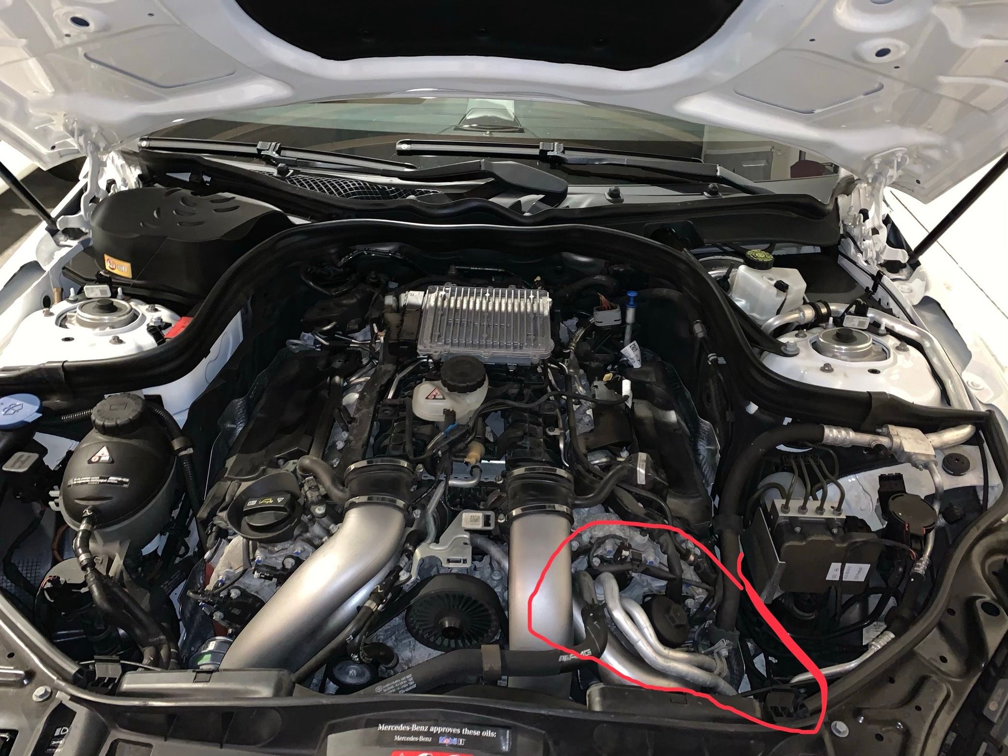

Anyone have diy step by step install on the Renntech Diverter Valve?
what are these 2 pipes that are in the way of the diverter pipe?
would fluids spill out if they are disconnected?

Those are the oil cooler lines.. Some oil will spill out if removed, and you will have to replace the 1 O-ring in each line when you re-attached those 2 lines.
I would contact Renntech to get their set by step instructions that comes with the kit.

What did you conclude to get the pipe over the rubber on the turbo side?
Reply 0
Nov 4, 2019 | 08:42 PM
  #49
I watched some other turbo videos and I ended up using petroleum jelly and a lot of it. I also saw it one of Tasks Maschatos videos. Also I didn't remove any of the oil lines to install it.
