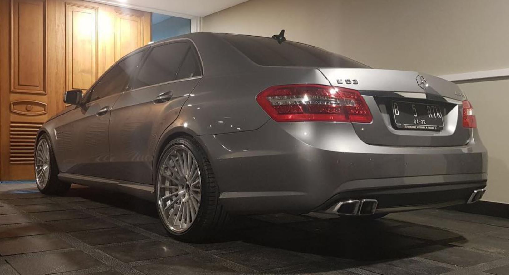

thanks for all the feedback! since the previous setup was near impossible for the rear, i've decided to go with a 20 inch setup, with the following specs:
20 x 9 et 30
20 x 10 et 35
feedback on this setup is highly appreciated! from what i've been reading around, this setup should work fine. now I'm thinking about what tire setup to run. so feedback on tire setup is also welcome!

You are right this will work, but once again you are pushing it in the rear. You may need to camber your tires more (tire wear) and go smaller tires. The question is why????
EDIT, on second thoughts the rear will still not work IMO

just had the wheels installed along with the tires; fitment is SPOT ON. the rears are fairly aggressive. With 2 passengers in the car, no rubbing whatsoever. Have yet to try it with 4 passengers. Went with a 245/35/20 and 275/30/20 tire setup. I'm super happy with how the look turned out. car is not lowered, but i believe it should be good running on lowering springs. something to consider further down the road.
Reply 0
Mar 14, 2018 | 09:14 AM
Looks good! I guess wheel offset is highly dependent on what size tire you want to/willing to run to make it all work.

You sure that thing does not rub?

Quote: You sure that thing does not rub?
none whatsoever
