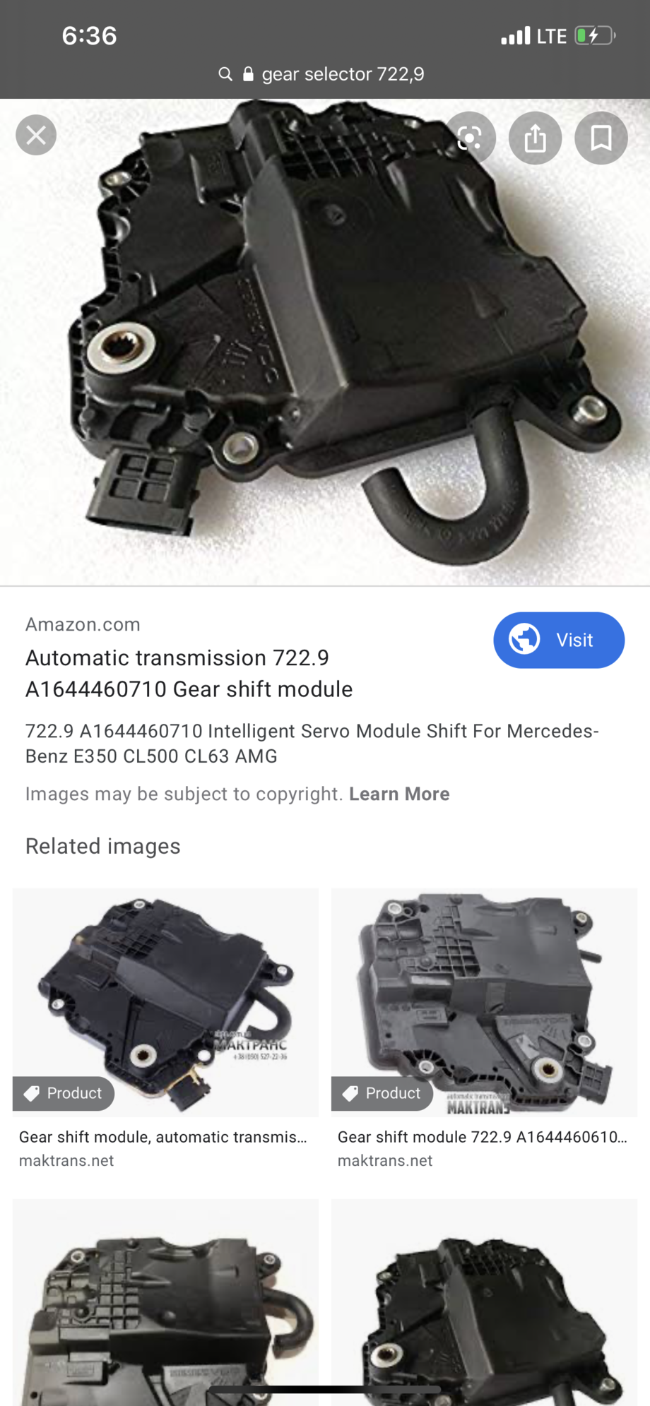

For your second issue this part could be going bad.
Id look in to replacing it.

Had exactly the same #2 issue and had this automatic gear shift module replaced.
