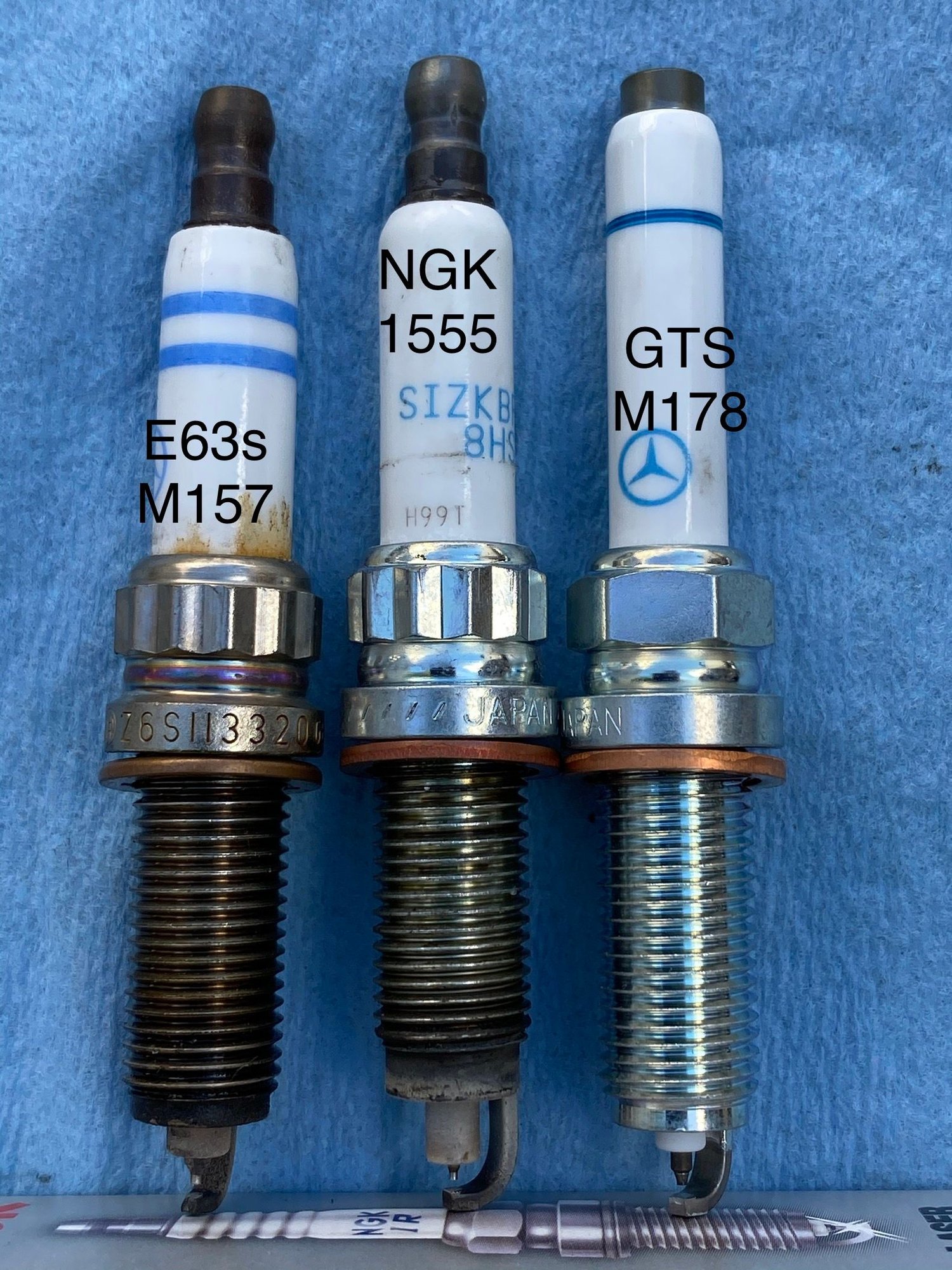

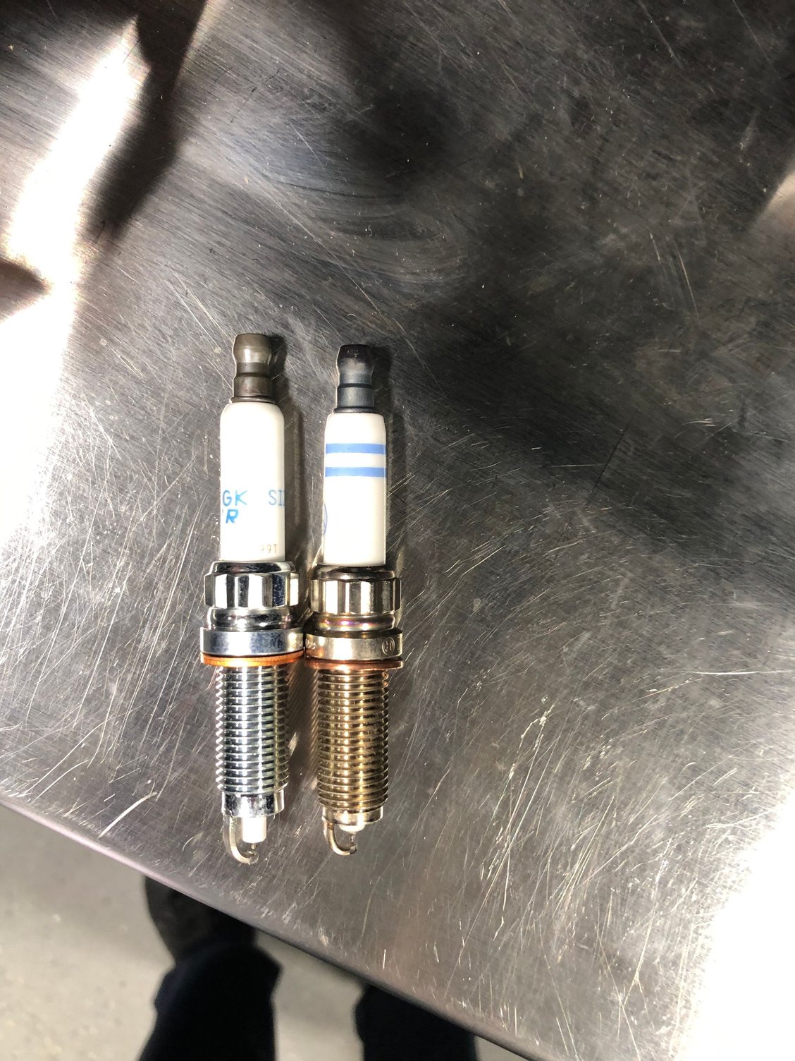

Side by side view of MB OEM plug and NGK 1555 plug
for those interested here’s a side by side view of stock MB OEM plug (heat range 6) with 8k miles and the NGK 1555 plug (heat range 8).
As you can see they’re very similar size and dimension to OEM (not identical) and from what I’m told by my MB tech buddy you can pretty much index properly with spec 23 NM and using a line to guide on your socket.

Originally Posted by jvakos
thanks SAMz - would be great to see pics of the NGK 1555 vs MB OEM vs GTS plus and see how they compare size wise and how that factors into correctly indexing them. Appreciate all your feedback bud!
J
Typo on the images below. Its M177 not M178
The M177 plugs are slightly narrower than the M157 and NGK plugs, the boot still grabs it just not as firm as the OEM ones, so I just wrapped one roll of electric tape around them for a snugger fit, even though I doubt its needed since the coil is held by two screws that keeps them from moving, I just wanted an oem like fit.

Looks like a recipe for disaster. I hope not for your sake
how so?

Originally Posted by SAMzE63s
how so?
Proper indexing.
The factory 157(278/276) plugs index via different thickness copper washers at the specified install torque (23nm). The different thickness washers compensate for minor production variations. The 178 plug washers are significantly thicker in those pics and the coil end is completely different. Coming from almost 20 years of MB experience these engines WILL melt down if not indexed properly. There is a built in tolerance of 45° in relation to the injector but I wouldn't risk catastrophic failure if it were me, or my customers. That doesn't mean don't mod, but I don't buy into aftermarket plug swaps on these engines...I've seen them go horribly wrong.
My personal s63 coupe has the eurocharged stage 2 tune with OEM plugs gapped to .022 and runs like a champ.
Proper indexing.
TECHNICIAN - great feedback thanks.
Question, should an experienced MB master tech (not just any MB tech...) be able to properly index a 1 step colder NGK plug (1555's are what some use for m157) for stage 2 tuned cars as a option to help reduce misfires since they colder than the OEM plugs ??? i get that the aftermarket plugs arent 100% exact same size as OEM but have heard an experienced MB tech should be able to properly index those in cases with stage 2 tuned M157 motors.
