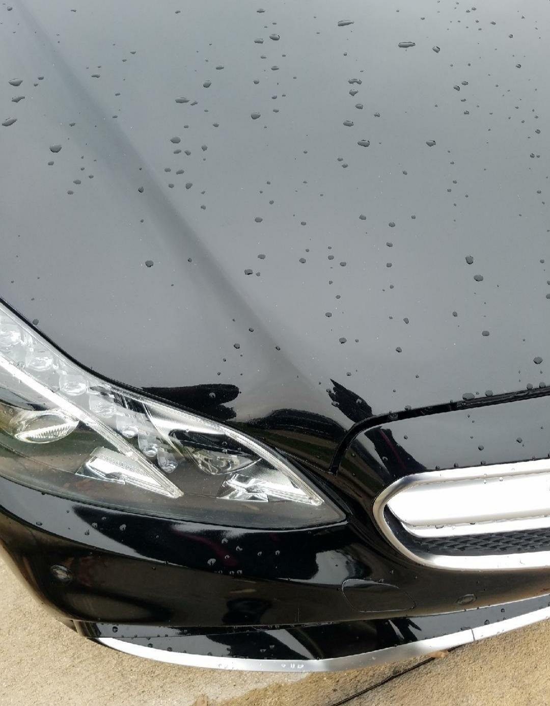

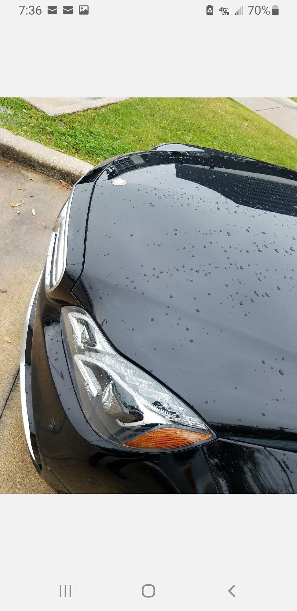

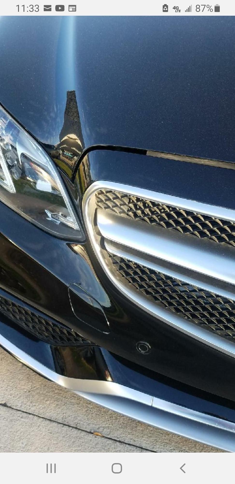

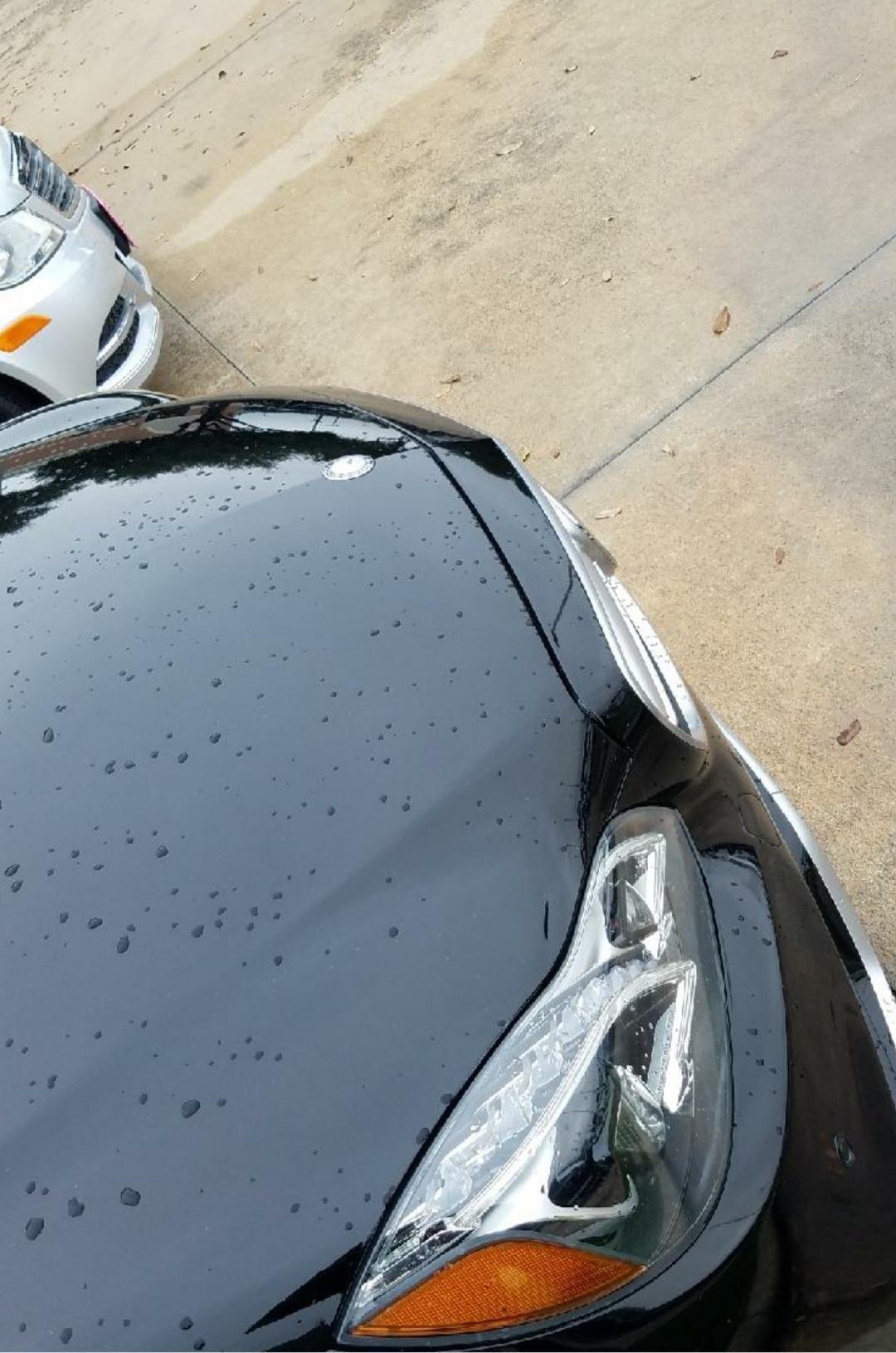

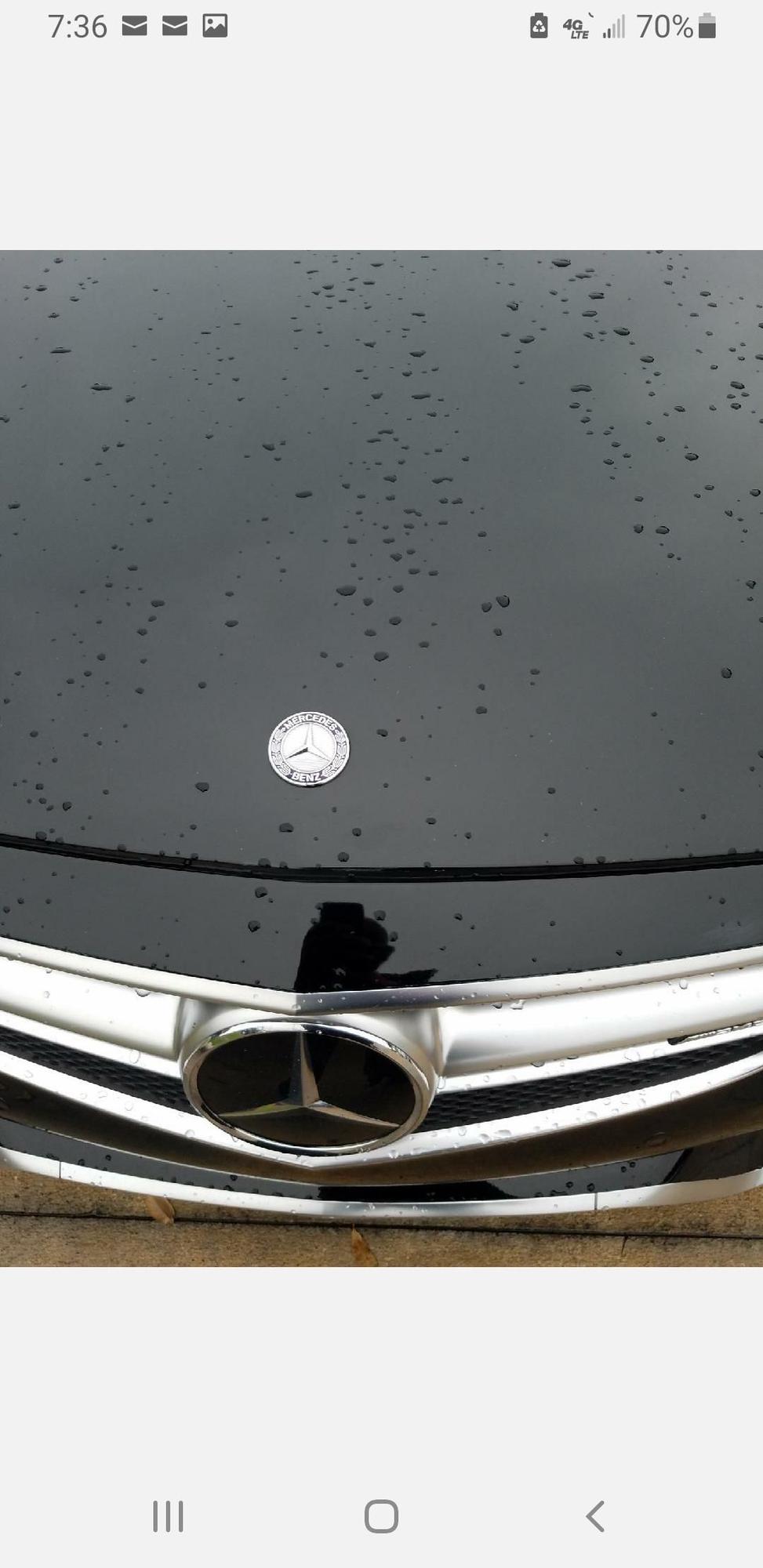

Hey guys i've been on a long & extensive search for a 14-16 E63S. I finally found one, unfortunately it would be a sight unseen purchase as its about 1500mi away . Now it is a cpo vehicle which is some insurance as far as a major paintwork etc. goes(hopefully they meet some kind of criteria) , but after seeing some of the stuff that has slipped by during the cpo process with others it leaves me uneasy . Considering a 3rd party inspector such as lemon squad just because.. Has anyone had experience with their amg vehicles sight unseen , did you utilize any other 3rd party inspectors ?
Said vehicle all checks out except for one thing I caught in the pictures . The hood to the top of the front bumper gap looks larger then other 63's .Some of it could have just been the angle at which they were taken . I could be wrong & over analyzing. Radiator support & hood have proper labeling . Pictures attached of the hood if anyone can shed some insight - it would be greatly appreciated .

Where is the car and what does the carfax tells you? Make sure they send you the paint meter reading of each panel along with underneath of the vehicle for any rust issues? The certification process can have up to 2 painted panels before they even declare it to the customers and funny thing is, bumpers are not included in those 2 panels. So you can buy a certified vehicle with front bumper/hood and one of the front fenders painted and not even told about. Paint meter reading is a must.

Carfax clean all checks out , yes 100% on paint gauge if I decide to put a deposit on it . It spent a good part of its life in Texas..

I think that front hood/bumper gap is normal and the sun blasting straight down into the gap in that one picture makes it look abnormal. In the other pics, atleast to me it looks perfect.
As mentioned, buying site unseen will always be a gamble and a stressful situation. Sometimes the car exceeds your expectations and sometimes it disappoints. I’ve had both happen.

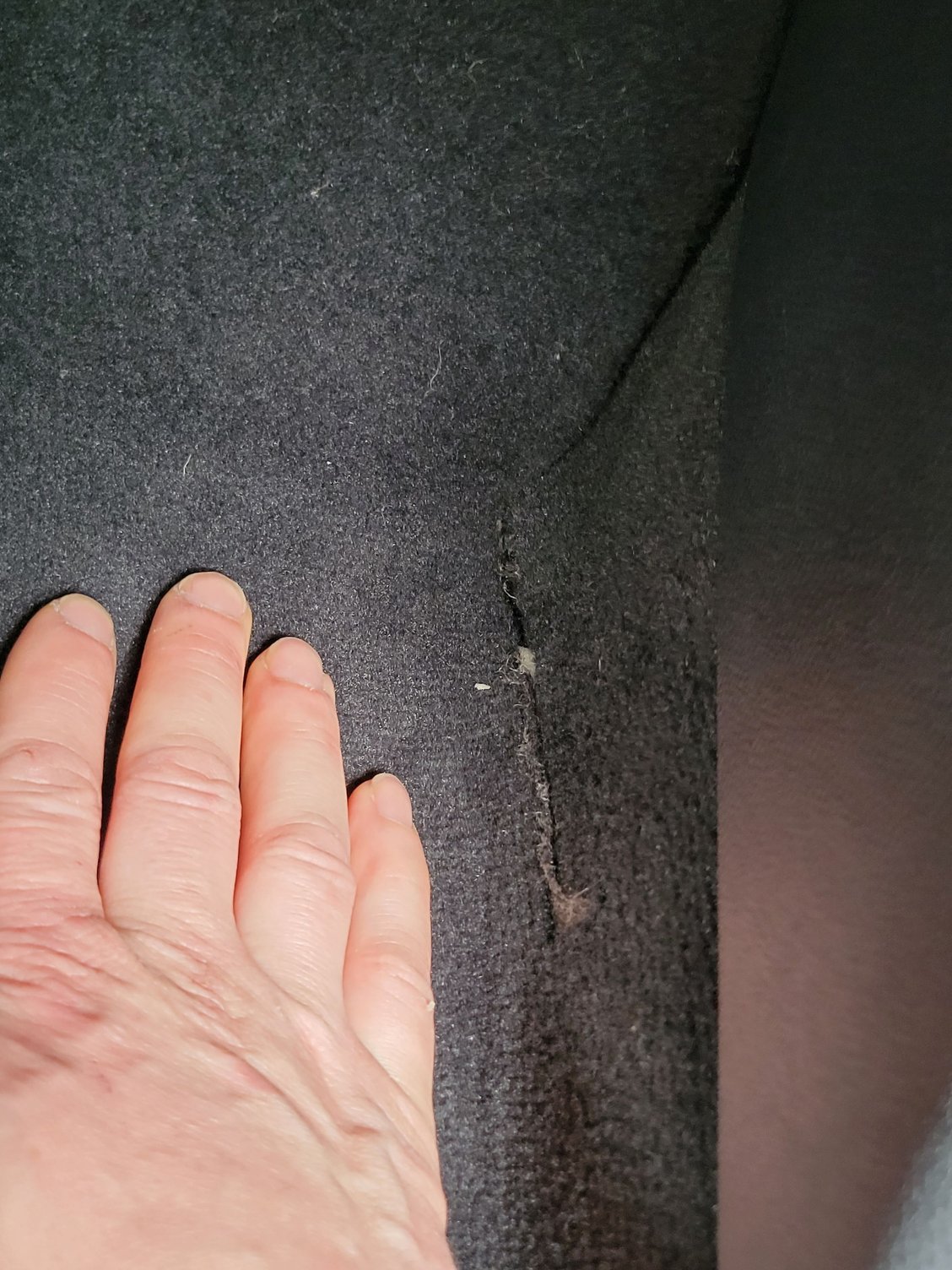

One other thing is there supposed to be slits in the corners of the carpet for ecu access on the passenger front footwell carpet ?both corners look like pic below

I don't think I've ever seen a cut carpet in the passenger footwell. I'll check mine, I don't think I've ever lifted up the floor mats
