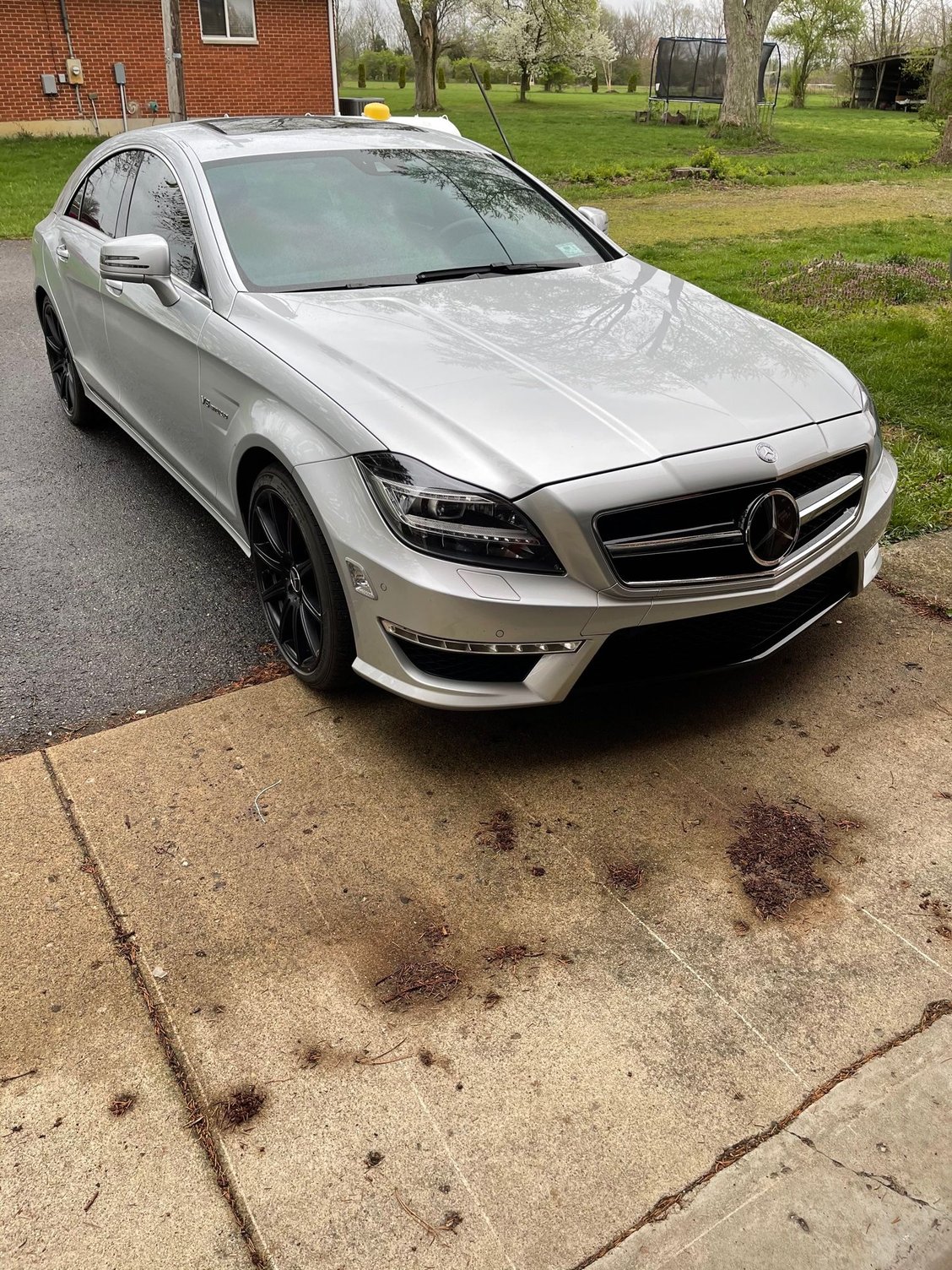

Since it has been raining in Ohio since I got it...... only a couple of pics. I have already done the EC Stage 2 as you know, UPD air filter spacers and filters, Android 10.25 inch head unit installed, and H&R wheel spacers (20mm rear and 15mm front). Thinking about lowering it a touch soon. Need to rip off front clear bra that is peeling a little. I don't like them anyway. Will probably end up with Black Boost sir intake since I hate how the UPD setup raises the carbon fiber panel above the ECU. ECU tune was the priority and I am very happy with it so far.
Happy to hear that the TCU flash fixed it for you. I actually talked to Matt about your issue while I was there. Luckily mine was fresh flashed before purchase, at least from what I was told...... fingers crossed.
