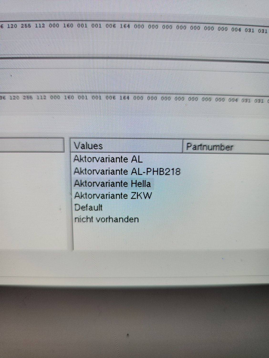

I actually had to replace the right headlight on my car. I replaced it with a new HELLA unit and replaced the ballast module too. When i followed this guide for activating ILS, all of the ECE ILS options were already enabled on this headlight. The last step, "VCD_Schrittmotorparameter_VLA" had different options than what the guide said to select. It says to change it to "aktorvariente hella haltestrom 1" but it is not an option for my headlight.
These are my options. I just left it on the default setting.
I noticed that ILS doesn't seem to be working on this headlight. The left headlight ILS works great. The right headlight seems to be doing its normal auto on/off high beam.
When there's an oncoming car it just turns high beam off. Same when following a car. the left headlight actually moves the high beam around vehicles. The right just turns high beam off entirely.

Quite confusing, first you asked how to enable SM as you already code the EU ILS. Now you tell something about a new headlight that's already coded as EU. If the headlight is EU model, so no SM present

Its a US model headlight but almost everything was coded EU already and it doesnt seem to be working with ILS. The photo i attatched is the option thats different from the guide. Should I have selected a different option?

The options can differ due to different Software versions between HLI's. I would choose an appropriate option somehow identical from left to right, if you can't install the same SW to both HLI's.
