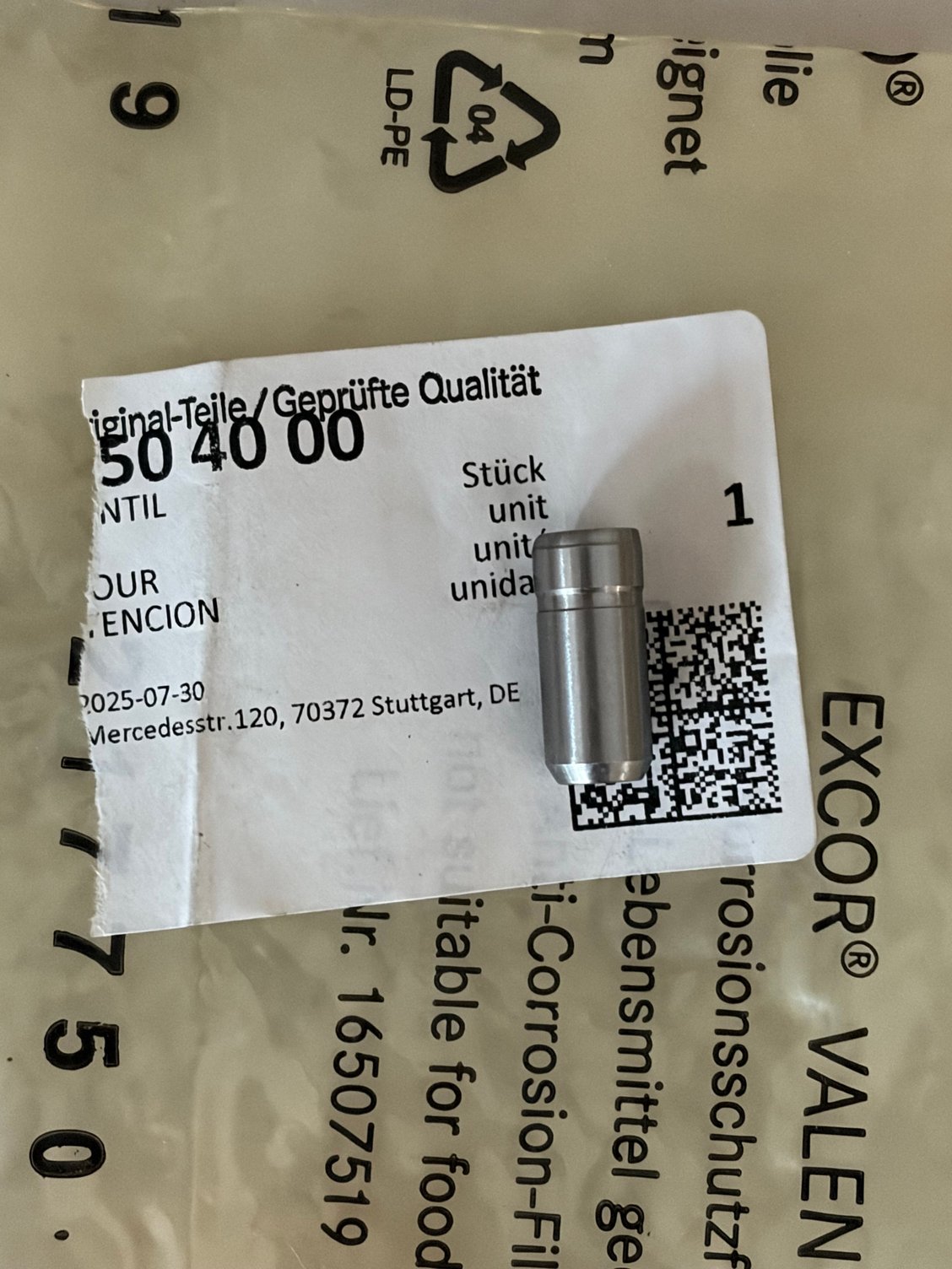

this is the valve that I have, 2780504000. It is identical to the one in the video and that you posted.
really appreciate your insight
gotcha, was hard to tell from the initial pic…

I got it in! Just took some persuading with a rubber mallet to start it.
there you go. No more rattling on that side.

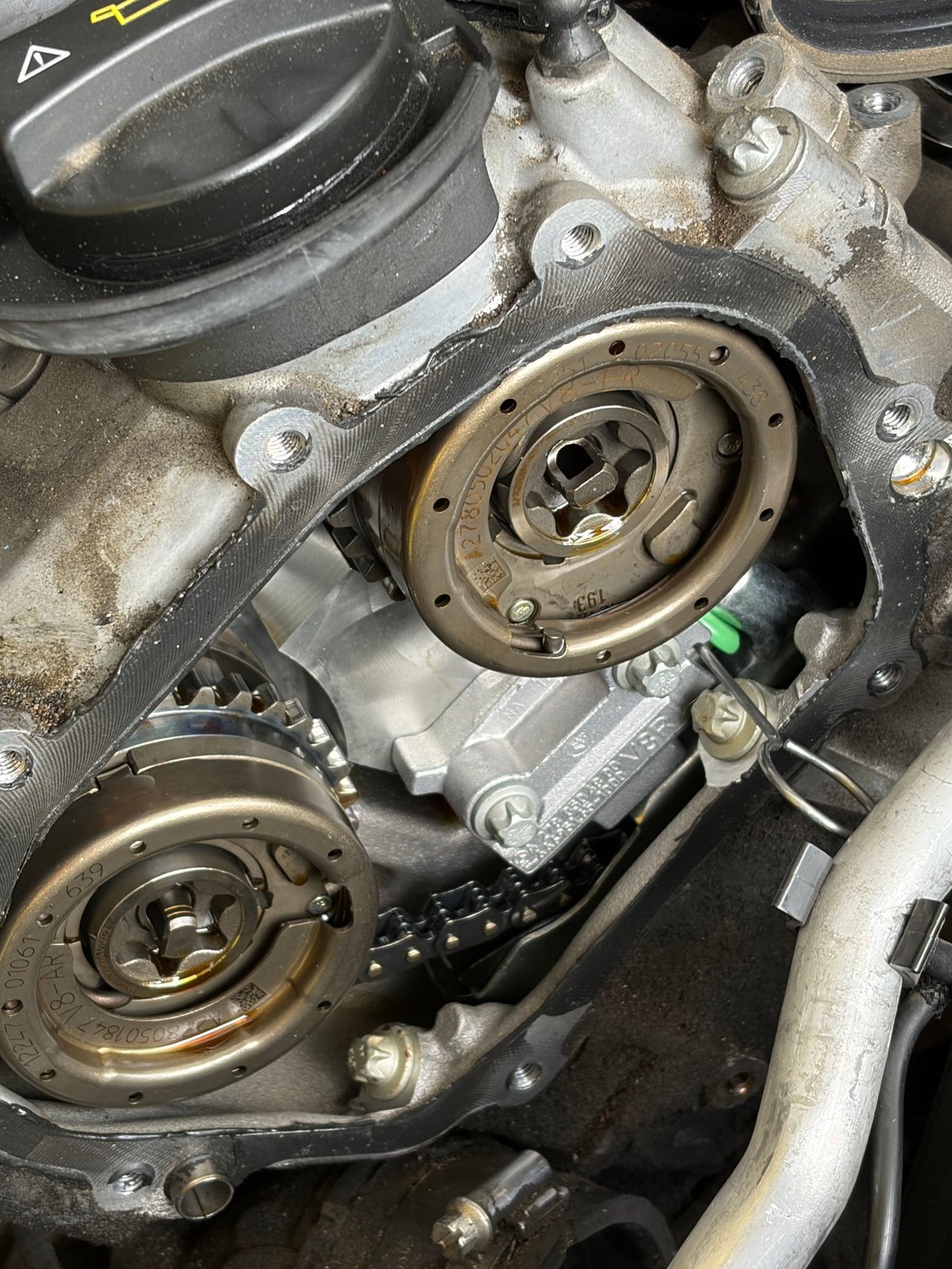

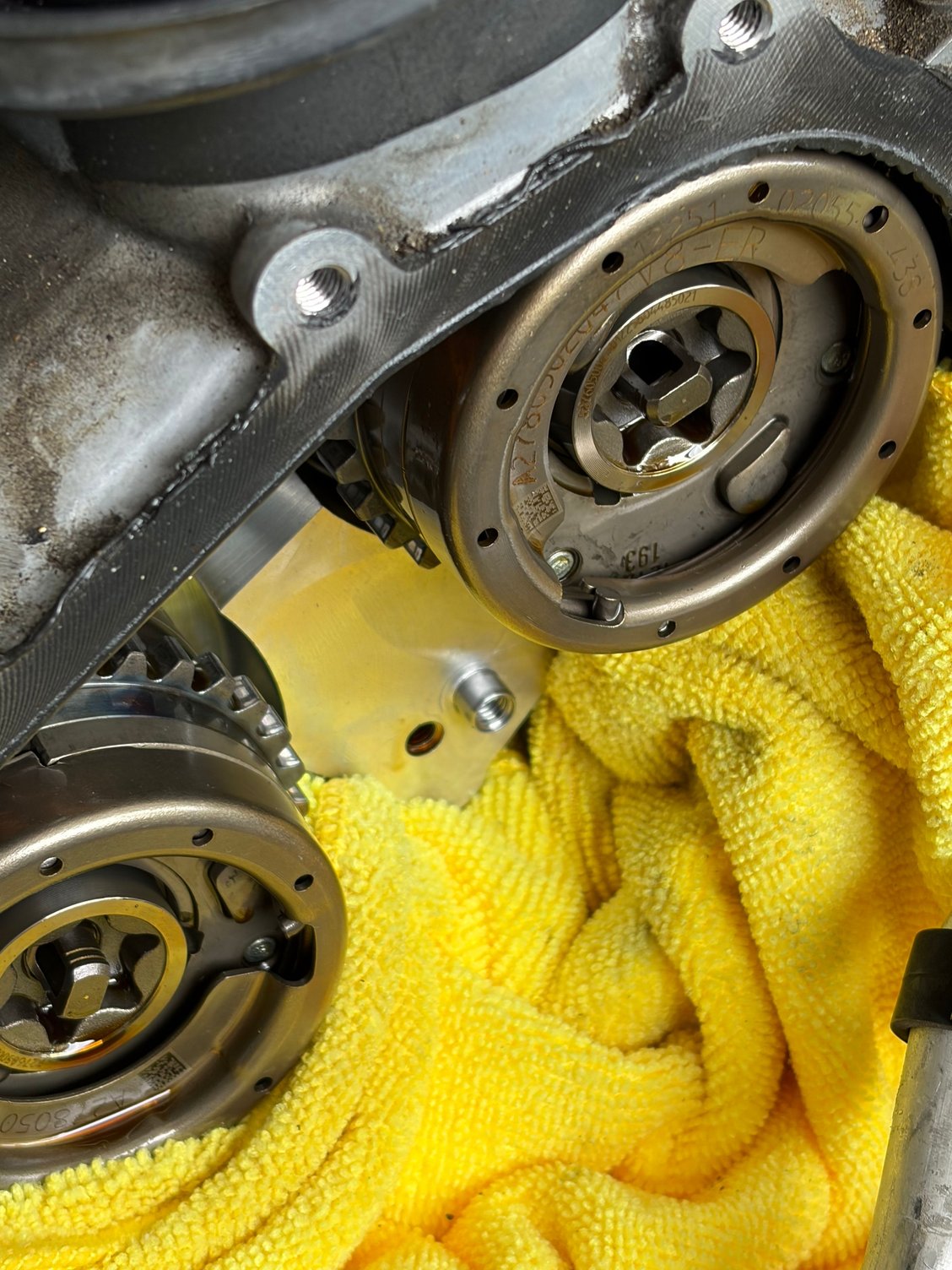

No more rattling at cold start for me - luckily I was able to sneak the driver side cam cover off without removing the oil filter housing also. Made it a much simpler job. The driver side check valve slid in with ease, don't know why the passenger side gave me so much trouble. But all worth it in the end, I can't tell if it's placebo but the motor feels much stronger at pick up. No cover leaks or magnet leaks either now. This is on a '13 SL550 with an M278, but has the oil cooler lines in a similar fashion to the M157.

Pretty great you didn’t have to remove the oil filter to remove that side. Was there no dowel pin in the bottom right corner when looking at the engine from the front?
Glad it all worked out for you.

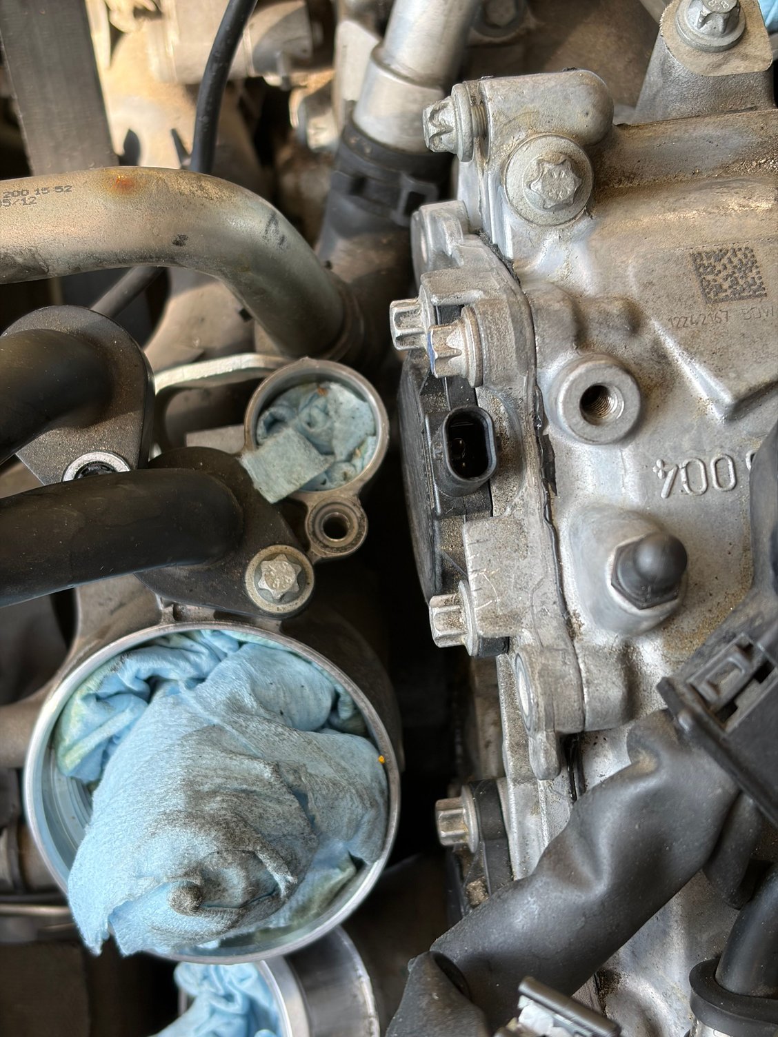

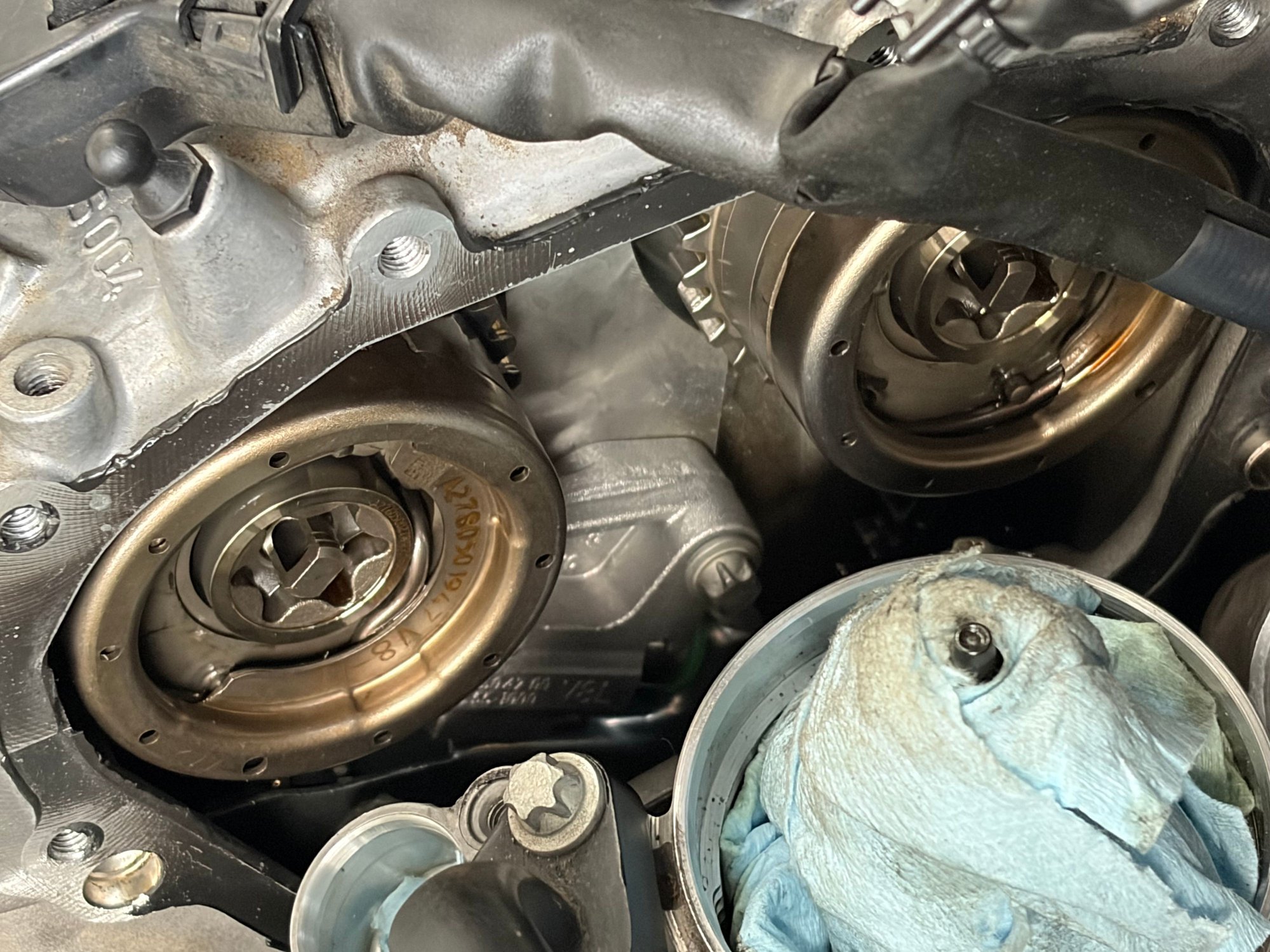

All the dowel pins were in place, I had to remove the cam magnet that was between the cover and the oil filter for it to be able to clear. It was incredibly tight, but I found just the right angle and it popped out. I was very, very close to removing the oil filter housing but very happy to have avoided that whole ordeal.
I explained that this was possible previously in another post and was called a flat out liar.
I truthfully have been considering creating an only fans account to put a video of how to do it behind a paywall.
lol, nobody called you a liar. I mentioned in the M157 engine with the dowel pin the engine side or cover would get the cover stuck between the pin and the turbo and that’s why oil filter has to come off. or that the magnet coming out is doable but tight but going in is a little bit shady but I’d not grind the housing.. This is not that engine…. This makes me wonder if the neck of the turbo is different or clocked slightly different here.
