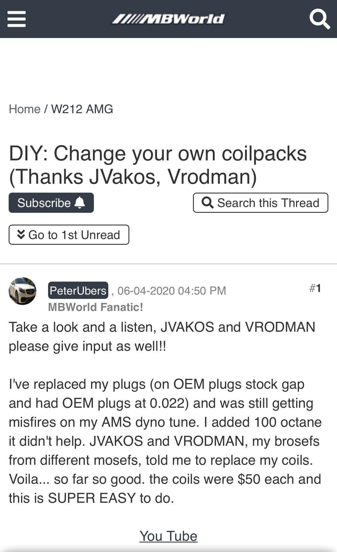

Old Oct 1, 2021 | 12:19 PM
PeterUbers's Avatar
Joined: Jun 2004
Posts: 13,799
Likes: 3,229
Originally Posted by FireBall
Thanks to PeterUbers, Mojo20032004, kponti and Savage212 for the responses and info, very much appreciated.
I just removed the engine cover and air cleaner boxes to access the job of replacing the plugs and coils. The mechanical work needed is beyond my knowledge and ability.
I predict a costly repair bill in my future...
$400 + $200 for plugs and coils and install from a good Indy who knows how to index plugs
Old Oct 1, 2021 | 12:20 PM
PeterUbers's Avatar
Joined: Jun 2004
Posts: 13,799
Likes: 3,229
https://mbworld.org/forums/w212-amg/...s-vrodman.html
