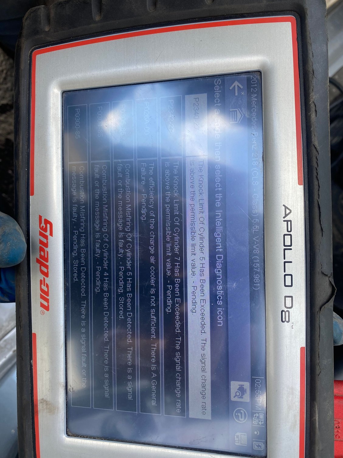

Went to my mechanic and he scanned this. Searching around seems like knocking issue is from WIT on low gas with tune. Which I was doing wot at just under 1/4 gas. But now it says only 4 and 5 are misfiring? 4 has never misfires before. Mechanic is also not to sure as to what the problem is. Any help N additional info would be great. Will change out ignition coils tdy tho.

How many miles are on the car?
It may be a good idea to change the coils if the plugs are new and in good shape. But I think you should stop driving the car until you can at least get back onto the stock tune.
#5 is the right driver side cylinder closest to the front of the car and next to the turbo's so that coil along with #1 cylinder (passenger side front cylinder) get excessive heat from the turbo which accelerates the degradation of the coil when tuned and pushing higher boost at WOT. I would definitely replace your 1-2 coils and 5-6 coils (basically your front most 2 coils on each side) with new coils which are cheap and about $45 bucks at FCP euro and are Beru OEM. see if that fixes the issue
