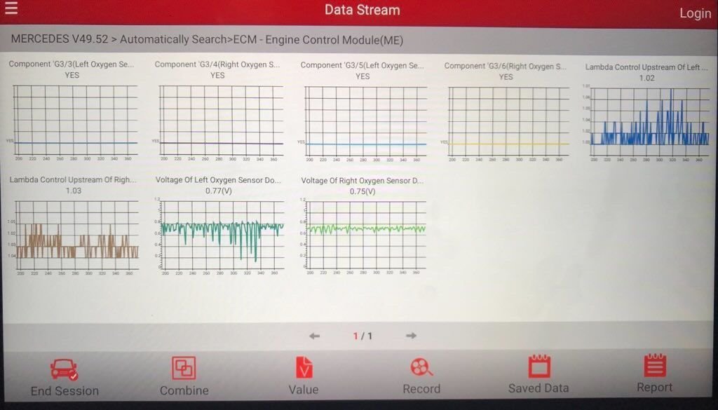

A year or so ago I troubleshot an issue with one of my O2 sensors. The most notable thing about my troubleshooting was that the failed sensor had big voltage spikes as seen on your left O2 sensor. It should be more steady waves like the voltage on the right sensor. After replacing my faulty sensor, both looked almost identical on the live graph.

Only the upstream sensors read Lambda. The oxygen sensors are downstream and report voltage.
What were the running conditions during the screenshot data? Idle? Was the engine fully warm?

The car was idle and warm up to reach driving temperature. The lambdas readinds were winthin normal range. The same reading for downstream sensor.

The error code has gone right after I posted the photos of lampda reading.
