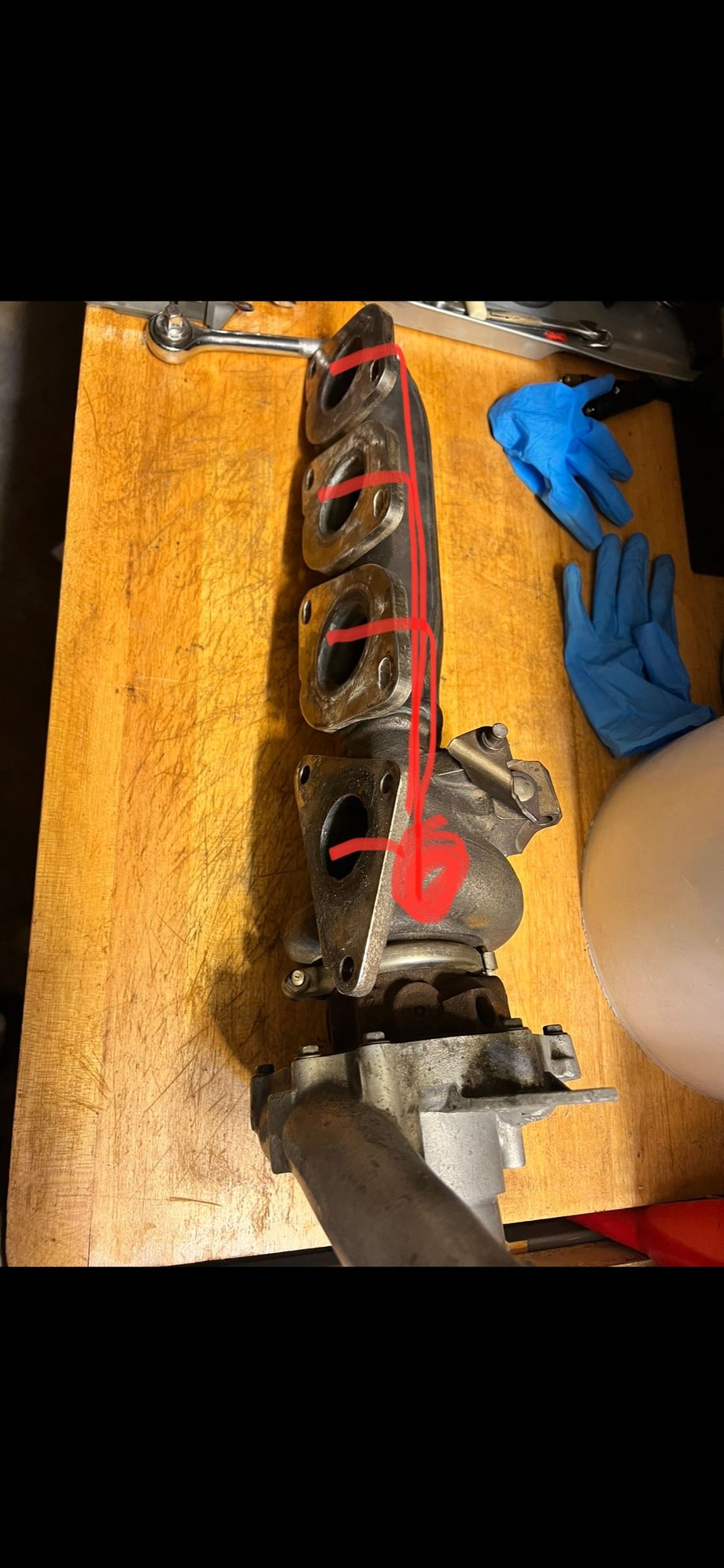

Below are some pics i had from my phone from recent or some older to give some ideas.
Here i outlined in RED the specific issue we have with our exhaust manifold for the M157,the path of exhaust and where it the back pressure builds up by the outlet of cyl 5.

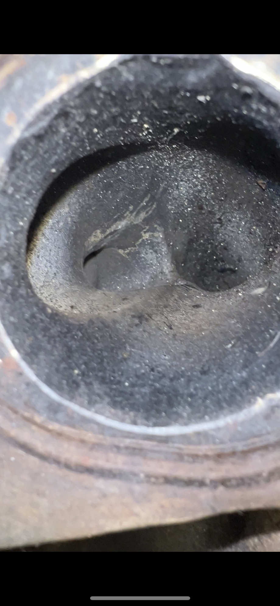

This is a picture of looking into the exhaust port on the turbo manifold for cyl 5. Left is from incoming port of exhaust coming from cyl/ 6-7-8, next to it on the left is the wastegate port, and to the right is the port to the turbine.
Here you can see the massive crack in the exhaust turbine housing.

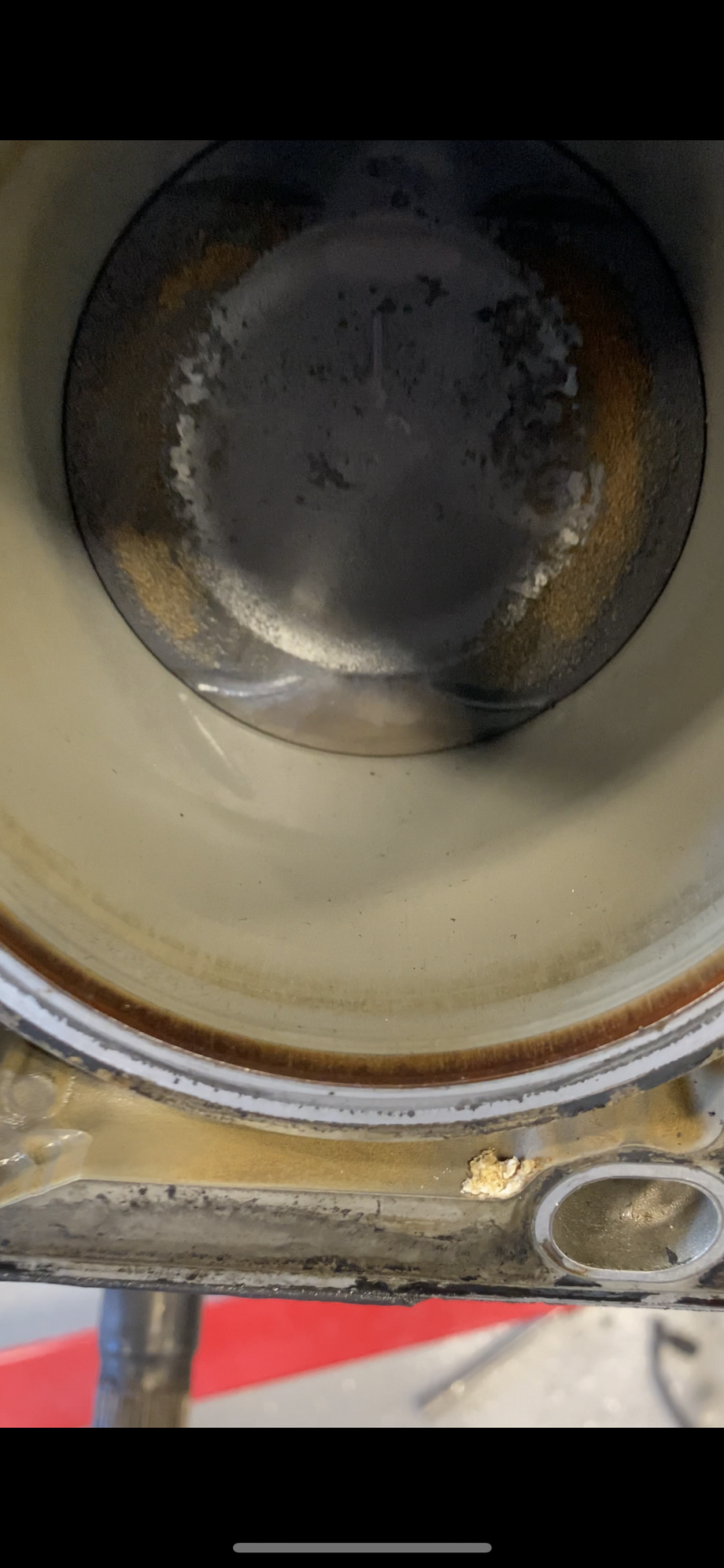

This is a motor with over 110K+ miles, that did eventually end up failing from the cyl wall actually chipping away and coolant rushing in, just a product of physically limits and fatigue. For a high mile motor that was pushed very hard on a very aggressive tune, the cyl walls looked absolutely amazing.

@5soko great info. And yes I can attest to what your saying being that the engine in the pictures have a personal relationship with me 😂. I'd like to point out the fact that this motor did not blow. This motor failed from hardware limitations. And for people not to be afraid it's gonna blow and not drive. Follow the steps of those that went through the struggle. I took every step possible and knowledge acquired though out the years to build a strong consistent motor, from running thicker weights @ 5w-50 to running methanol and removing as much back pressure from the exhaust as possible and using race gas only, every time I added my race gas tune. Keeping heat down to a minimum running more consistent. Making sure intake temps at peak would stay under 125 degrees at redline. Unfortunately there's nothing I could do when hardware limits are met .like a bent rod from to much tq. This is not chalked up to blown a motor . That relates to someone pushing a tune to unsafe territory having misfires, and timing being pulled from poor octane and having high cylinder pressure. Maxing out injectors or pushing and e85 tune to where it breaks up while doing 130mph plus and runs lean. Now that's blowing a motor. That motor ran consistent, clean, ran hundreds of passes on the street data logging and testing, did over 15 back to back runs @ atco race track and drove home .Unfortunately we now know that 750-800 awd hp using a 17% drivetrain loss which when corrected equates to 950-1000 crank horsepower and over 1000- 1100 ft lbs tq is standing with the physical limits of this motor even if ran with clean. It's a matter of time before a limitation is met wether it's rod or cylinder wall. While some are actually driving around with a slightly bent rod and not even knowing. It's a bit to late for you. I guess my point is we know this engine has Cyl 5 rod issues and with the amount of tq the m157 we also know that an open deck has its cons under high boost and tons of back pressure. Knowing this do what you can to address these issues and you will be able to enjoy your car for years. Avoid maxing out boost and having to much back pressure, do what you can to free up back pressure in your exhaust giving the manifold back pressure some chance to escape a little more, free up intake flow. It's proven how much better intakes free up hp, and even with some of the best intakes I find it's still restricted, bends cause pressure drop for every bend your turbo has to over come the harder it's gonna work, the harder it has to work to reach a set boost pressure then that means more back pressure in your exhaust. Another over looked bolt on. Blow off. Get a blow off. This extra spike in boost during shifts need to go somewhere . It goes through your exhaust during a wasted spark design, which means if your tuned pushing 33 psi of absolute manifold pressure that's 35-36 psi spikes needing to go somewhere, this adds to your back pressure even more, stressing out turbos on an already stressful state. So blow off will absolutely help. Everything adds up to something. I can say although not as much as overseas but lately seems like more rods have been failing, and some of these tuners are not even using high boost, they are using timing. And seeing the rods bend still shows me that if it's not back pressure and poor setup failure, it's just from so much power and the limit of what the rod can take was met. These are guys doing 6.5 -7.0 60-130 , 10.4-10.6 quarter miles. That's some serious hp out of a stock turbo m157. Upgrade your turbos fellas while
you still have a good engine, remove that back pressure and get the same
power levels with less boost from a more efficient turbo
