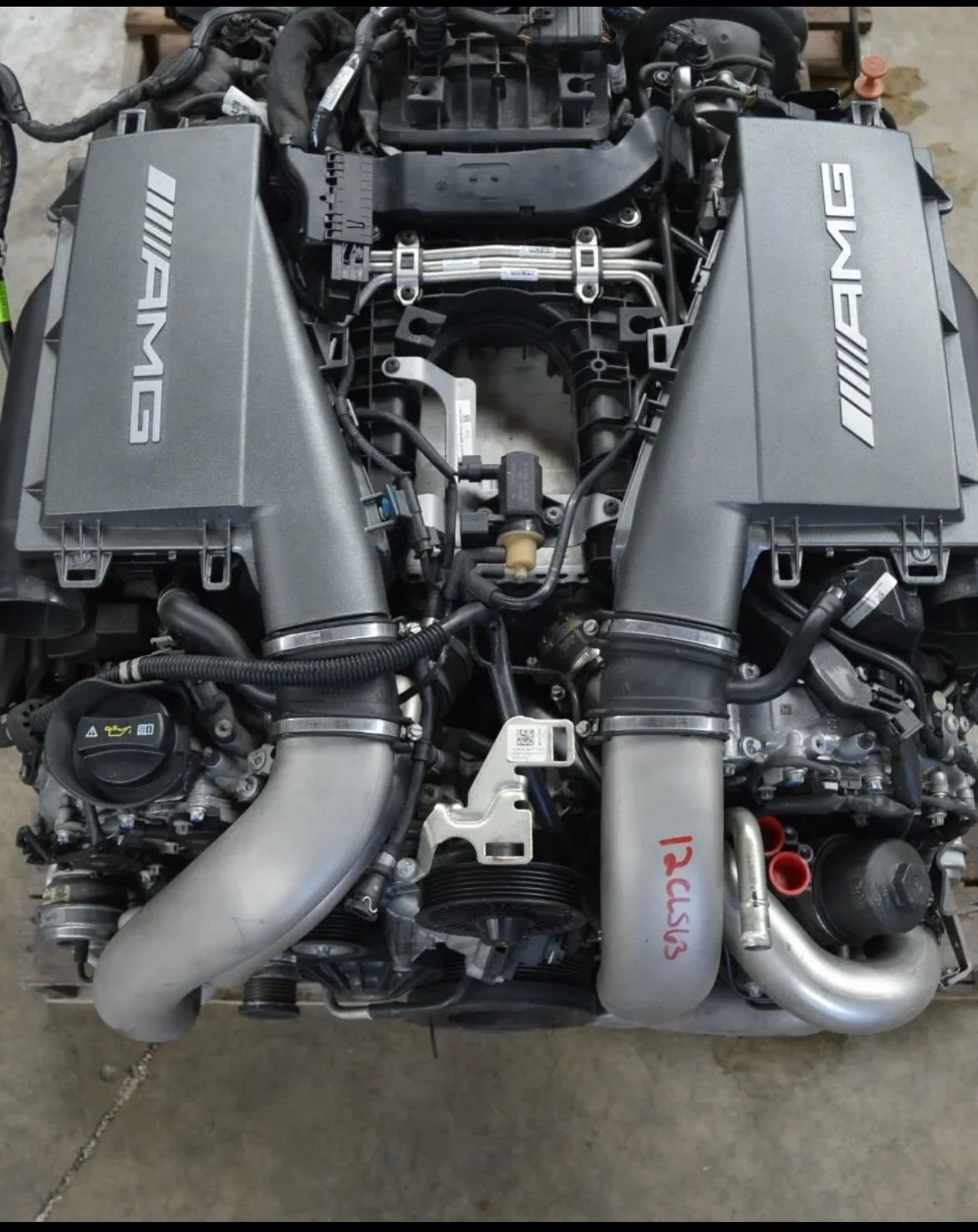

Hey all,
Looking to purchase another m157 vehicle and this looks a bit strange. Does anyone have any input on what could be going on here? Ive never seen that purple before/ is it heat checked?

Interesting, anodized replacement line? Customization attempt? Seems rather uniform for heat checking. Is it a coolant line or an ABC fluid line?

Looks custom ... here's a stock m157

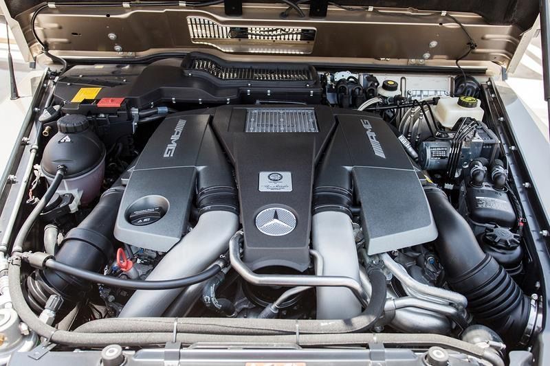

It is in a 2017 GLE63s so I am wondering what it could be. The G-wagon has these other pipes, but you might be right, it could be an ABC thing?

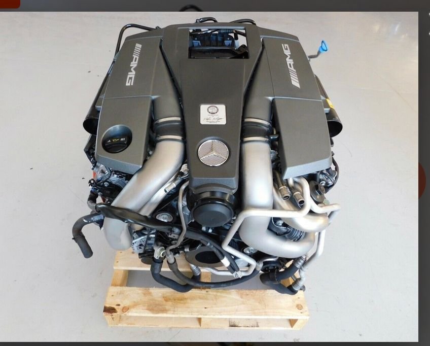

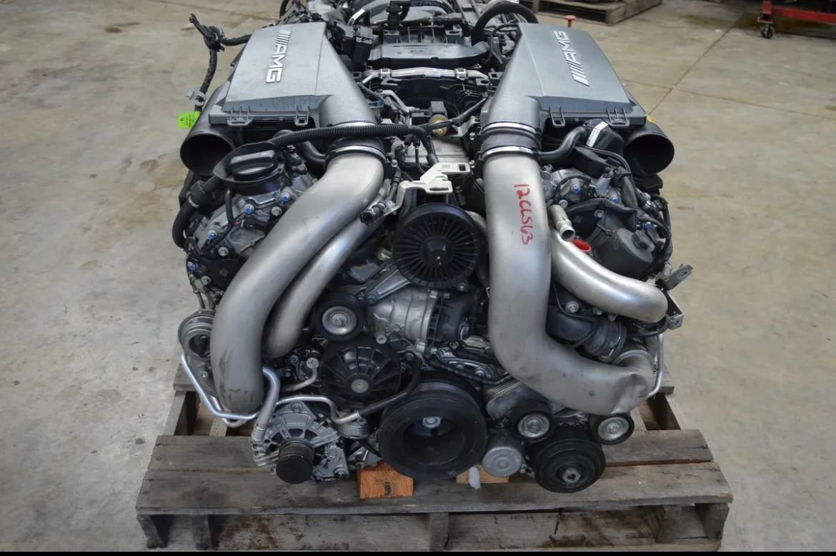

Which amg model are you buying? It's in this one, coolant line?

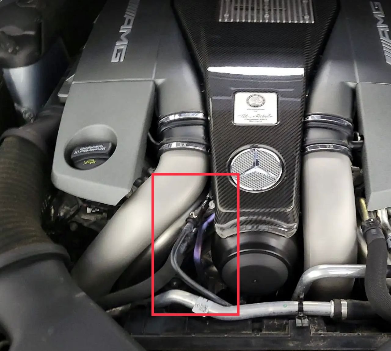

This might paint a clearer picture. Anyone know what this line is?

power steering.

Looks like it might be some sort of overflow? This is the only reason I cannot pull the trigger and buy this.

Could it just be a fluke of the camera shot? A sheen on a black pipe that appears purple ...

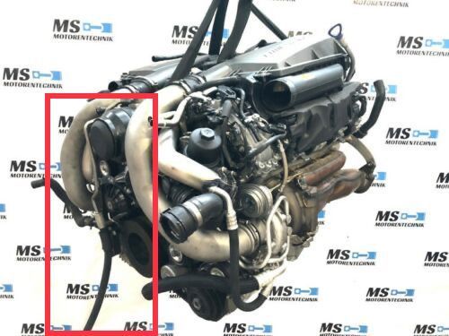

Looks like "Oil High-Pressure Line: pump to separation point" 166-320-1572, part of the ARS hydraulic system for driving stability.
Pulled that info from EPC, here's a random ebay listing with pics of the part: https://www.ebay.com/itm/255887931542
