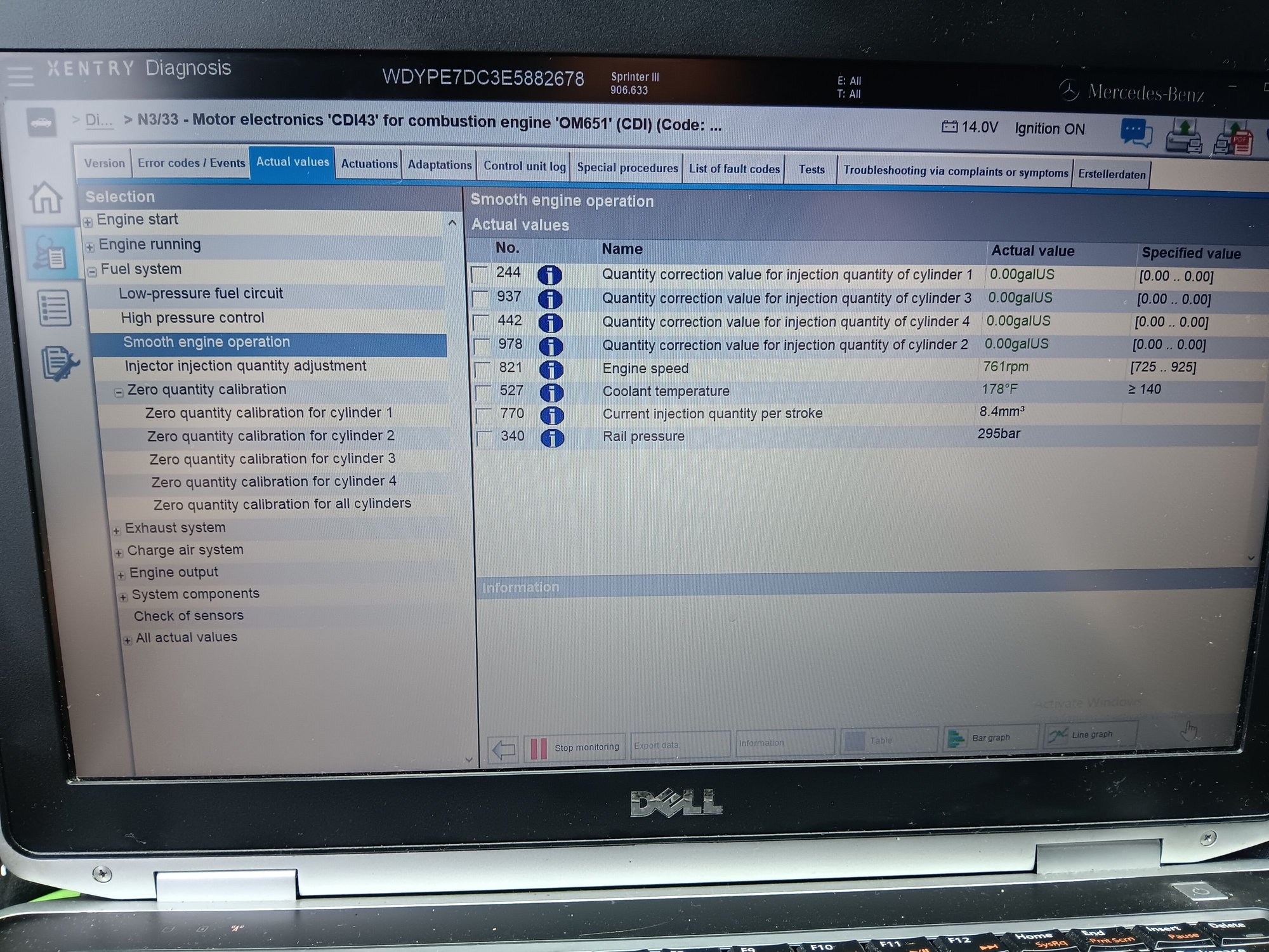

Sprinter
Similar issue on OM651 Sprinter
I think I have a similar isse. To me it doesn't seem like the quantity correction is reading anything.
Does this looked like similar data?
