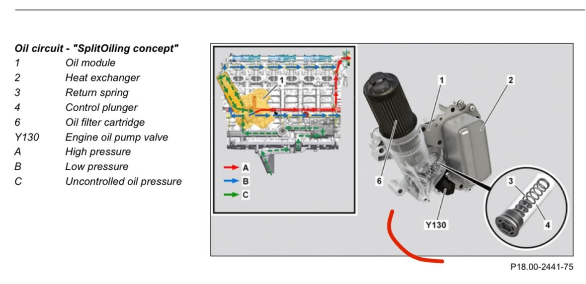

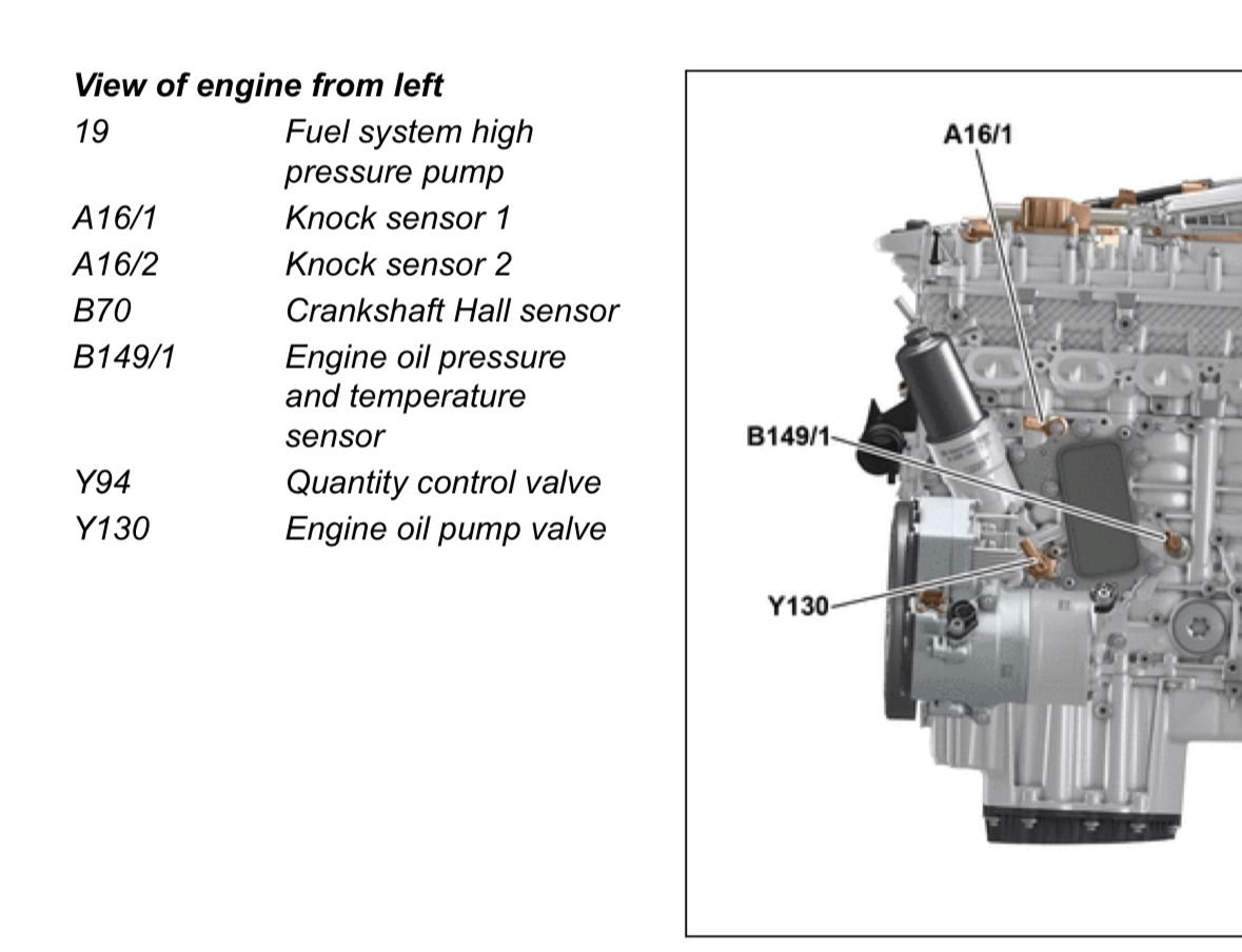

Here is the OM651 engine architectural details. Look for Y131 valve (oil squirter control valve)
https://diysprinter.co.uk/reference/...ion_OM_651.pdf
Thanks for sharing that!
Variable oil pump pressure valve
Variable oil spray nozzle
Variable coolant pump flow
Not sure if im reading this right but it mentions a spray nozzle for the timing chain omitted despite it showing in other charts. Maybe there was two in earlier designs.
Interesting that early OM651s had a 2 channel (oil port) chain tensioner that would constantly fail and wreak havoc with multiple chain failure stories. Later years had a revised tensioner with 4 channel holes and a slightly stiffer spring to provide additional lubrication and better tension. Lost count on the number of revisions. 6 I think?
Wonderful. All to comply with emissions.

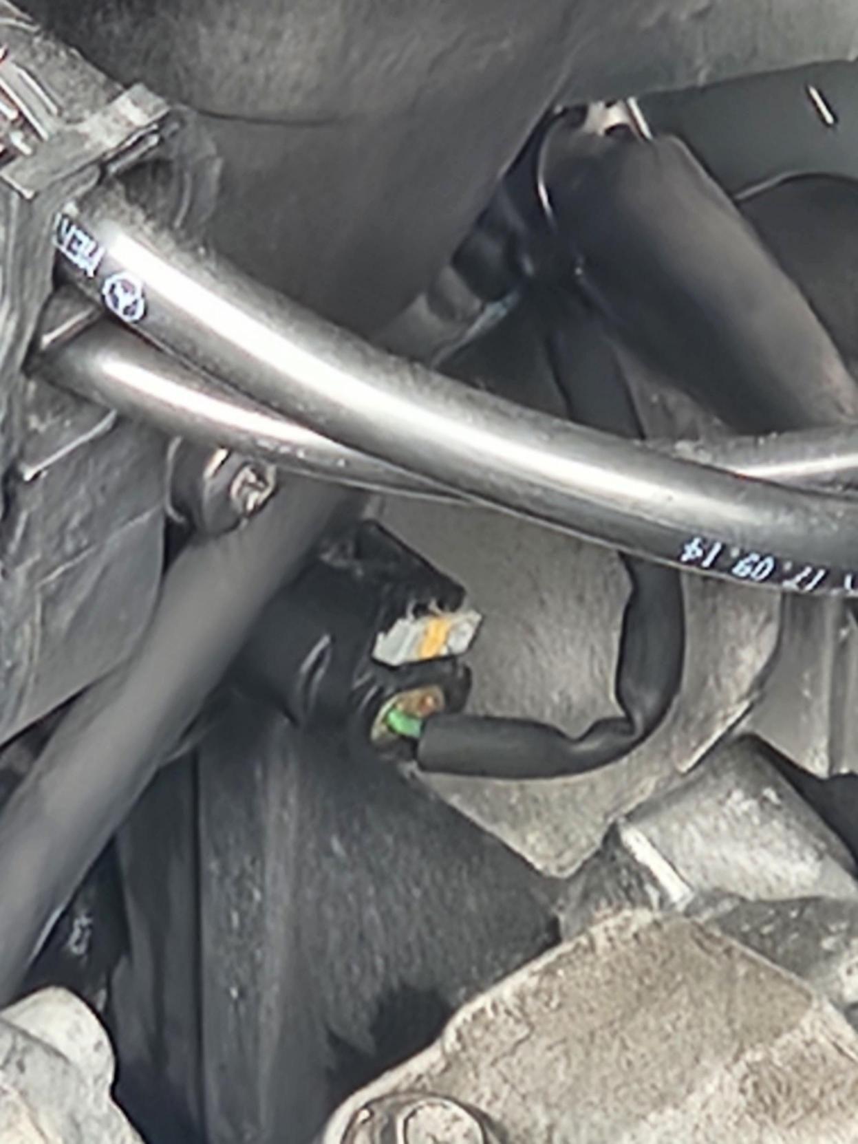

Old Feb 12, 2025 | 03:07 PM
  #2731
Sargy's Avatar
Joined: Feb 2025
Posts: 75
Likes: 41

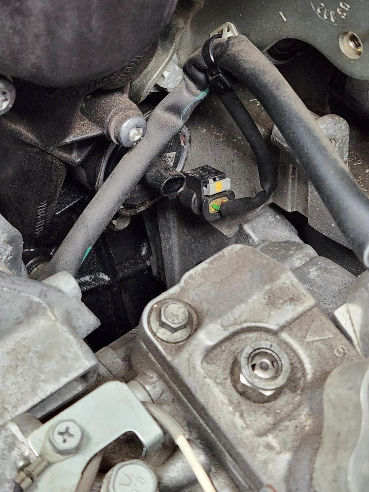

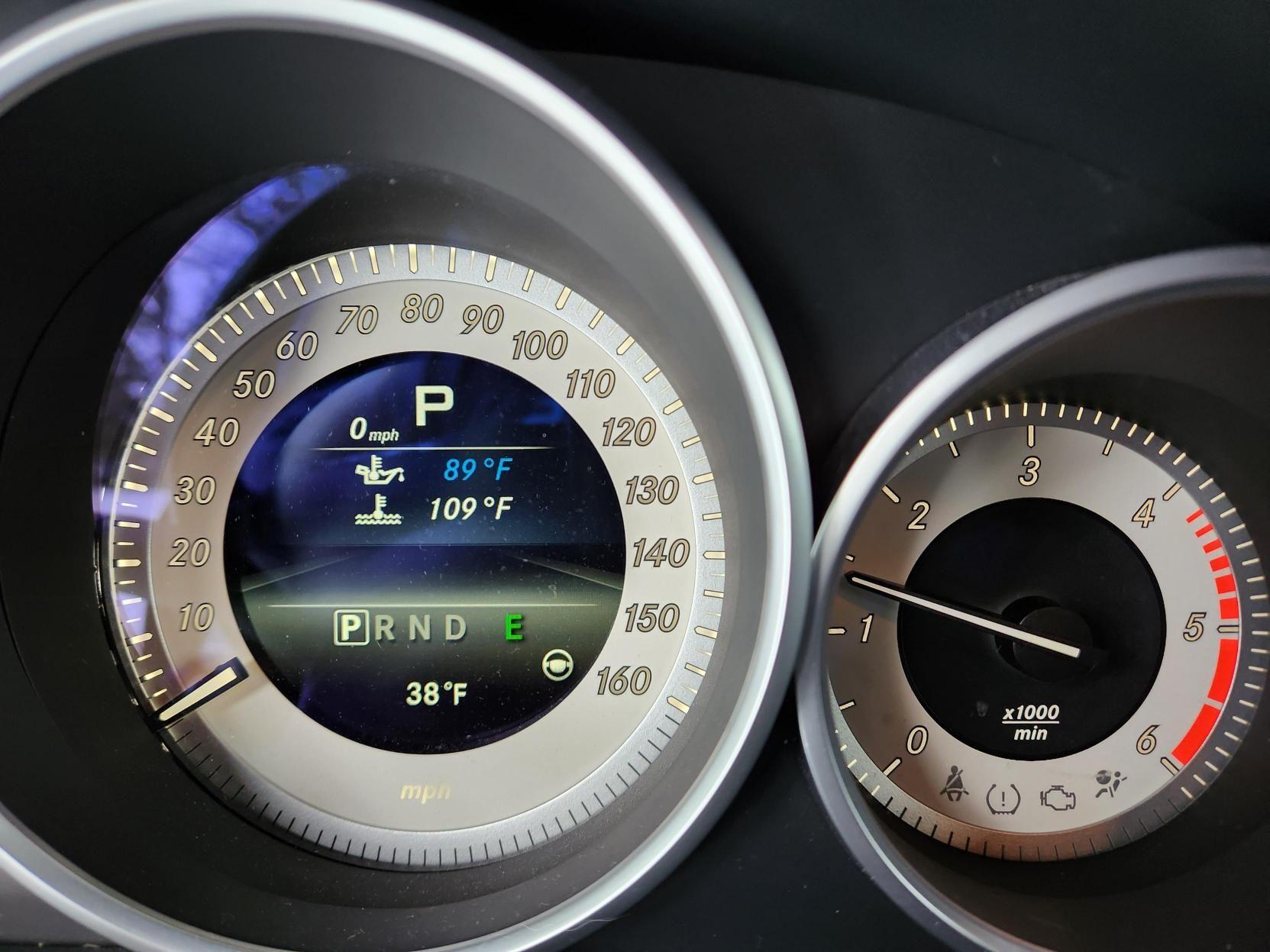

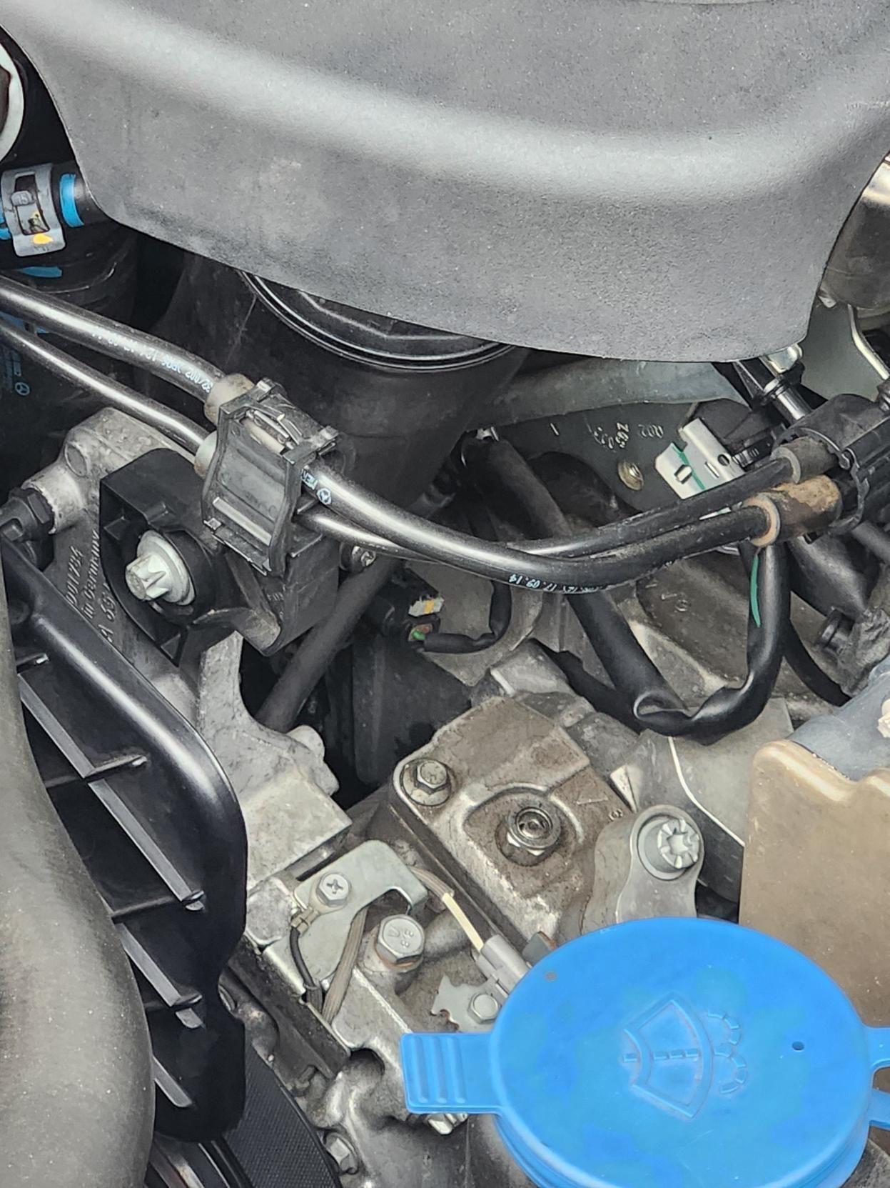

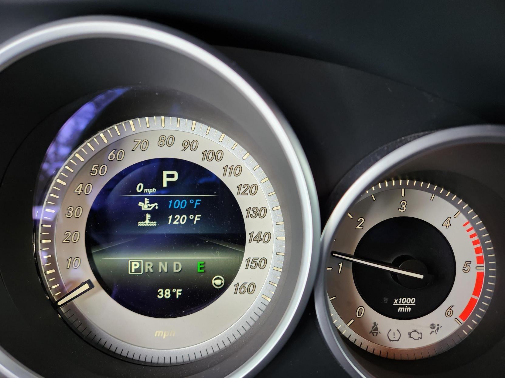

Decided to go out there and be active with all the snow around.
Looks to be a lot easier to reach solenoid #2 than I thought
#2 pistons squirters control valve unplugged!
Temperature delta is now MUCH closer than before just showing a 20F degree difference between oil temp and coolant (parked but revs held at close to 1,500 rpm)
Normally while driving carefully with it plugged in, I could be hitting 160-170F coolant when oil is just crossing 100-120F. Best of all, NO CEL!
I cant wait to drive this thing!
I am going to search MB EPC to see if I can potentially find a similar screw on piece from a 2008 sprinter, etc. If I can't find anything, I guess I will just have to be creative if a CEL is present
A few hours of research showed this to not be the case as the piston cooling jet valve was included in the initial W204 car. The oil pump solenoid was not fitted until later years along with the block off plug for taxi trims
Old Feb 12, 2025 | 03:25 PM
  #2732
W205C43PFL's Avatar
Posts: 32,222
Likes: 6,281
Looks to be a lot easier to reach than I thought
Very nice : ) I guess that is one advantage of having a four cylinder : )

this may NOT be the "pump solenoid" but a misc filter assembly solenoid...
​​​​​​the pump control solenoid is built INSIDE THE ENG OIL PUMP itself. Find your engine pump diagram
Question: i don’t want to be the first sacrifice to figure out how to open my engine to get to it, how do I ask my indy to do this for me?

Originally Posted by exturnul
https://youtube.com/shorts/Tbm3bEP6L...V7um1hb-2JA_96
Hardware is integrated - wtf am I supposed to do?
