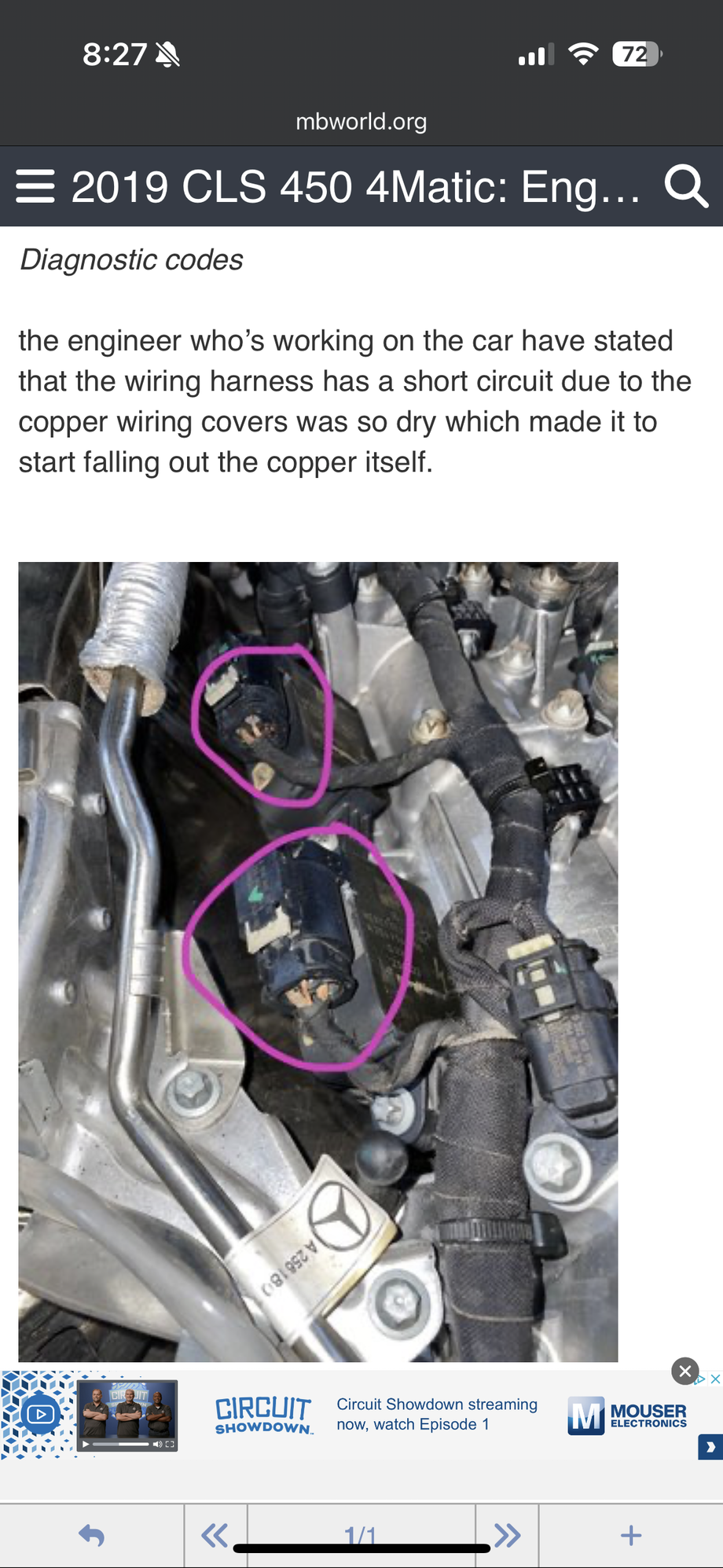

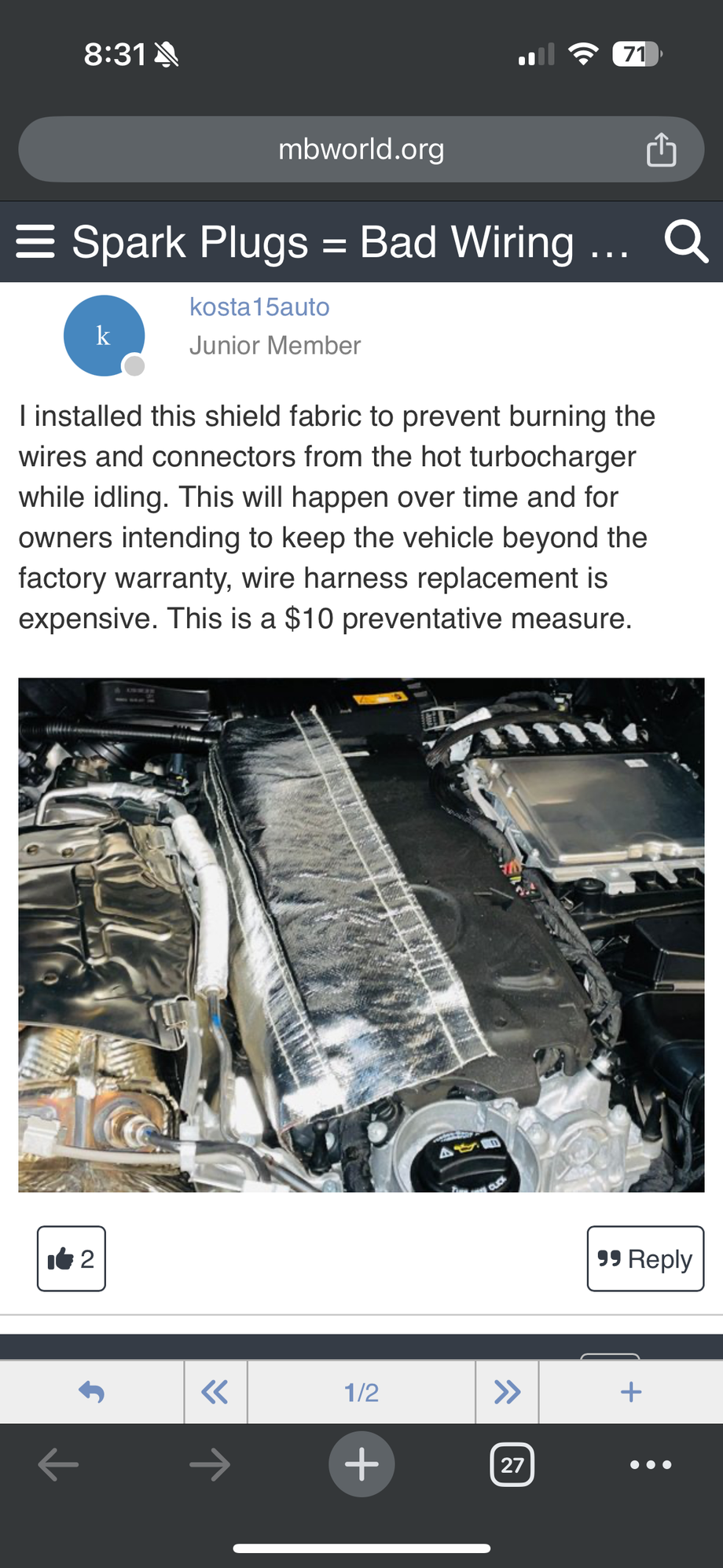

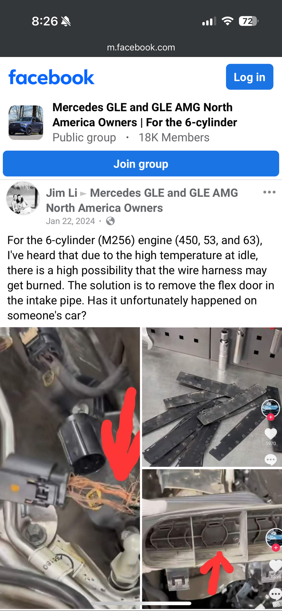

Not the actual engine internals - but the turbocharger reported by many forum users is failing prematurely and I would believe it’s due to insufficient oil circulation while idle, especially after hard use. It won’t heat up but it certainly won’t help to cool down
Plus the heat from said turbo at idle is causing engine harnesses to possibly melt and disintegrate

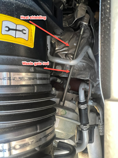

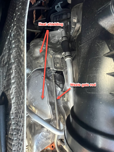

I have NEVER seen that happen from simply idling (or any other condition). Any harnesses should be (and probably are) shielded from turbo heat. And, at idle, oil pressure is still sufficient to keep circulating through the turbos. They are also water cooled (primarily). Next time you come across someone claiming that their wiring harness or other parts were damaged by the turbo at idle, please post a link here.
At idle, the wastegate is open (by default), allowing most exhaust gases to bypass the turbine, so it is spinning minimally and not generating heat. Oil pressure is ~1 bar (15 psi) at 600 rpm.
My comments are based on stock turbos as from the factory. If someone has kludged up their settings with aftermarket "performance" components, then all bets are off.

A lot of GLS owners are getting melted harnesses, some are trying to fix using homemade heat shields - i might join that crowd, and also change viscosity at the same time
It's never a bad idea to add shielding where you can. However, if there is heat damage, regardless if the car is moving or not, a complaint should be filed with Mercedes and the appropriate authorities. However, the vehicles affected may be too new to show a pattern.
My 2004 Audi TT with a K04 turbo (factory stock) has over 250,000 miles and has been chipped for at least 225,000 of those miles. It has heat shielding similar to those pictures from the factory. I still have the factory wiring harness, etc., though insulation has become brittle in some spots. Likely due to being 21 years old.
Throughout that time, the turbo never got hotter by mere idling once started and the car reached normal operating temperatures. If folks find the turbos on their Mercedes get hotter simply from idling, then that is a problem. I know some people have modified their main radiator fan to be always on and not turn off. That may be a "bandaid" fix to keep air circulating in the engine compartment.
oh dear, I have a GLS as well, I should check on that...
Holy cow that is disturbing. Here is the full discussion: https://mbworld.org/forums/gls-class...harness-2.html
From that thread, however, harnesses didn't melt. Seems like the insulation material disintegrated over time -- a very short time. The exposed copper wire corroded. Some comments attributed the quick deterioration to biodegradable materials used to meet some insane European eco-mandate. I'm planning that by the time I need a new car, I will be too old and feeble to drive.
I'm sure extreme heat may contribute to something like that, but I'm not convinced heat is the primary culprit. Owners wrapping they harness with heat resistant fabric may help, but it seems the bigger problem is with the insulating material. It would have to get damned hot in the engine bay to melt harnesses.
On my M276 bi-turbo, there is heat shielding already encompassing the turbos. As you can see, the turbos are not even visible from the top (where the spark plug harness is).
Right side of engine -- Left side of engine
