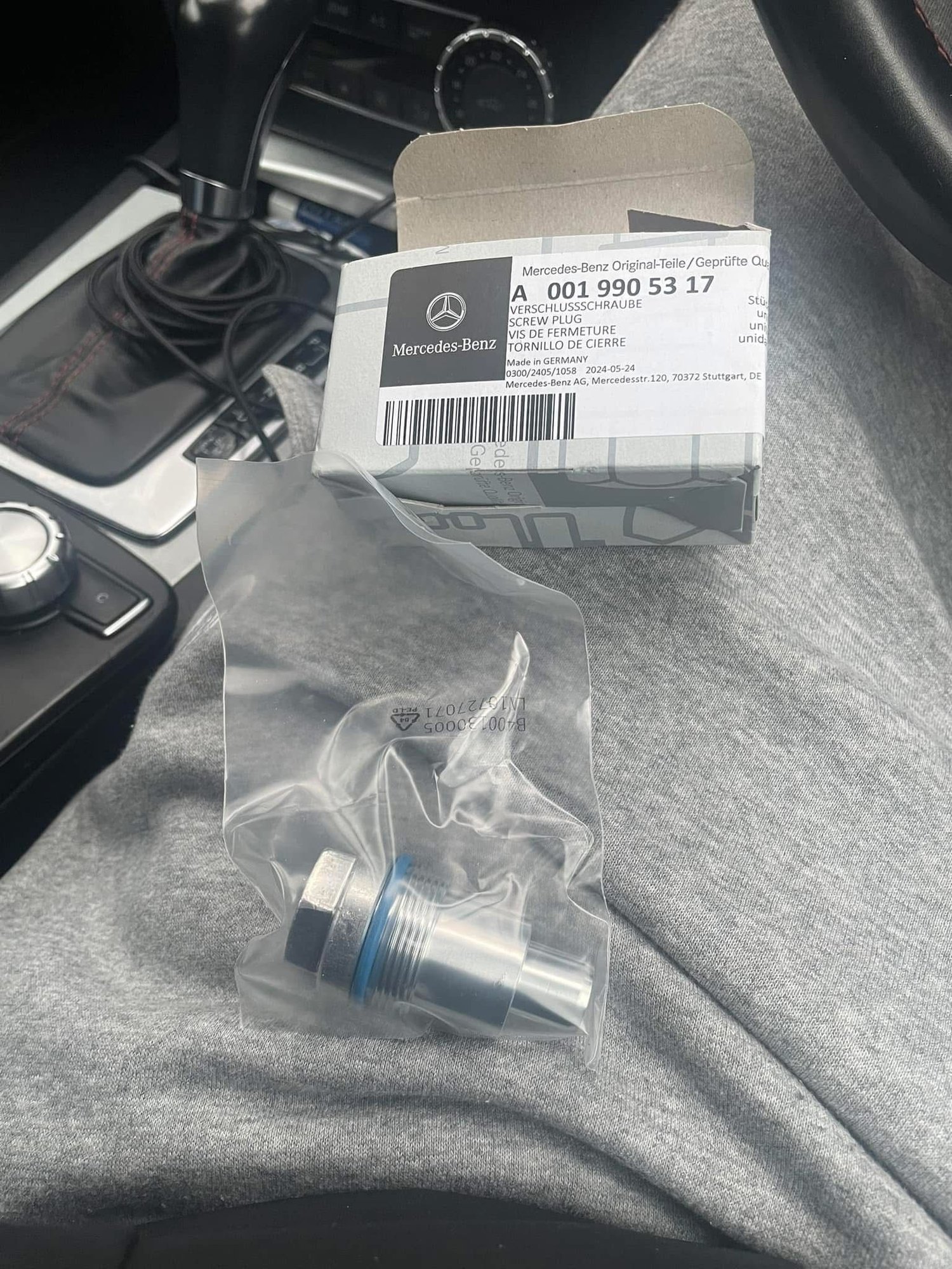

OM651 has 2 solenoids
Originally Posted by dmatre
Interesting to find that for the OM651 (2.1L diesel), Mercedes has issued a blanking plug for the oil solenoid.
Is this the beginning of the end for these blasted things?
First post for me,
Hi guys, long time lurker of many years including the Tasos files. Finally decided to create an account. Local of Virginia and likely not too far from @JettaRed and @Baltistyle (I hope to get an Estate E63 soon!).
Had my solenoid swapped with the above since Sept, '24 on my '15 RWD E250 with 90k miles (140k km). Not too difficult to change, just a lot of patience. Not sure if this gets tricky with 4Matic. While this resolves the issue of switchable oil pressures, it does not resolve the piston cooling jets issue. With the cold weather and driving easy, my oil temps can take as much as 20 min to reach 160F (71C). I have always questioned why this is happening while all the gas folks are reporting fast warm up times with just the oil pump solenoid disconnected. On my 2nd batch of Motul 8100 X-CLEANGen2 5W-40 (API SP, MB 229.52 | VW 511 with low ash-saps for diesels)
At least for the diesels, there is another solenoid specific to activating the cooling jets.
MB's reason: See attached PDF
Fig. 4: Technological Elements, OM 651 Euro 6 and BIN5
Switchable Piston Cooling
The piston-cooling units are actuated via a separate oil duct, which is switched using an electric valve. After a cold start and during warm-up, the heat-up behavior improves markedly due to the deactivation of the piston-cooling units. Owing to the reduced heat dissipation, the critical raw HC and CO emissions drop appreciably in the phase before high conversion rates are achieved by the oxidation catalyst – a phase that is extremely significant in terms of emissions. The exhaust enthalpy is also increased.
Video below. I sent the guy a message for that, But he wanted $400 US
In the meantime once this snow melts I will try to see if I can reach in and disconnect that 2nd solenoid. Hoping for no CEL and a fast warm up afterwards.
File Type: pdf

So this confirm Om651 diesel uses two solenoids:
#1 engine oil pump control.
#2 pistons squirters control.

Originally Posted by Sargy
First post for me,
https://cimg0.ibsrv.net/gimg/www.mbw...d084391c41.png
https://www.youtube.com/watch?v=RSIAbOvRENI
https://cimg5.ibsrv.net/gimg/www.mbw...9b3395de4e.png
Woah! Two solenoids???
Yep. Im getting more reliable pressures at the crank and everywhere else while the pistons are likely getting super heated from that 2nd solenoid haha. Correct me if i'm wrong but are the diesel combustion chambers MUCH hotter vs gas? Especially when the DPF is regenerating. I cant imagine the numbers.
Similar to the gas cars I would read stories of million mile taxi/sprinter OM651s while others blow up under 50k miles because of potentially stuck solenoids with oils lacking flow/pressure at higher rpms. Im definitely after reliability so if pistons can get cooled, what does that mean for everything else in the combustion process....I shall find out!
I also wonder what MPGs I would get with that 2nd solenoid defeated. best was 44mpg with the AEM recall and 50 cetane driving to NC vs some parts of Europe getting well over 60MPGs with less emissions requirements
Glad you unplugged them both : )
