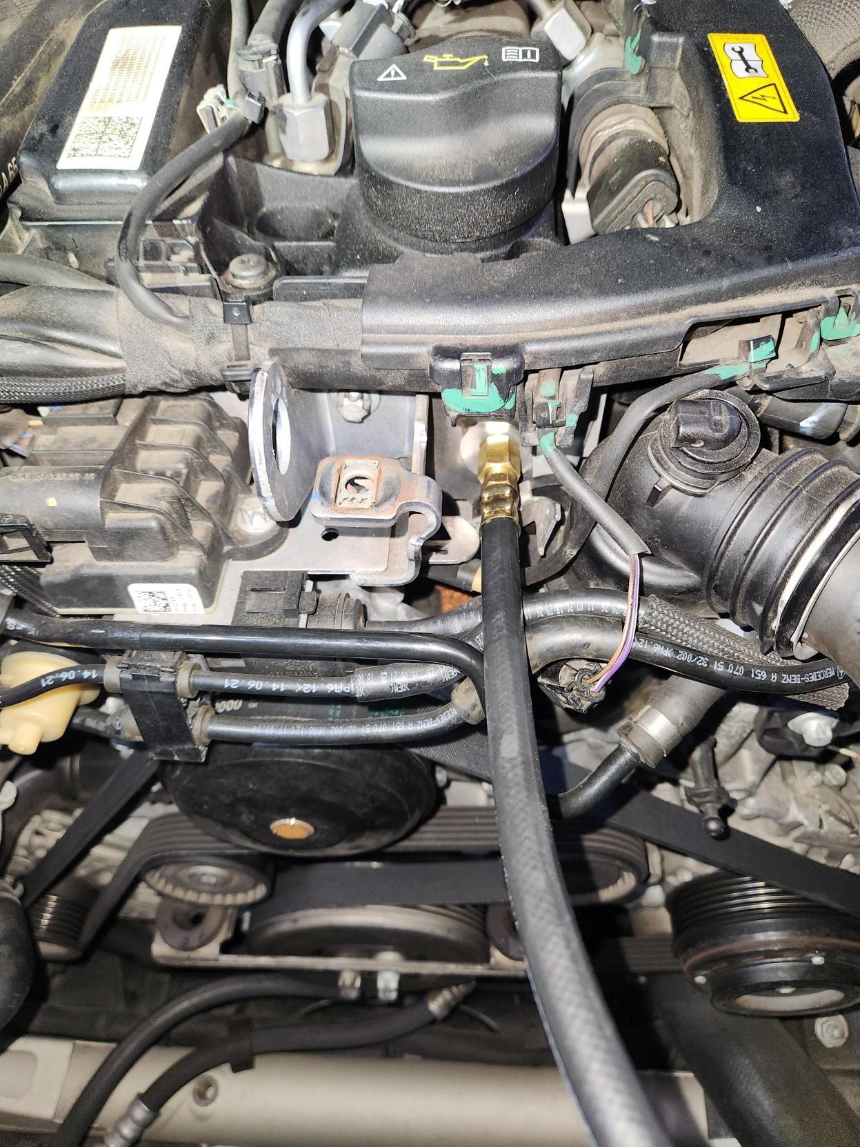

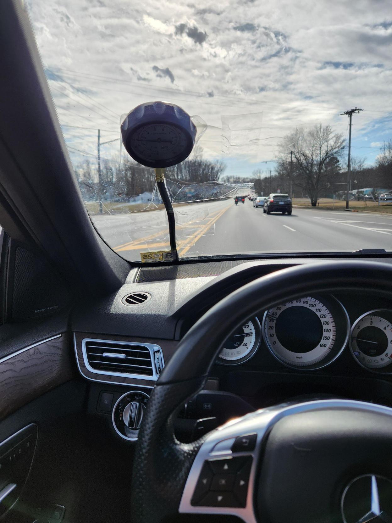

OM651 oil pressure with pump solenoid defeat + piston squirter mechanical valve
Decided to get some numbers
Getting pressure readings was easier than I thought. The port is conveniently located up front on the intake side cylinder head. Best of all, its at the farthest end of the oil pump circuit. NICE!
<-----------------------------------------FRONT-----------------------------------------REAR----------------------------------------------->
----------------------------------Now to warm up and get more numbers--------------------------------------
-Again, ambient temps around 68F / 20C
-Motul 8100 X-CLEAN GEN2 5W-40 (MB: 229.52 / 226.5)
-Oil and coolant temps are now equally matched at 194F / 90C, fully warmed up.
-Piston squirters finally working in sync with variable RPM pressure.
-With piston squirter disabled, oil would reach 185f / 85C at a similar warm idle

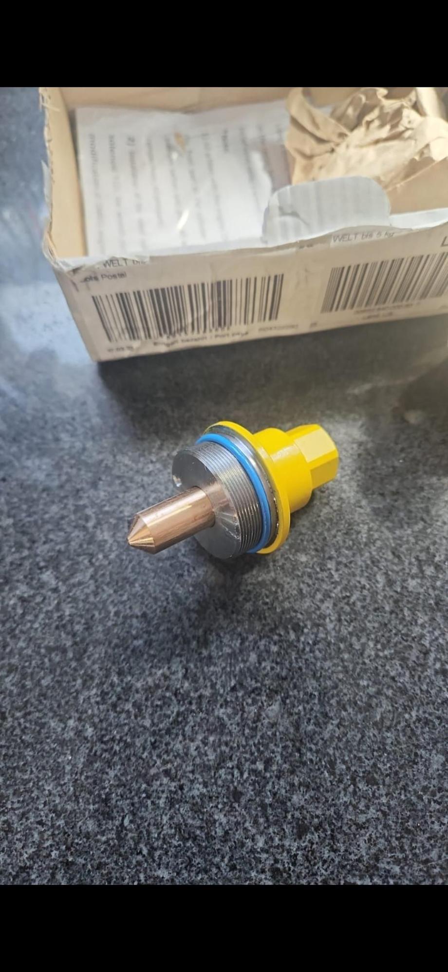

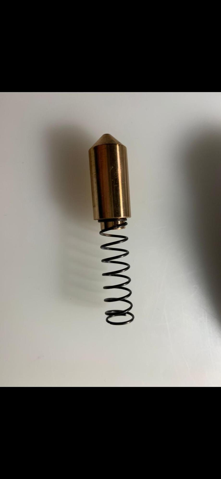

@CaliBenzDriver I cannot confirm if cooling jets have internal ball setup to open at certain RPM. My impression is that they are fully open and controlled via secondary piston cooling solenoid (NOW DELETED!)
A more reliable mechanical / spring valve installed. Controlled with higher RPM pressure while maintaining 1.8BAR at idle
