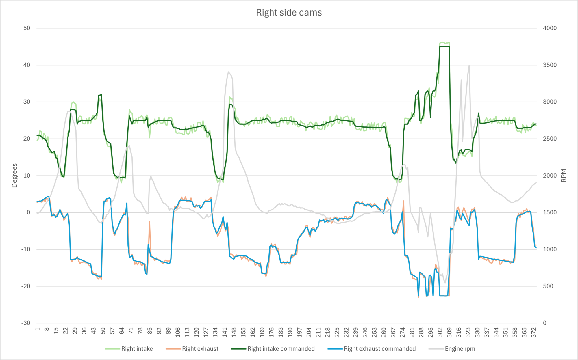

1) When oil pressure reaches 2 bar, the cam adjusters operate and are in control of cam timing by altering the PWM signal to the magnet. This is obviously true because oil pressure varies with RPM so the system would HAVE to be capable of positive control under a range of conditions.
2) No one has received a cam timing code after unplugging, because cam timing is not operating out of spec. The reason we don't see a cam timing code BEFORE unplugging is because of the trouble code diagnostic logic. When oil pressure is too low, the cam adjuster is not operational and they are in the locked condition. Via the cam position sensors, the ECM knows this. I am sure if you raised RPM enough and the cam adjusters were still not responding, the ECM would throw a code but I don't know where the threshold is. I am sure there is plenty of slop to account for engine wear.

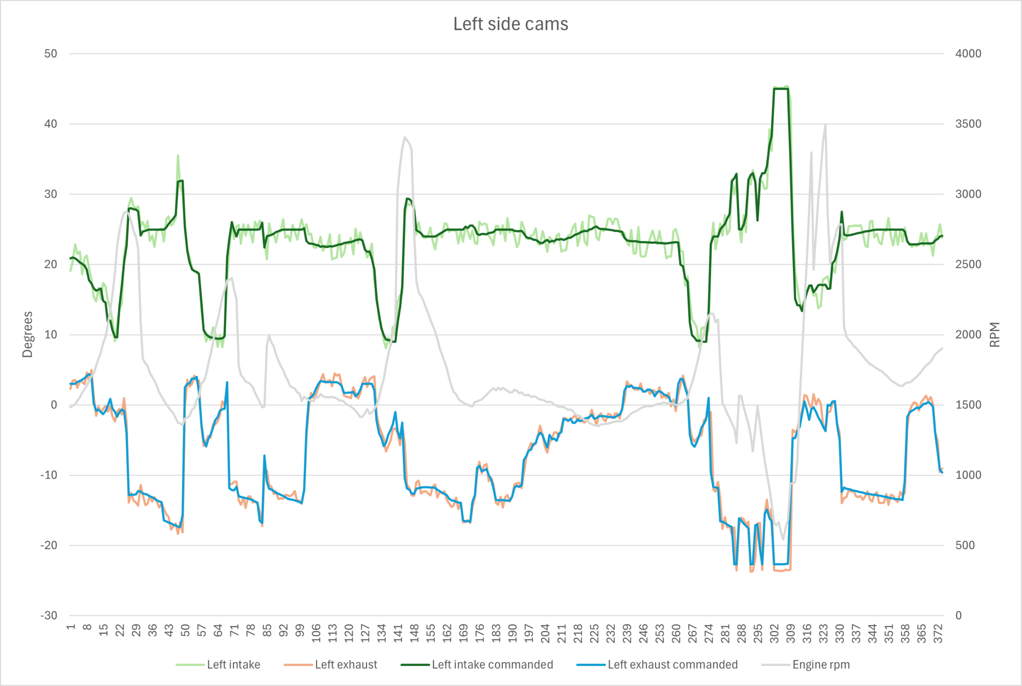

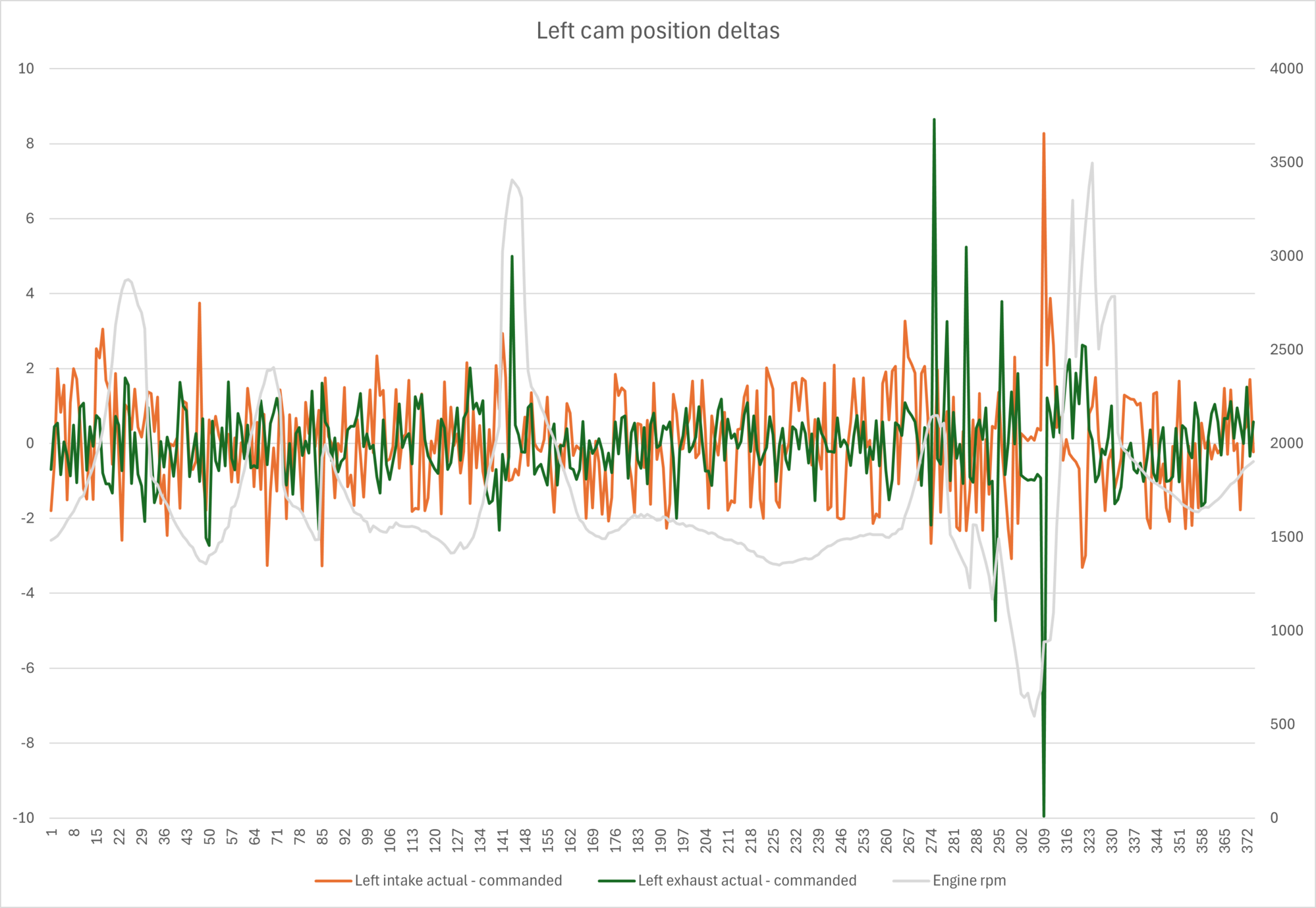

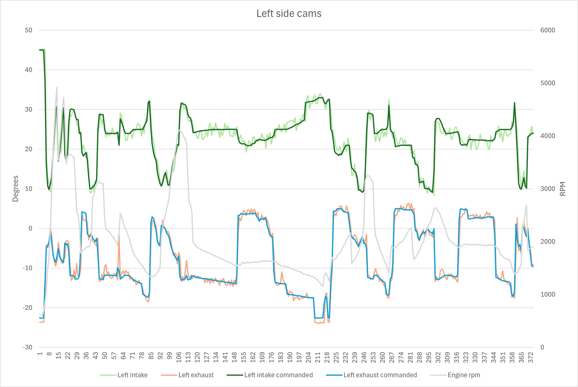

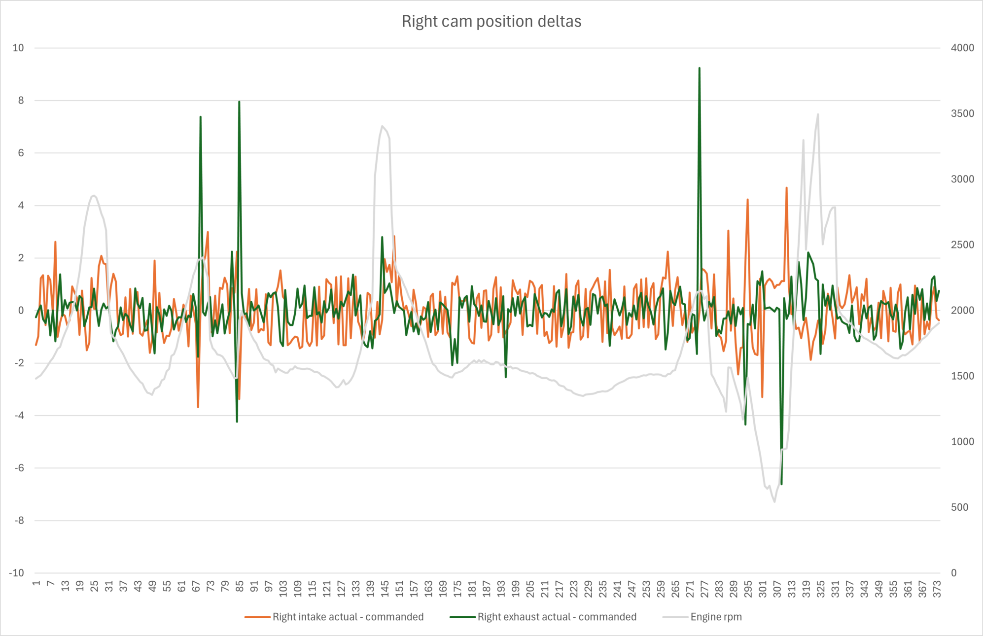

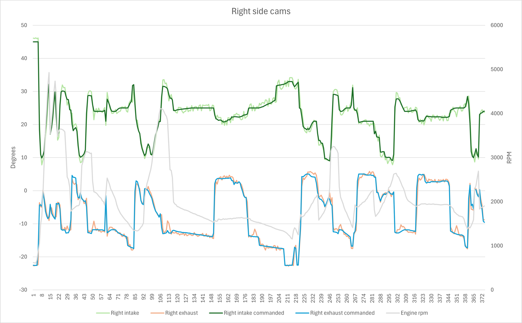

Here are some engine logs of cam timing. I recorded cam timing commanded vs actual and then plotted the delta between the two values to see how good the system is at keeping up with the command under dynamic engine conditions. This was in June 2024 and I unplugged in November 2023, about 9,000 miles ago.
What's my point? That the ECM has GENERAL positive control over cam timing over a range of RPMs (and thus oil pressures). It's not on or off. And back to the point of this thread: with more oil pressure behind the cam adjusters, the system is able to work more effectively, and reach the desired cam timing more responsively AND come out of lock mode at a lower RPM and thus deliver adjusted/calibrated/commanded cam timing that's optimal for performance. This is all there is to the cam adjuster theory.

Let's see how real camshafts actuation works.
First we see all 4x positioning at various timings angles then Kevin reveals the positional errors... that's a nugget!!

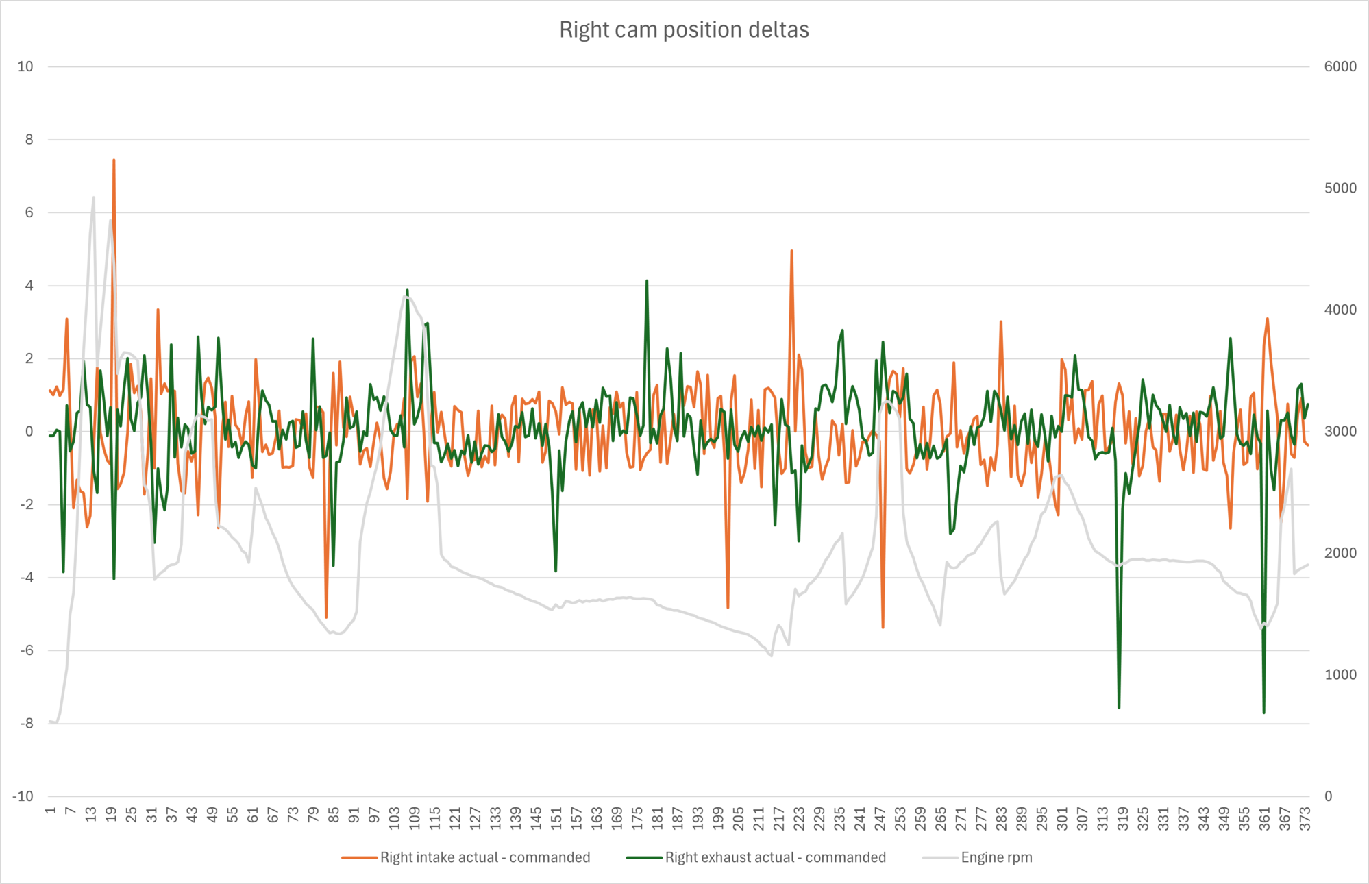

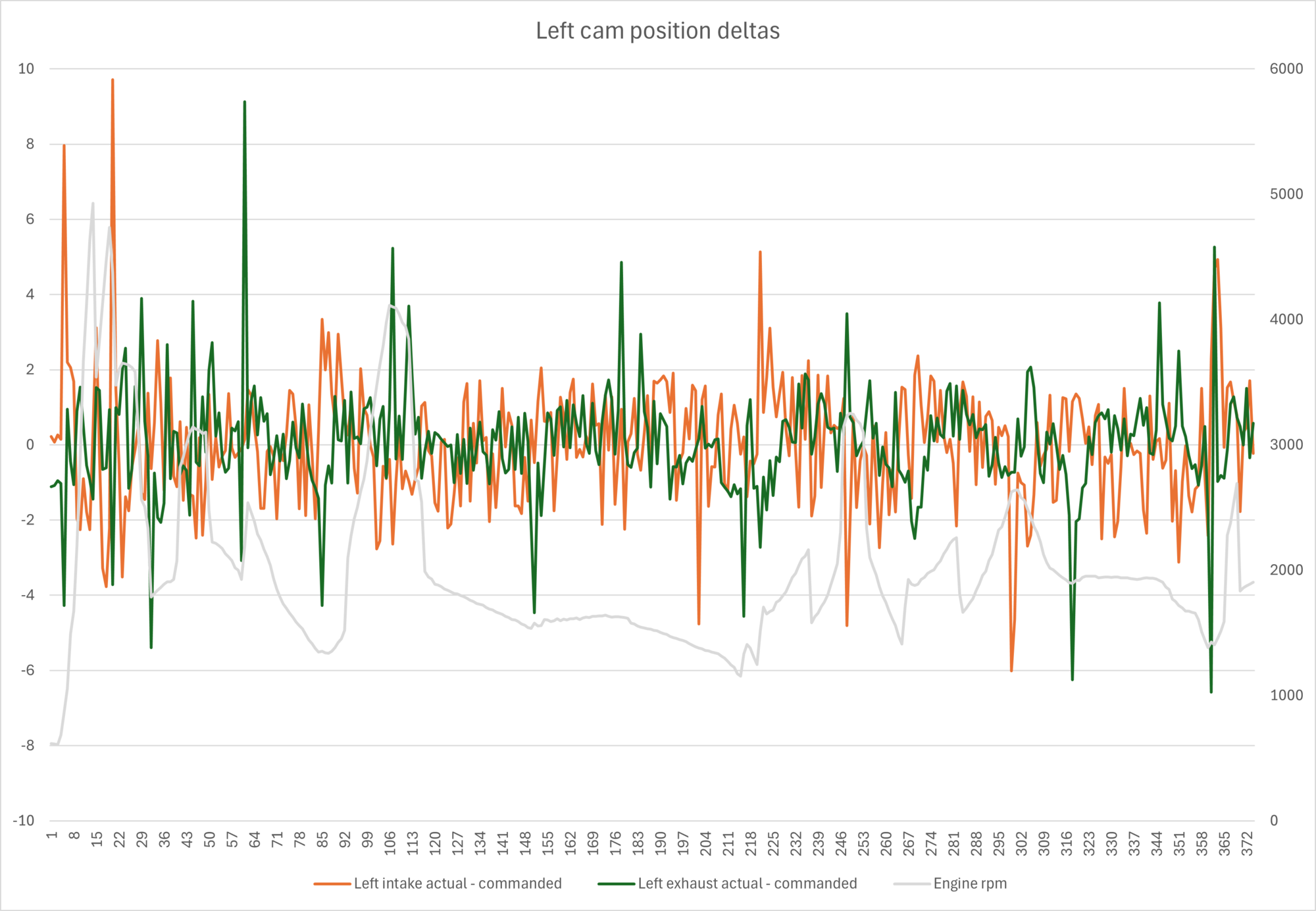

left side bank
left side bank
right side pairs
right side pairs
> The smart section!!
This shows exactly the marginal positioning accuracy that MOD options help.
We can clearly see the delta for all 4x cams under various operations.
The significance of that data is like the misfiring count for combustions.
We've seen these large errors are responsible for detuning more than the camshafts logic.
> The data plots reveal :
  • UN-EVENESS between L/R banks: ouch!
  • small errors: average 2°
  • large errors: up to 10° <<<<

left error rate
left error rate
right error rate
right error rate
Let's look closer...
wide errors... ouch!
The average non-stop error rate is about
then there are wild over-shoots:
Extreme errors
Extreme errors
> What does this do: LEAN/LAGGY throttle!
Erroneous AIR INTAKE control directly corrupts FUEL INJECTION maps. Unstable air yields lean fuel.
These fault charts are computed values because ECU does not know directly where camshafts are located.
Cam positions are computed in relation to the high-resolution crank tics...
The more cams get lost the more ECU need to to re-synch and catch up

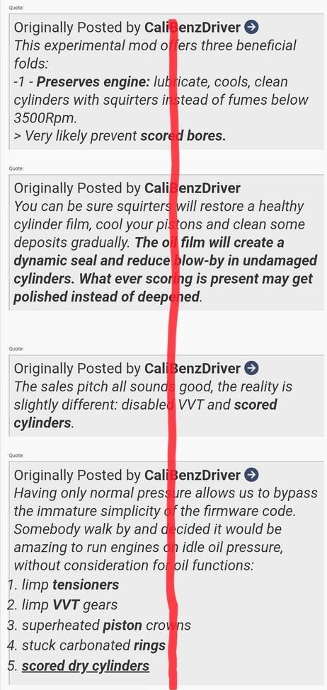

LOL apparently this week, oil squirters DO PREVENT SCORING!
This statement:
https://mbworld.org/forums/w212-amg/...ml#post9221415
Quote: Kind of like the thread has finally accepted the squirters that point to the underside of piston walls AND not THRUST SIDE OF CYLINDER BORES do nothing for lubrication, but rather cool the cylinder charge.
Apparently this statement already acknowledged by Cali, now triggers selective memory.

10/2
https://mbworld.org/forums/w212-amg/...ml#post9219627
Few things are clear:
-- Stock BORE SCORING IS OUT OF SCOPEfrom Solenoid MOD.
-- Topic is NOT about lubing frictions.
-- MOD-1 will unlikely help pistons run any better.
Pretty obvious from the get go.
10/2
https://mbworld.org/forums/w212-amg/...ml#post9219707
Early scope... later refined to EXCLUDE BORE SCORING:
Having only normal pressure allows us to bypass the immature simplicity of the firmware code. Somebody walk by and decided it would be amazing to run engines on idle oil pressure, without consideration for oil functions:
  1. limp tensioners
  2. limp VVT gears
  3. superheated piston crowns
  4. stuck carbonated rings
  5. scored dry cylinders
Honestly you’re in so far over your head here, you can’t even keep track of your own statements. I’m really trying NOT to make you look foolish, you’re actually doing it to yourself.
Your mass posts, now over 700, filled with constant repetitive AI gibberish in an attempt to sound “knowledgeable” are actually counter productive to everyone here. You really aren’t helping your competency or understanding in all this. Nor will you actually LEARN ANYTHING. You’re progressively eroding confidence in the statements you post as seen below.
